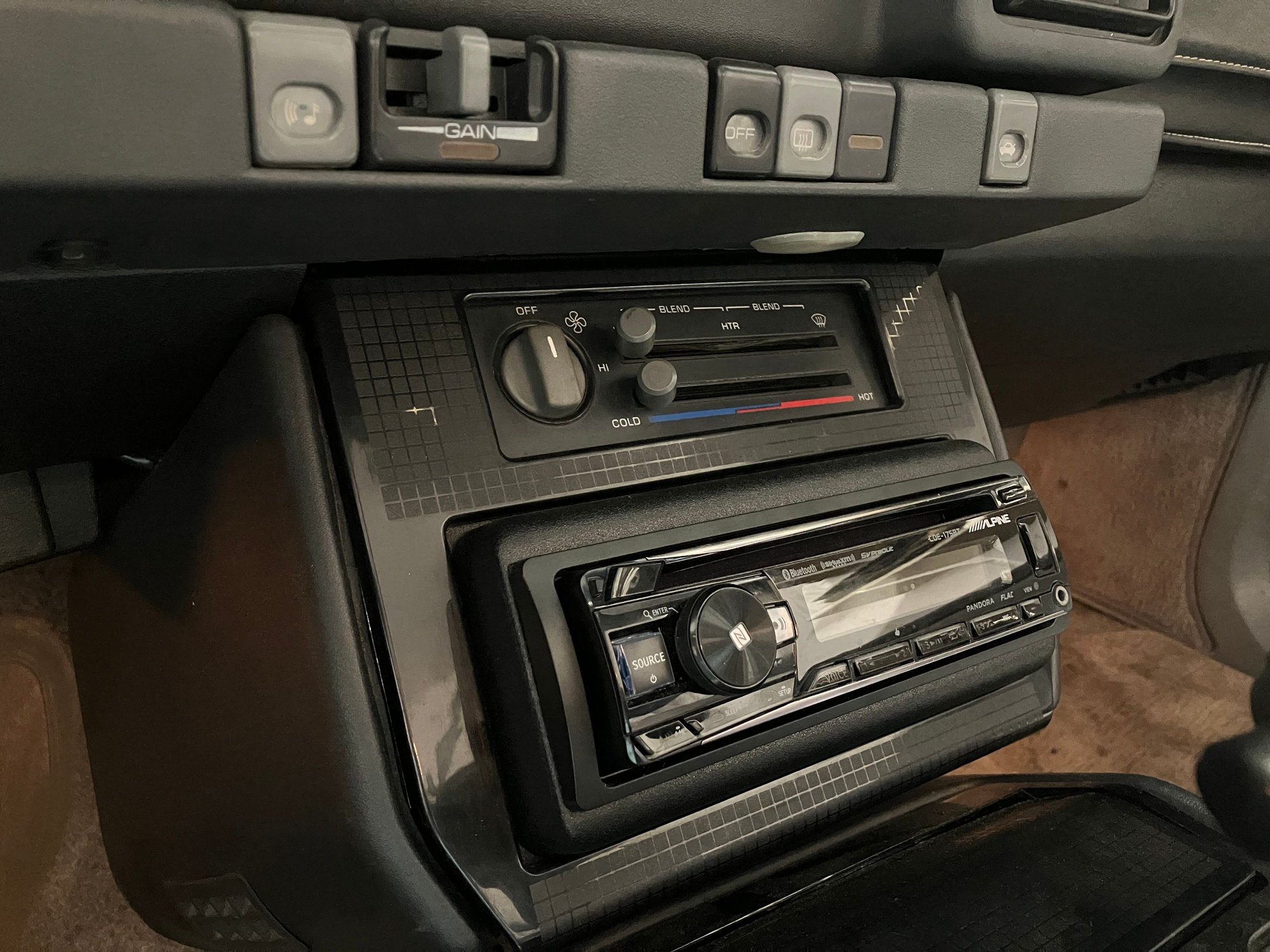

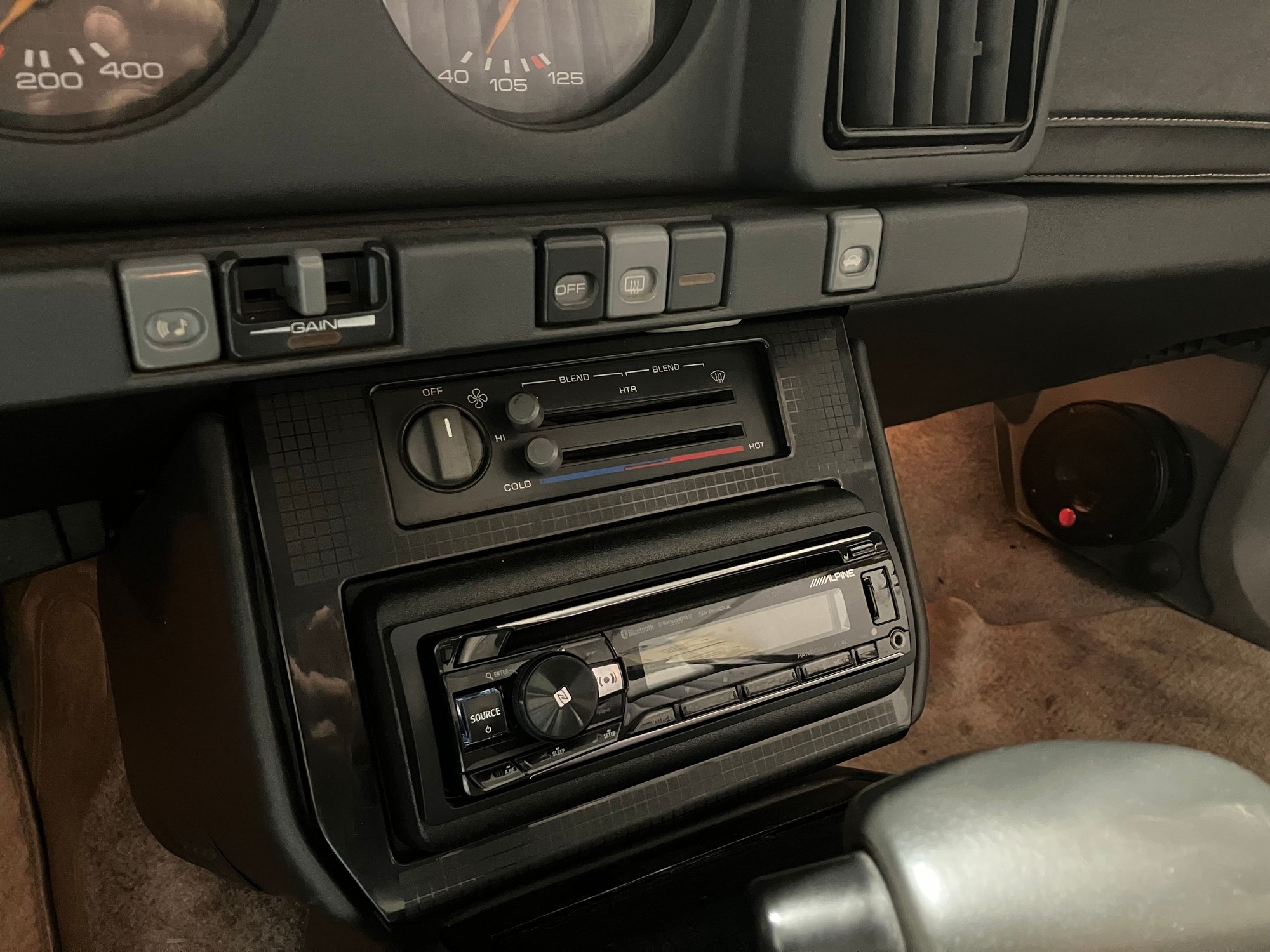

I have a newish Alpine 175BT cd player in my T/A with a typical +3/4” spaced adapter. I have external amps and rcas directly on the back of the deck - the speaker harnesses from the factory connector have been lovingly routed out of the housing to save space, the wiring harness from the deck has had every unnecessary wire depinned, removed.
And it’s still a tight squeeze.
There are Hvac ducts that take up most of the available unused space. If you need / want a flush mount deck you can get a mechless unit (no cd) that saves 3” or more of space. I can count on one hand the number of times I’ve listened to a cd vs my wife and I fighting over Bluetooth.

The adapters stick out that much. If you want it flush, as mine is, you need to cut out the radio pod at the back. This does not interfere with the duct work. I also attached a metal strap the back of my pod and was able to fasten the other end to the back of the radio to support it.

Adapter has the deck protruding 3/4”.
