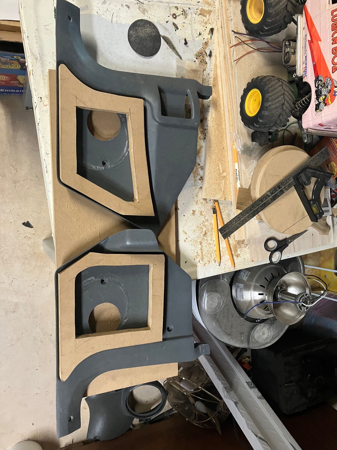

I’ve been trying for about a year to buy a used set of q forms or Bose kicks, no dice. New Q Forms with a 20% discount from Taylor are still $400 CDN. It took a while to peel my wife off the ceiling.
Home brew kicks it is. It’s not the right way, it’s not the only way. But it’s the way I’m going to do it - staying true to my no cut/no drill goal, I want everything I’ve done to the car to be 100% reversible with no trace of alterations.
Starts with a sacrificial colour matching plain kicks from a local strip shop.
3/4” mdf cut in a perimeter provides structure to the kick and allows the woofer to “drop in”, making as much area as possible in the space used (6.5s are probably too much for any kick panel).
The kicks and a pillars are opened up to expose the cavity behind (need all the space I can get to let the woofer breathe).
The kicks are 4.5” deep and are offset 22.5* - in the car measured closer to 25*. Not as deep as I’d like, but that’s maximum without protruding further than the “dead pedal”. I’m 5’10” size 10.5 shoe, my wife however is a hobbit, 5’3” and a size 9 shoe, but I think I’ll be all right if I adjust the front seats all the way back.
The speakers? Old School MB Quart RSB218 components with the competition crossovers.

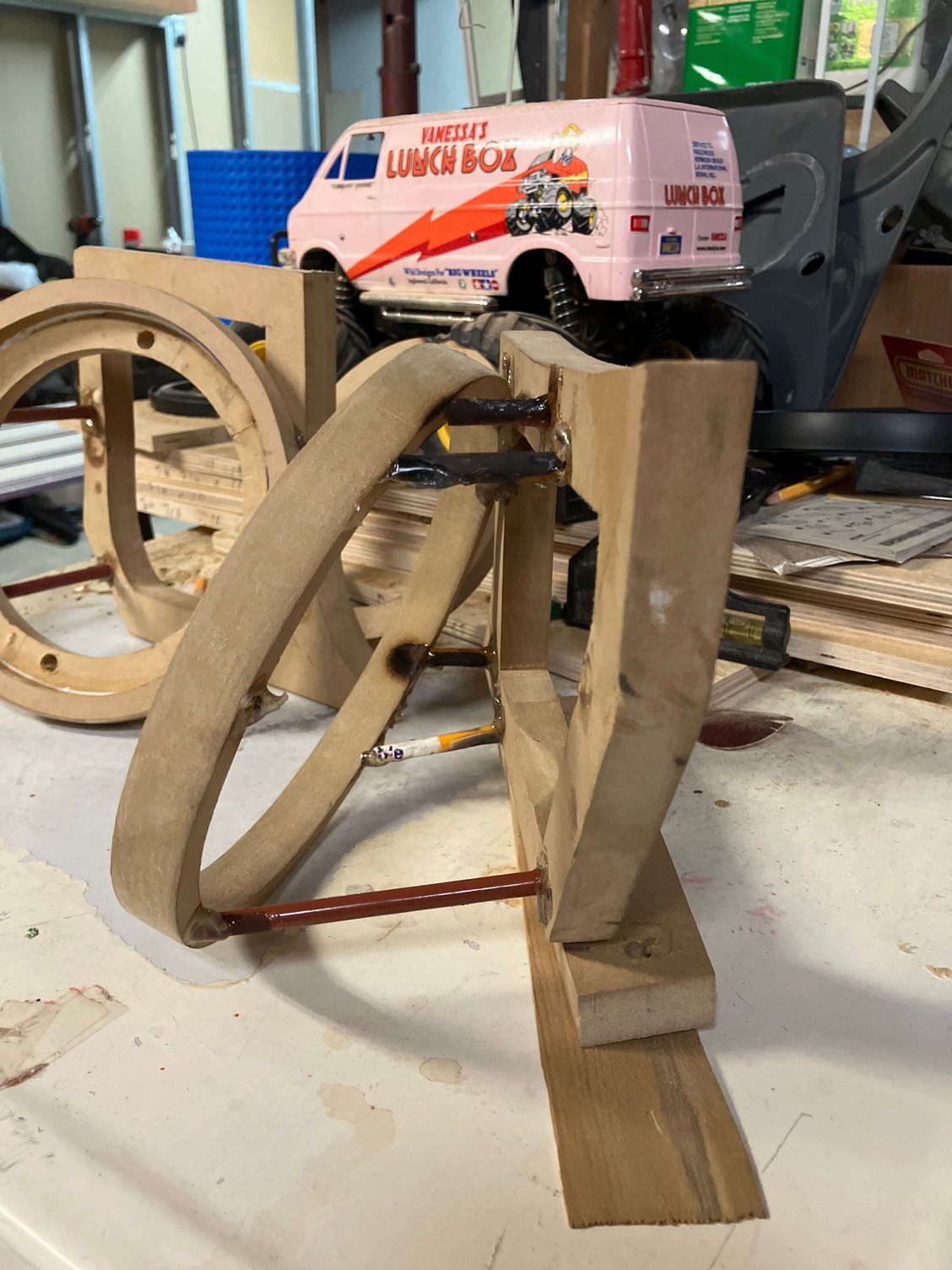

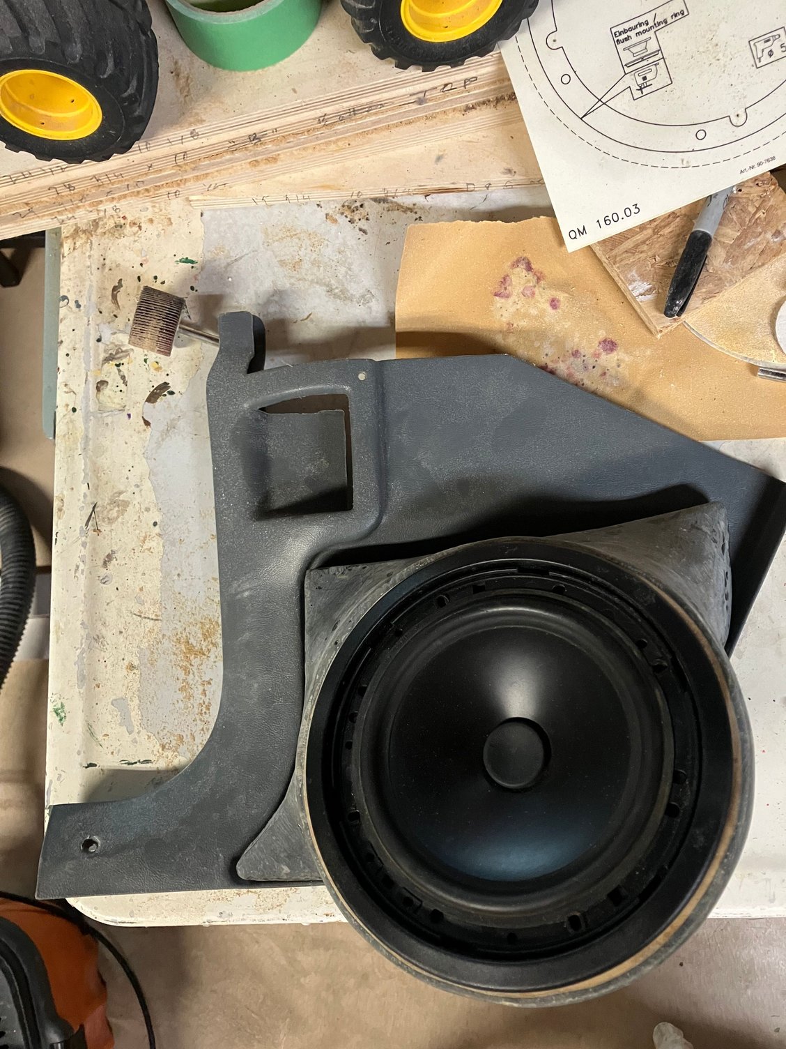

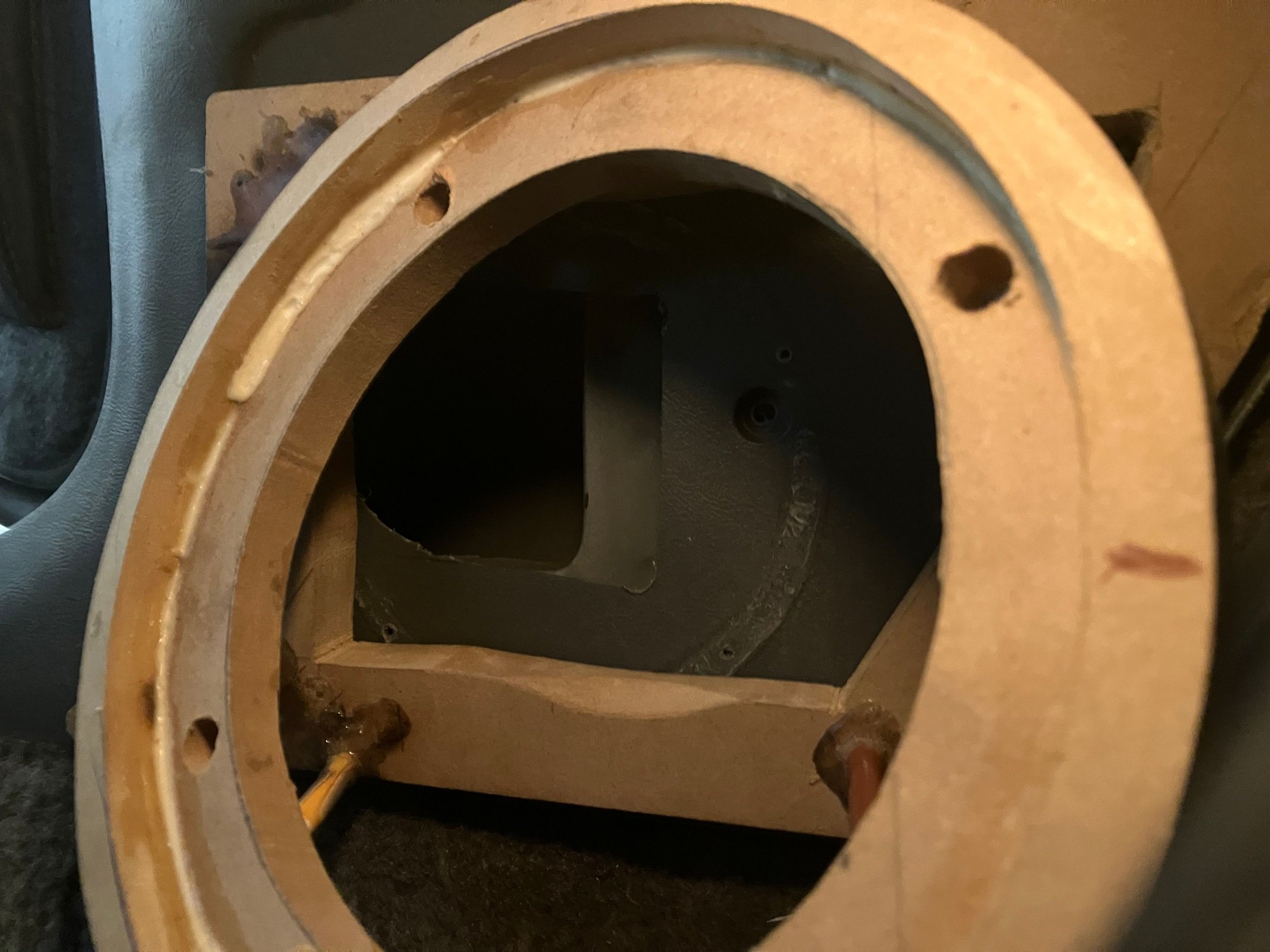

I had a doubt, then a thought.
I was concerned that the angle on the kicks wouldn’t be sufficient. A coworker volunteered an old set of civic q forms for measuring: 40* of offset. That is significantly more than my current 22*.
I reworked the kicks for absolutely max angle without overtaking the dead pedal pedal. I had to “drop” the drivers side 1.25” to accommodate the additional protrusion.
The angle of my kicks is now at 30*. There is more available I’d wager but I’m not in a position to pursue it. As it stands now my kicks clear the floor and firewall meaning hopefully reduced chance of water damage.
Also added in the mdf rings for flush mounting the mids.

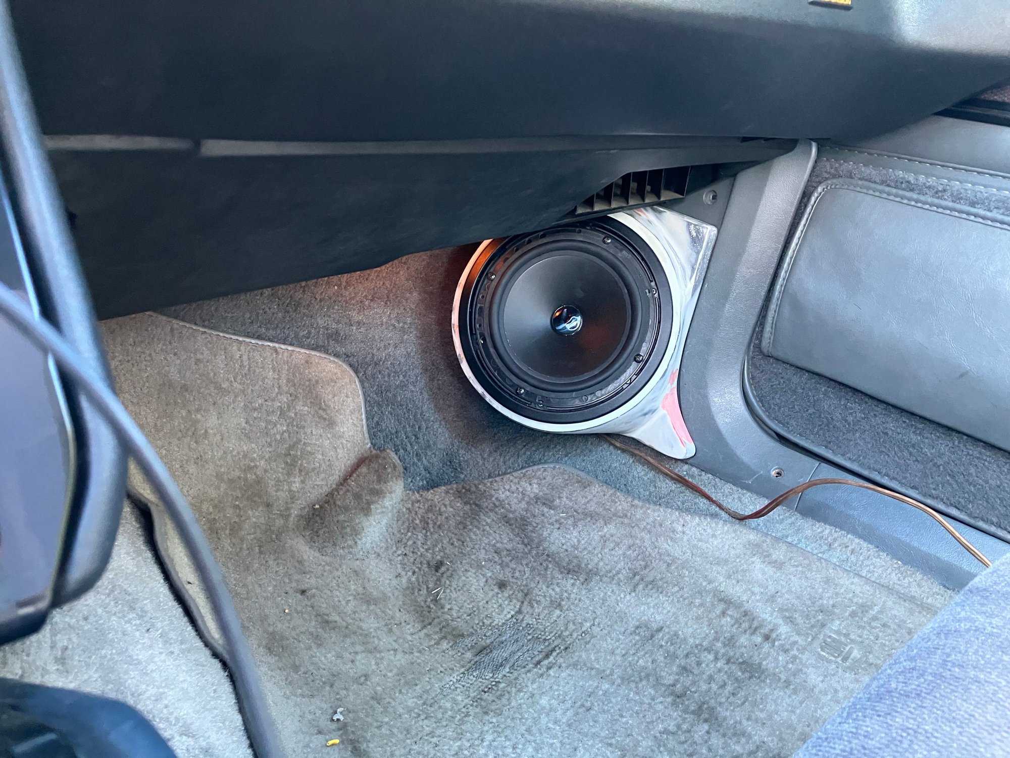

can you take a picture with one of these just placed in the car to see how far it sticks out into the foot space? i wanted to install 5.25" speakers in my TA factory dash locations, but it would require dash modifications on the driver side. now i'm debating doing something similar to you or building pods in the front lower door panel area. really want to use 6.5" component speakers but they're pretty large.

6.5s are too big for any kick panel, they need a door to fire into - the reason I opened up the kicks to the pocket in the a pillar. I would go the 5.25 route in the kicks if I didn’t already own 2 sets of Quart 6.5s.

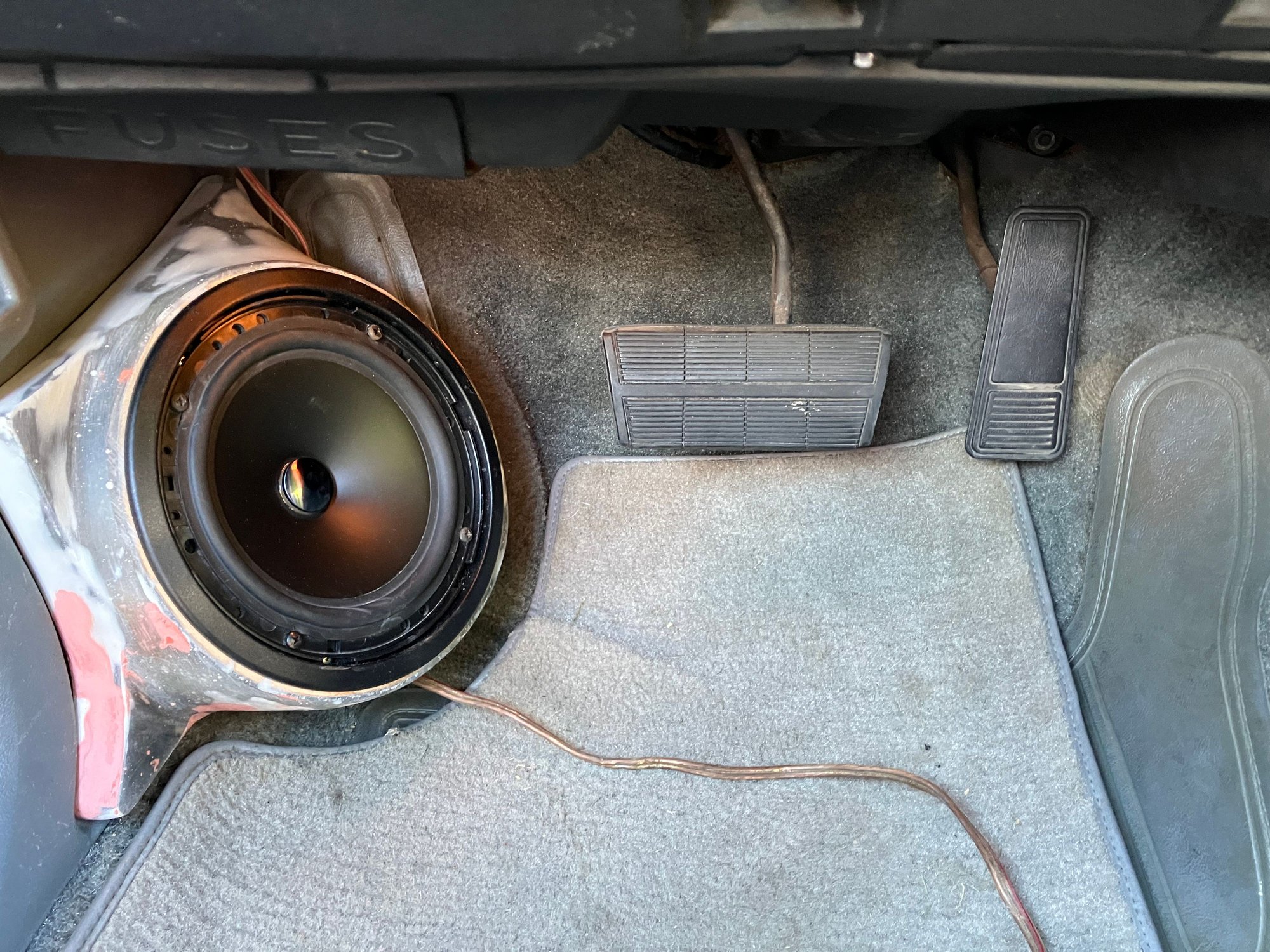

For Battman
A little better than equal distance gas pedal to brake.
the rings are massive, 8” in diameter. This is being done to accommodate flush mount as well as being a displacement grab.
the panel isn’t mounted with screws yet and seems it would tuck in a little more.
You can see the pocket in the a pillar exposed for every little cu ft.

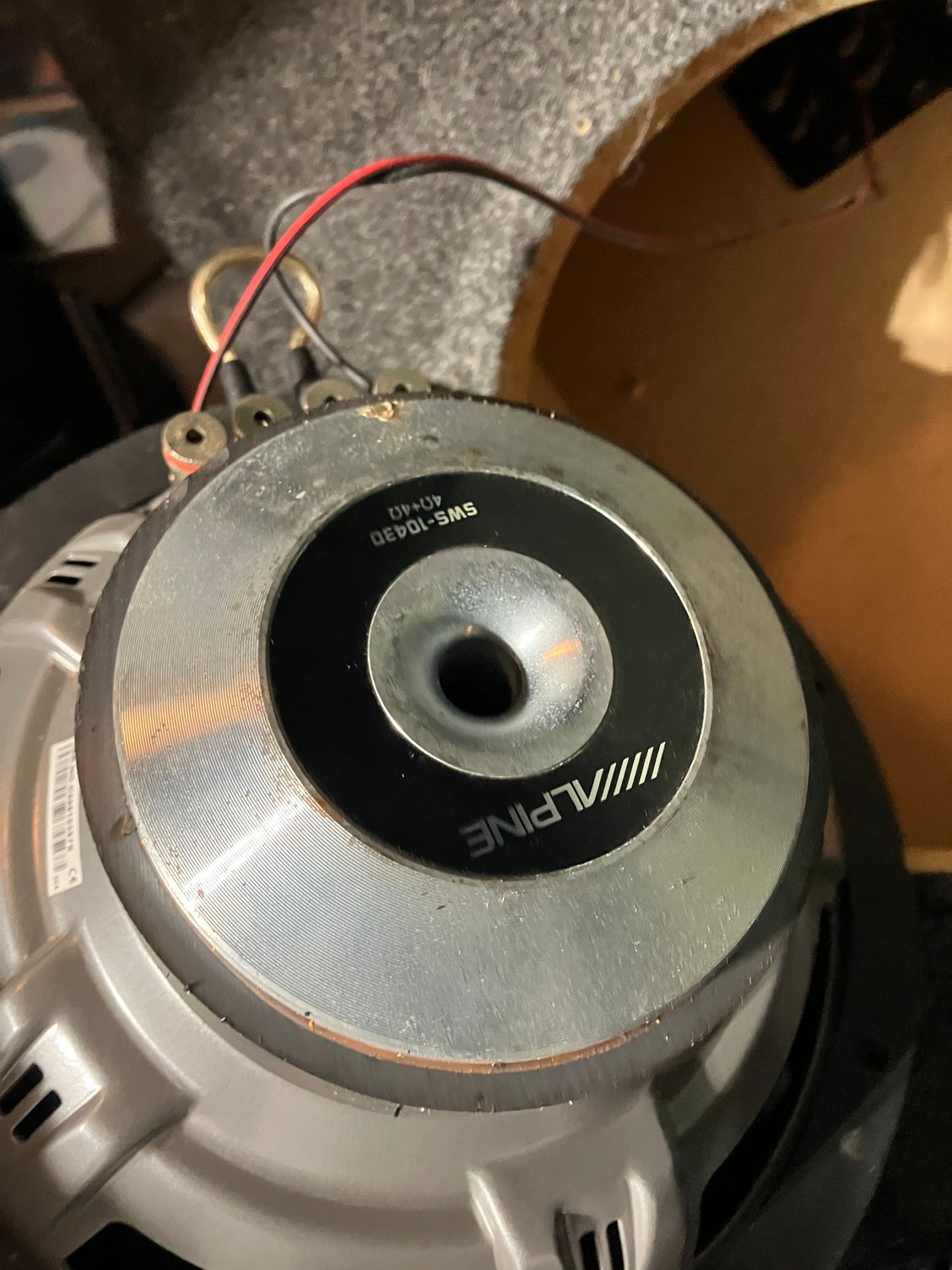

Marketplace just kills my focus
I got two alpine sws-1043d subs in a box for cheap 😁
must. build. kicks. First. Then isobaric sub box.

thanks for posting the pic in the car. these are pretty big and the speakers I was hoping to use are 6.5" i do have a set of 5.25" as well. looking like it might be better to use the smaller set.
Agreed, particularly if you’re looking to use them full range vs with a dsp or 12dB or more crossover.

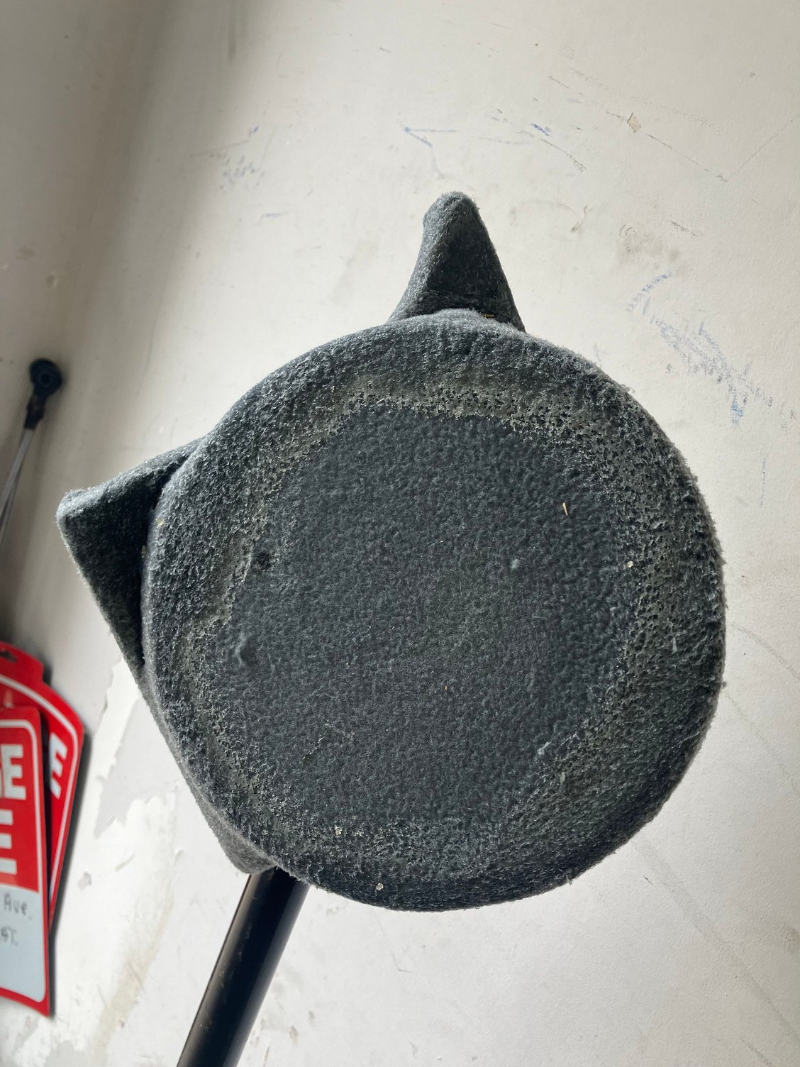

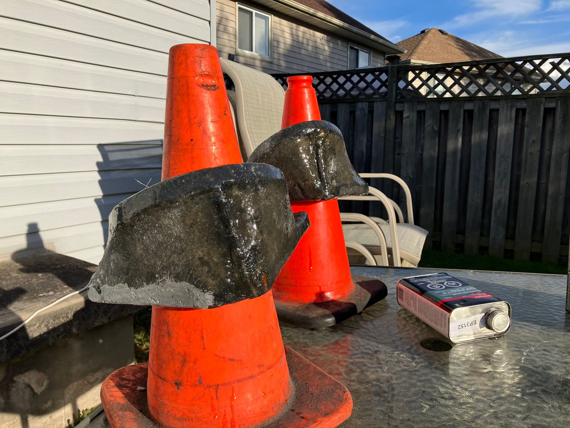

Fibreglass & resin will set you back here in Canada these days. Thankfully Princess Auto has had a sale recently and is still honouring that price, a boot 60% of normal retail. Locally Available material is from boat vendors or Bondo, nobody has time for this stuff to clear customs. I haven’t got a boat budget
Bondo’s “big” fibreglass repair kit comes with a quart of resin, a great big sheet of fibreglass matt, spreader tool and hardener.
The pods still look good, they each have a seam to eliminate the “gather” from stretching the material, I’ve “hidden these by placing them as low as possible and forward, which I hope means they’ll act like a spine for the largest (and weakest portion) of the pod.

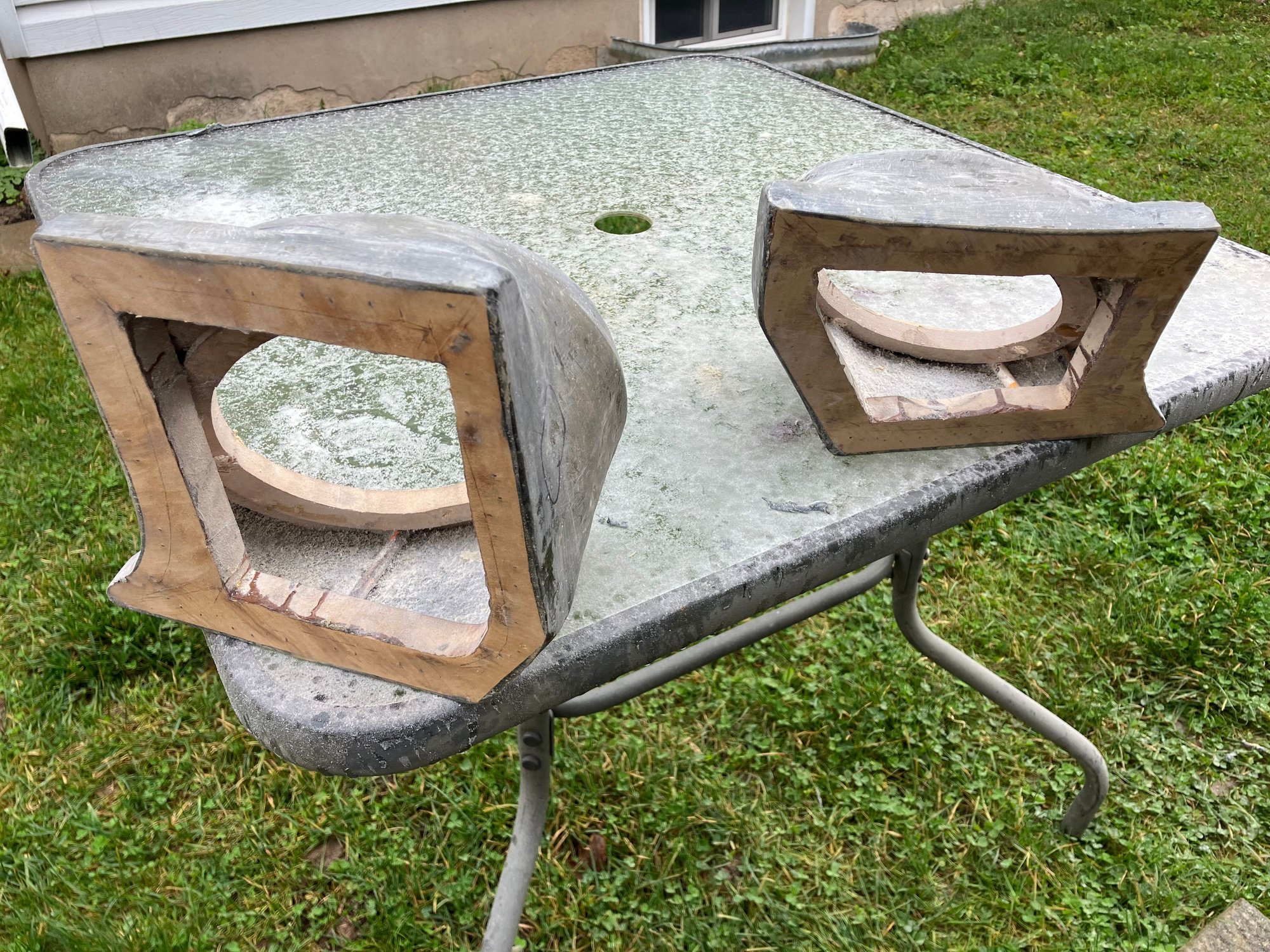

Messy, messy, messy.
One thing about fibreglass, seems you can always sand it back and add more.

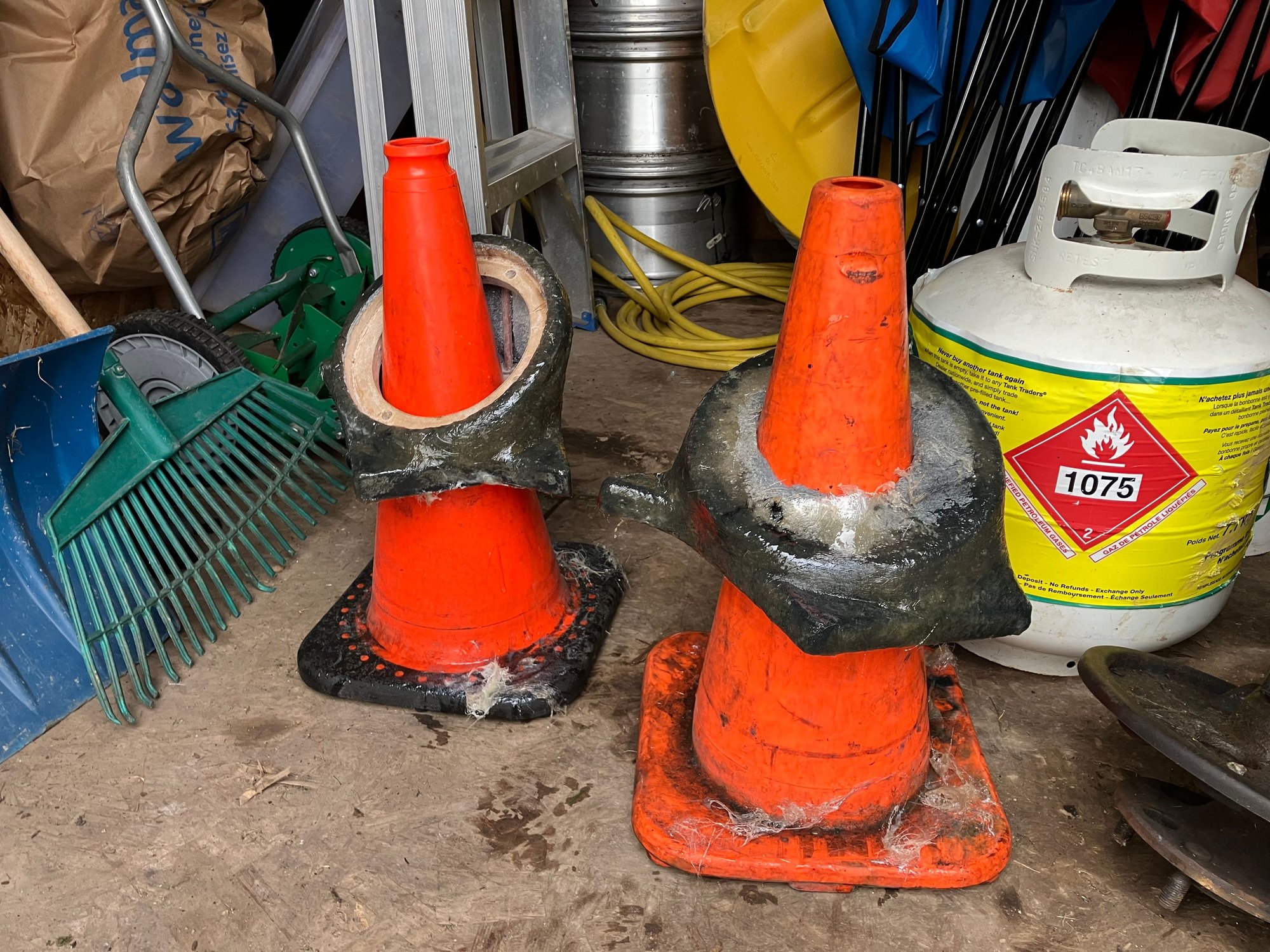

Second coat is completed.
The weather did not cooperate, cold and wet. I’m hoping they will be ready for sanding and paint this weekend. Exothermic process and all, I’ve got them warming up gently in my shed.
I’m making heavy investments in tooling to locate the tweeters.

Pods are mounted to the second hand kick panels with 3/4” wide x 1/2” thick foam tape. Shake, knock or bump, no rattles they’re eady to test in the car.
If they’re sound (…) I’ll be finishing them this weekend.

Sadly I have not yet heard these in the car. My wife wanted to see the leaves and enjoy what we expect to be the last warm day with the Trans Am. Who am I to say no?
I did get a couple of hours in before dinner.
The MB Quart MUSICOMP crossovers fit perfectly under the dash pad. Wiring is routed, hushpanels are installed. Im trying them first with no polyfil and then again with to see if there is an improvement.
Im so stoked to hear these in action.
Ive got my well worn set of woofers in place for testing, saving the clean pair for the final result.

I’ve had my first listen, and first fail.
The stage is everything I could hope for. The 3/4” tweets are a bit light, the 1” just right.
Sadly my Alpine 3554 amplifier is packing it in, channels 1&2 breaking up. The impetus for this build was what I thought to be failing kicker 4x6s, turns out it was the amplifier all along.
I’ll be swapping on my faithful 3552 (the Lamborghini sub amp) for the front - making use of the bi-amp capability of the Quart crossovers (allows offset of woofers and tweeters via the fader on the eq). A little lean on power at 30Wx4, but I believe should work out.
I’m in the market for a 150W @ 4 ohm sub amp, looking locally at a 3548 but not getting great communication from seller.

My new to me 3548. Paired up with the 3552 they make the poor man’s 3566.
The Alpine 10s bump like crazy isobaric on my baffle board - 100W from the rear channels of the 3552, can’t wait to hear them on the 3548 (160W).
More importantly I can’t wait to Bi-Amp the Quarts, have the fader control on that EQ act as intermediary for the woofers and tweets. I do want to move the tweeters a little more before settling on their current position, they’re quite vulnerable.
Add another RCA set for the Bi-Amp. Pull a second set of speaker wires, for the Bi Amp. Pull another 8 gauge feed to power the 3548. Build a beauty panel / amp rack for underside of my spare “trunk” cover. Relocate the crossovers to the amp rack. Build a box for the subs to replace the baffle board…

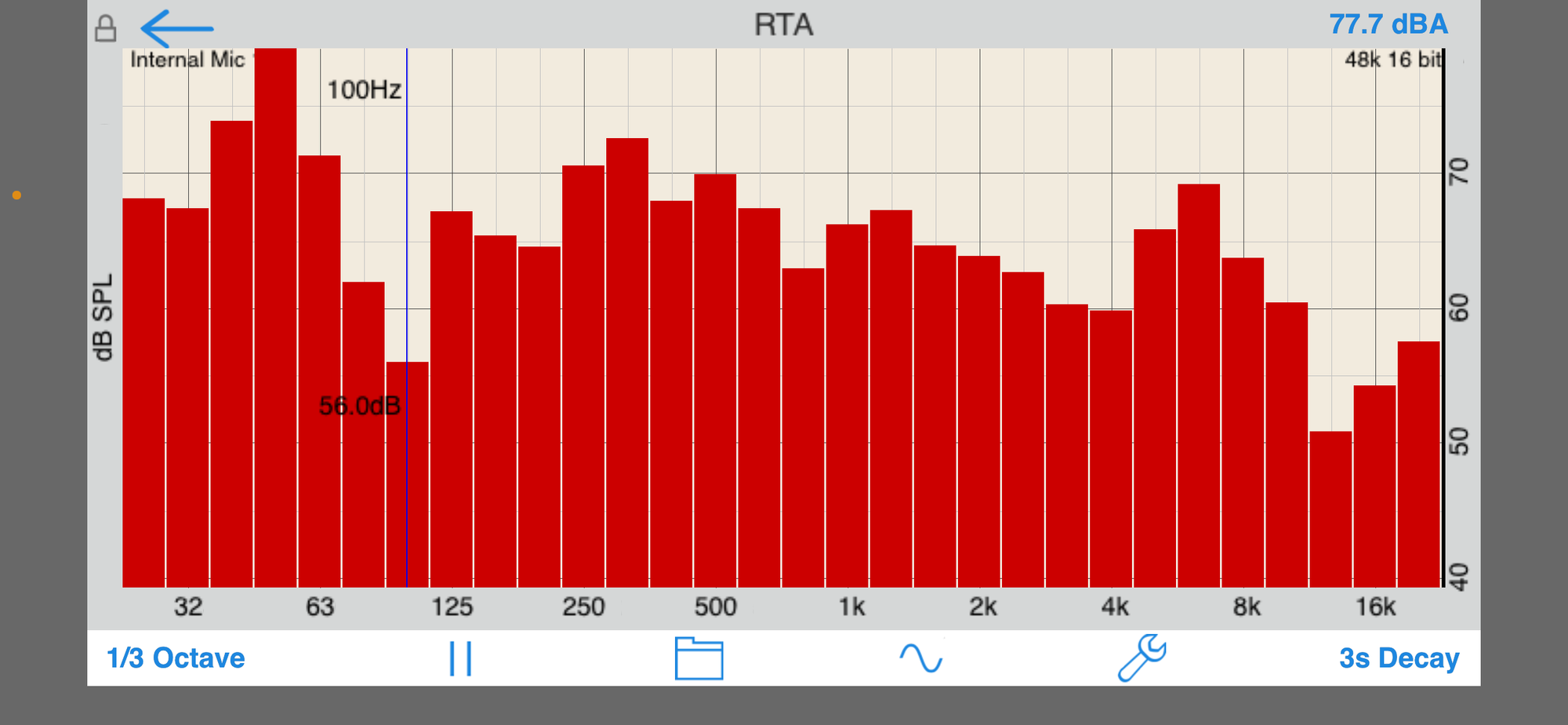

A bit of idle time through the Christmas break.
Gains are dialed in and my best efforts made to get the kicks & new sub arrangement tuned.
It does sound good, Unfortunately not what I had hoped for. Big gaping hole at 60 - 250Hz even after tuning, some ugliness at 3K. I’ve tried swapping sub polarity to correct issue at 250Hz without improvement, I’m guessing roll off from box and smallish kick panels are no help. I do have a set of 8” woofers spare, perhaps in the b pillars…

Can you share how you made that? I’m in the middle of setting up my system and the best I can do is set crossovers and check for clipping.
Old Dec 30, 2023 | 09:05 PM
AudioControl MobileTools app for Iphone.
the app is free and will work with the iPhone mic, if you’re looking to take a deeper dive A/C sells an iPhone mic for $400
Right off the deep end? JL Audio Tun - really meant for use with their DSP amps, but you can work with it “on the outside “.
$40 Amazon digital oscilloscope for clipping.

Two months of bathroom remodel purgatory are drawing to a close.
Ive added a little colour to the pods and brought out the newer set of Quart drivers.
Pretty chuffed with the result.

I've never seen a tweeter floating like that, does it have any effect not being in a sealed pod?
Great question
Simply, no.
long winded,
Ideally the face of the cone of a speaker would be sealed from the rear to prevent cancellation. This is why we preach about sealing drivers to door skins/grill. However this is inherent with tweeters as the rear of the cone is the magnet itself. Ideally the should be no more than the diameter of the woofer cone away from their paired driver to keep the stage on the same plane. All the new school kids with their DSPs and A pillar pods can fight me. In the old school with tweeters we focused more on reflection, these little guys are aimed at the dome light, but will generate loads of reflection off of the hush panels.
I received a gift from a fellow gen x installer, I thought I’d never find them.
that suckout below 250hz is pretty much unavoidable because there's just no air volume for the woofers. I fought with this in my kickpanel builds too, and the only way to fix it is to add significant airspace behind the woofers (and try to find a woofer with a lower Qts) or move the woofer to the door and add a mid in the kicks. Now that I'm back to work on my car, I'm trying to figure out what approach that I want to take. The fenders are off the car, so now is the time to build out an enclosure in the void between the kick panel and the fender if I decide to go that route, or start exploring a door option. To be honest, now that we can time-align every driver individually, there's a lot less advantage to having everything stuffed into the kicks as there used to be. Back when I did my kicks the imaging and staging was fantastic for its time (but that hole under 250 was awful), but when I did my last truck I kept the stock door location with tweeters in custom pods mounted midway up the sail panels, and once I time-aligned the whole thing, it imaged better than my Camaro with a much higher soundstage. Because of that, I'm almost certainly going to put the tweeters in the sails in the Camaro, and then I may end up with mids in the stock dash location with woofers in the doors. I dunno yet, but either way, I've come to the conclusion that I can't live with that massive suckout below 250hz.
