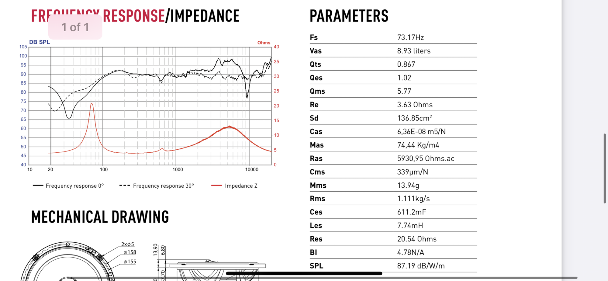

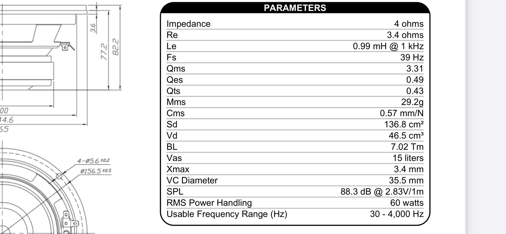

that suckout below 250hz is pretty much unavoidable because there's just no air volume for the woofers. I fought with this in my kickpanel builds too, and the only way to fix it is to add significant airspace behind the woofers (and try to find a woofer with a lower Qts) or move the woofer to the door and add a mid in the kicks. Now that I'm back to work on my car, I'm trying to figure out what approach that I want to take. The fenders are off the car, so now is the time to build out an enclosure in the void between the kick panel and the fender if I decide to go that route, or start exploring a door option. To be honest, now that we can time-align every driver individually, there's a lot less advantage to having everything stuffed into the kicks as there used to be. Back when I did my kicks the imaging and staging was fantastic for its time (but that hole under 250 was awful), but when I did my last truck I kept the stock door location with tweeters in custom pods mounted midway up the sail panels, and once I time-aligned the whole thing, it imaged better than my Camaro with a much higher soundstage. Because of that, I'm almost certainly going to put the tweeters in the sails in the Camaro, and then I may end up with mids in the stock dash location with woofers in the doors. I dunno yet, but either way, I've come to the conclusion that I can't live with that massive suckout below 250hz.
^^^. This right here, on the money.
Ive been flirting with the idea of going to 5.25” drivers to help the suck out issue, even started looking at DSPs (eww) to try and correct for plausible cancellation. I won’t admit defeat, not yet I have too many hours into the kicks to quit on them.
see below, two well known manufacturers.
one is expensive, other is not.
which direction would you take?
when dealing with just the suckout specifically, probably the first one just because my quick in-my-head calculations say that will function better with no airspace, but realistically, they're both going to still have a huge suckout, and then once you pull other factors in, you can't ignore the low frequency rolloff of these drivers, especially the 2nd one, is going to leave you another gap at the sub crossover frequency, if not one big gap from 250 all the way down to sub crossover.
