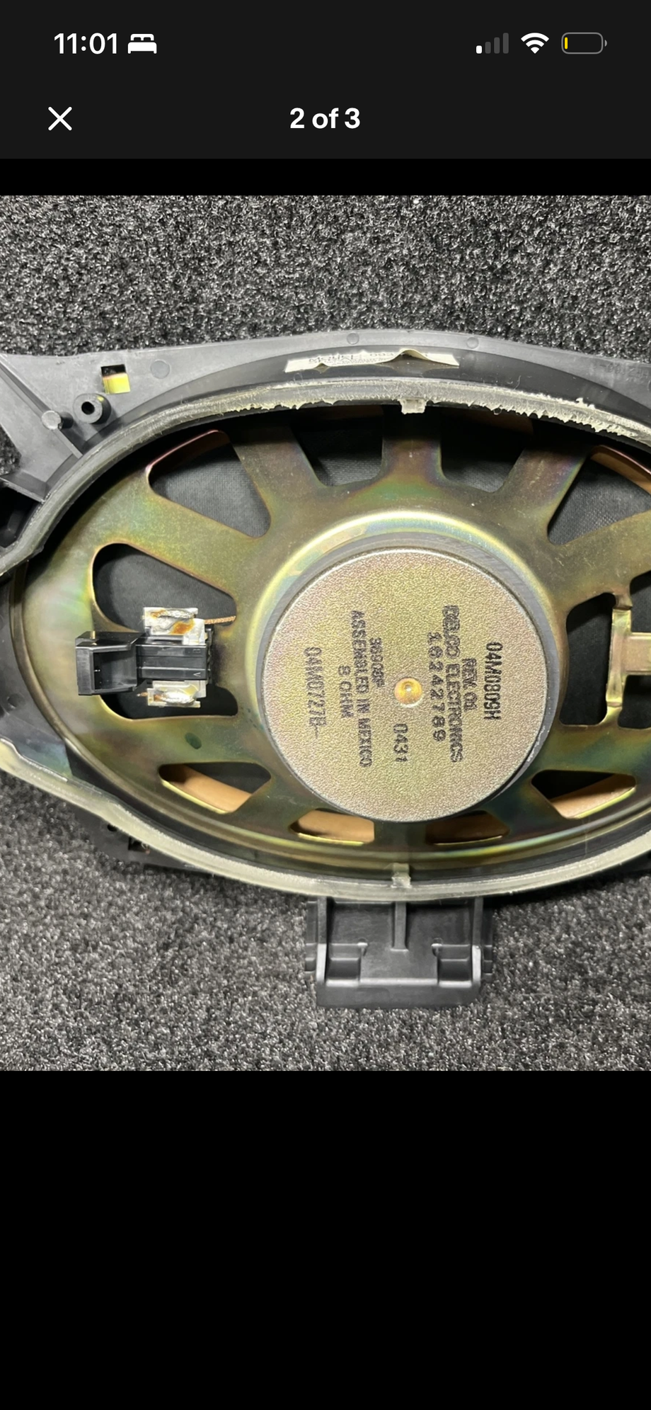

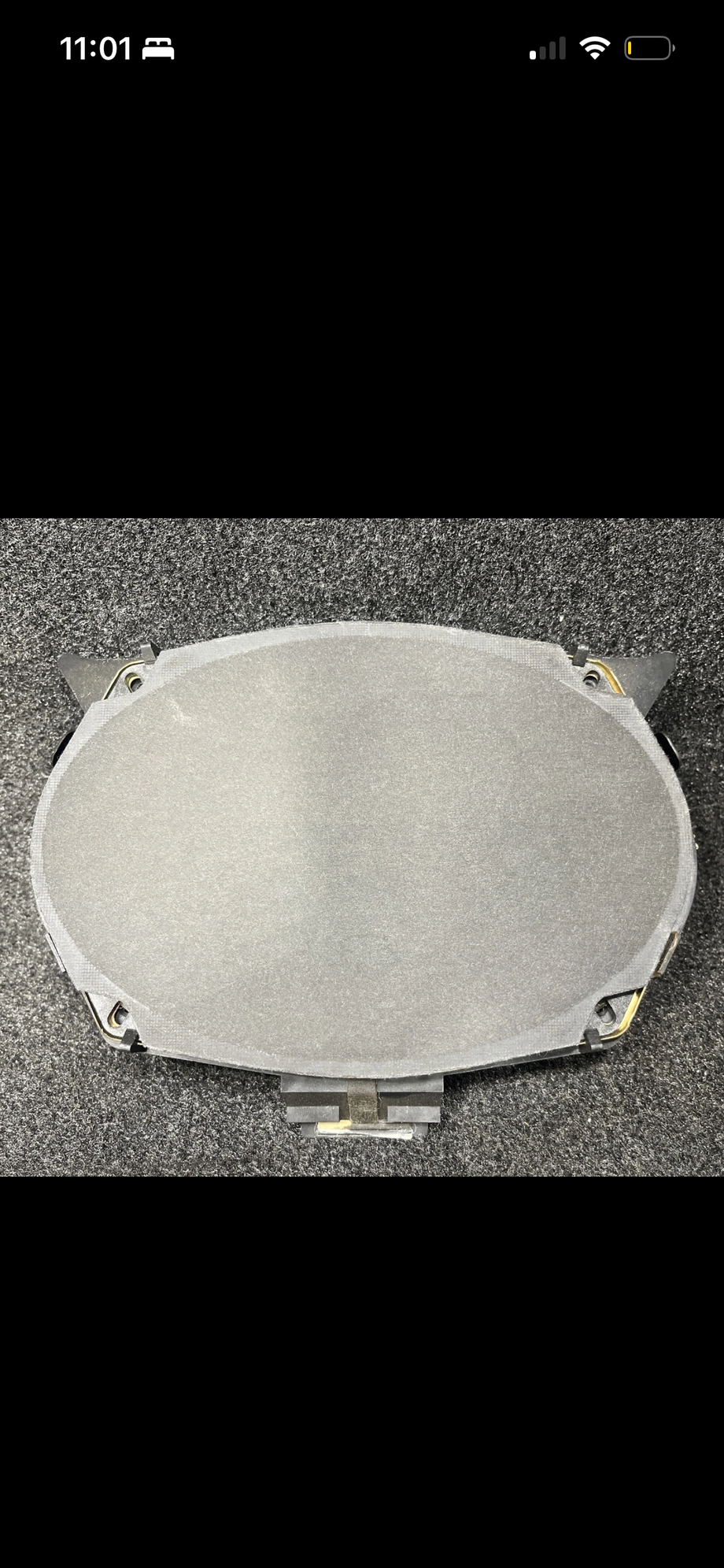

Having spent my fair share of time in the junkyard, I’d suggest early / mid 2000s Malibu / Grand Am / Alero
