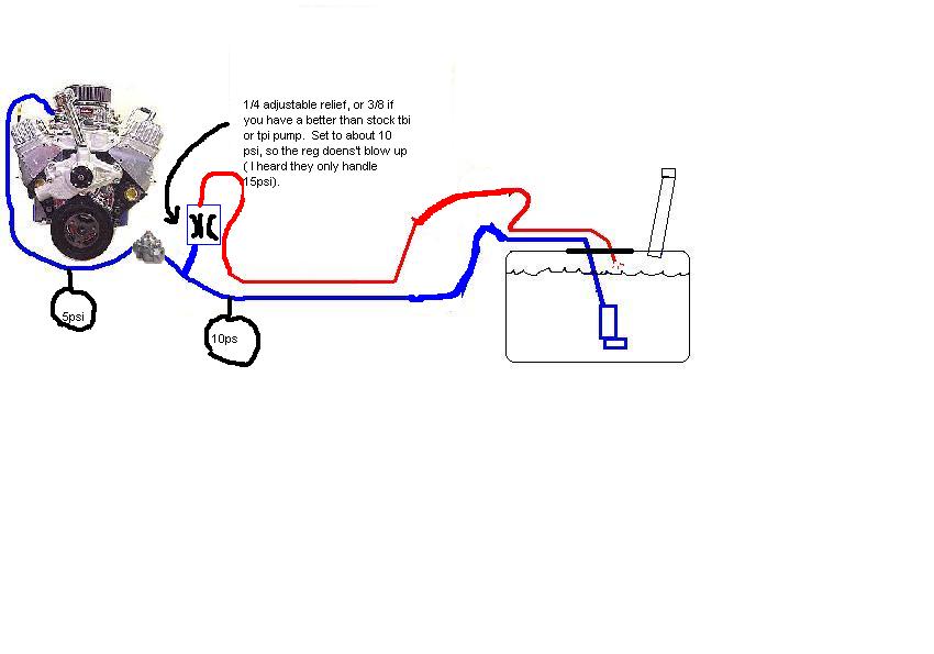

This is what I'm about to do with my holley regulator, and edelbrocl 750, and walbro 255 pump.
If your gonna do this make sure the relief you use can flow enough to get rid off the extra pressure your pump makes (ie: hook up a cap to your supply line instead of your regulator). I'm using an adjustible relief from swagelok.

Originally posted by Low C1500
Pic
Low C1500 has attached this image:
https://www.thirdgen.org/techbb2/att...postid=2042038
wow two regulators? you have REALLY over complicated this

Originally posted by THEGENERAL
thats good in thought but what about the line size and restriction you would have ????
it's the same size line. GM's too cheap to use different stuff

returning fuel to the tank via the vent tube will cause vapors to build up in the tank resulting in a really nice fire and possibly explosion

agreed all post 85 efi cars TBI, tpi, V6 all have a 3/8" feed and 5/16" return

that is basically where my idea came from, it is not in fact really "my idea". after working on some very late LG4 cars (I think the monte ss did this as well) I saw how the factory did it. It never created a problem for them except when a pump dies and even then because there are two lines under the surface of the fuel to pull through:
1 dead pump on feed line
2 return line
even a restriction of the dead pump affects are so low as to be un-noticed by most owners.
The restriction of the return line never/rarely happens, other wise it would plague EFI owners too.

Ok I'm pretty sure I understand all this. I'm swapping TBI to carb. I have the in tank EFI high pressure pump and it still works. And i dont really wanna cut my welded exhaust AND drop my tank to replace the pickup. I have a holly 2 port mechanical on block fuel pump that I can put on. Now all I hafta do is run a T fitting on the mechanical pump and put the return line and the supply line onto the T fitting? Im pretty sure thats what you guys mean. But my question is, Am I supposed to have the in tank EFI pump run with this setup? Or will fuel actually run through the EFI pump with it off? BTW I know the return line is now also feeding the mechanical pump.
Old Feb 23, 2005 | 08:15 PM
  #44
B4Ctom1's Avatar
Veteran: Air Force
Posts: 4,991
From: Cheyenne, Wyoming
Car: 1992 B4C 1LE
your factory pump is low pressure
TBI is low pressure
you can run it to the mechanical fuel pmp like Monte SS's did
low pressure in tank pump, to mechanical pump, to regulator, to carb.
Monte's didnt have the benefit of a nice regulator.
You will have to make sure the fan and fuel pump relays are grounded on the sensing lead (you will need a wiring diagram for this) and they will both come on anytime the ignition is switched on.
Old Feb 23, 2005 | 11:08 PM
  #45
86transamws6's Avatar
Joined: May 2001
Posts: 312
From: Westminster, Ma Blairsville PA (Wyotech)
Car: 88 IROC - 86 Trans Am
Engine: L98 Carbed - 350 Carbed and boosted
Transmission: auto - T5
So I don't need to use a T fitting and use the return line for the supply? Also what should I use for a FPR?
Old Feb 23, 2005 | 11:12 PM
  #46
B4Ctom1's Avatar
Veteran: Air Force
Posts: 4,991
Car: 1992 B4C 1LE
if you dont want to run a FPR you can do the T fitting thing.
Im not sure if your mechanical pump will operate properly even with the low pressure TBI pump dead headed against it anyways.
Old Feb 23, 2005 | 11:24 PM
  #47
Joined: May 2001
Posts: 312
Why not?
Old Feb 24, 2005 | 06:20 PM
  #48
B4Ctom1's Avatar
Veteran: Air Force
Posts: 4,991
Car: 1992 B4C 1LE
What I am saying is use the "T"
