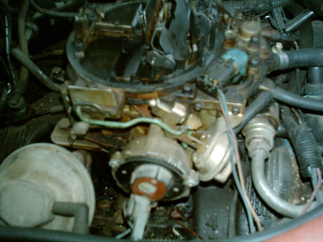

Pic of the questioned side:
I am not too carb savvy, but the engine is off and the choke is cracked open.... I think something is odd with that, the adjustment is all the way in.... I think thats off also.
I dont know why it is firing off without power to the distributor, it has a HEI coil and no the fan is not wired to it, so there is no reverse generator effect going on.
I tried 92 octane with octane boost so its not bad gas either.... im lost and confused...

Nope nothing missing carb is intact.
Look at all the black crap on the air horn. When you carb gets that build up it's from over fueling which will cause the run on problem your having. I doubt taking a tad of timing out will help in this situation. Your carb hasent been rebuilt before at least properly since the rivits are still in the choke housing. It's time to rebuild this carb and epoxy the casting plugs since they are probably whats causing it to run on.

I knew it was very dirty, its the original carb from 1986 and never been rebuilt. hardly anything other than oil changes and ignition mainenece was done.
I have never rebuilt a carb before and I am confident I can. I will check for the tech page on how to do this.
One more question though, the rivits, how are they removed? Is there a rebuild guide with pics?

There's nothing to drilling them out. You don't have to drill right through them, you just need to dimple the heads enough that they'll fall apart.
