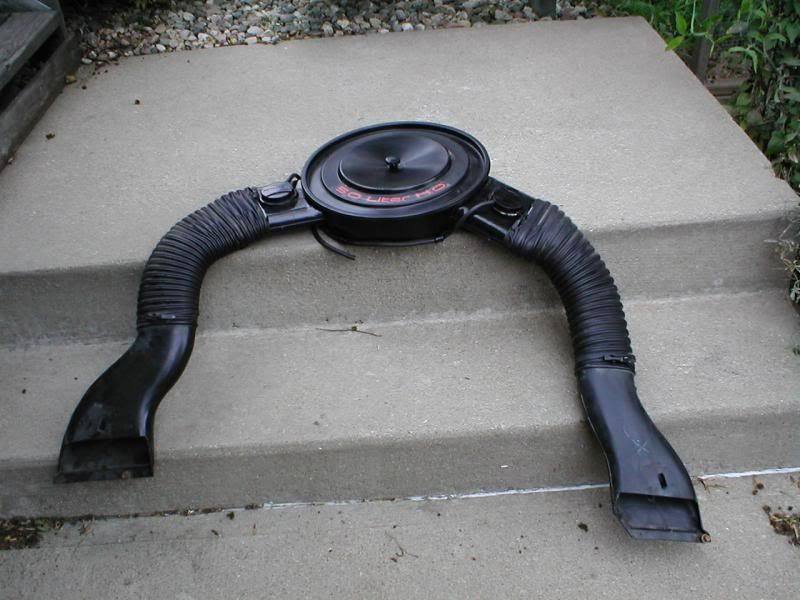

Old Oct 4, 2015 | 03:08 PM
sahlomonic's Avatar
Joined: Nov 2013
Posts: 58
From: Overland Park, KS
Car: 1992 Z28 Z03
Engine: LB9
Axle/Gears: 2:73
Re: Spectre Cold Air Intake Kits
Find the air cleaner setup from the L69 Z28 H.O.'s '83-'84 and you'll have pretty much the same thing.
Old Dec 23, 2015 | 01:07 AM
mr_z_nasty's Avatar
Joined: Sep 2004
Posts: 1
From: North Carolina
any idea where to get replacement hoses at for that L69 setup?
