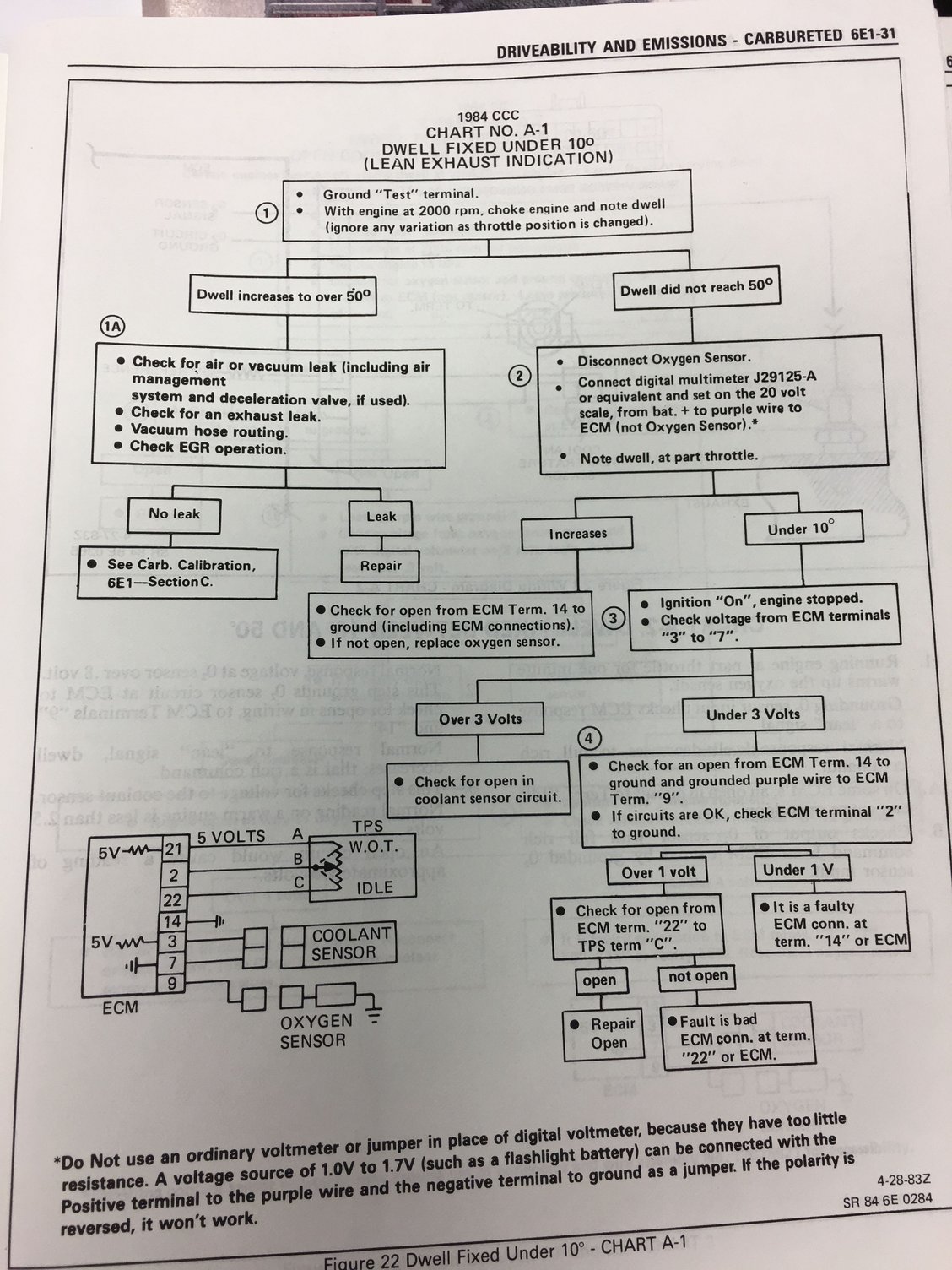

Cracking open the '84 shop manual, after the following testing.
Choke linkage may have been early issue which is now resolved.
Dwell is 6 degrees with Sears Penske meter. Monitor 2000 says closed loop and lean, and 6 degrees. Currently waivering idle 600 to 925. RPM based on both Penske and Monitor devices.
The somewhat arbitrary twisting of idle air mixture has had no effect in either direction. Have gone up to three turns in and three out from base setting.
Currently all items are back to base settings as described in first post above, including 2 & 5/6 turns out on each idle mixture screw.
'84 Shop Manual states if dwell below 25 degrees and idle air bleed valve has no affect, then back out idle mixture screws one turn each.
Manual says idle air bleed valve should be adjusted in 1/8 turn increments. Noted.
Will do these steps in a couple hours unless I hear otherwise here.

After more time with it I think it may be related to AIR system. I ran out of time before I could be certain, but it appears in closed loop that air is still being directed to the manifolds.

Keep in mind, those troubleshooting charts are for NEW cars; basically where you're working on brand-new perfect factory-stock showroom product, and ONE thing has failed outright, and you're trying to zero in on it. Not the same as, an ANTIQUE car, with possibly multiple unknown wear-and-tear and deterioration issues, not to mention potential misassembly and such, which can lead to things happening that the chart creators did not envision. In a word, the chart is the "expected" things that might go wrong. You need to prepare to expect the unexpected. Note carefully that I am NOT saying "the chart won't work", or "you messed it up so bad it's off the chart", or "the chart is wrong" or "useless" or ANY such; only, be mentally prepared that the chart might not lead you in a straight line to your trouble(s), and may instead lead you around in circles that totally miss the actual defect(s). At best, it may be a serious zig-zag, and might take ALOT longer to decipher all of that, than to simply go back and check your work carefully.
