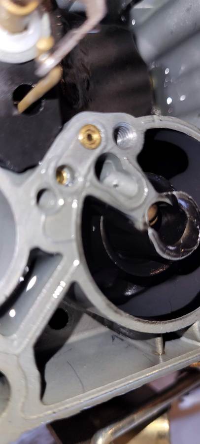

Almost forgot- here's a picture of how deep my IDCRs are. I don't claim to be a photographer nor do I play one on tv.
