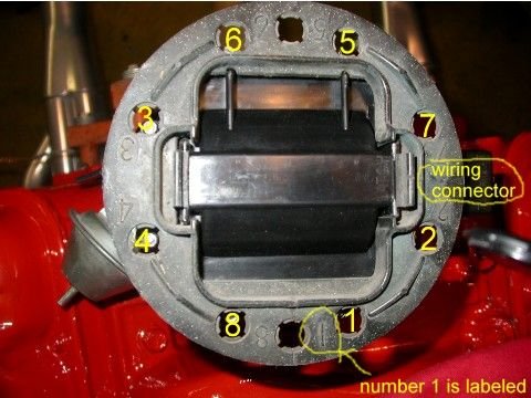

You can rotate the distributor to anywhere you want, as long as the rotor follows the housing (and cap).
Also, you can put #1 in any position you desire.
So what you are saying is that you need to rotate the whole thing 90 degrees CCW? Or just the cap?
If your cap has those L-shaped spring-loaded hold-downs, then it can attach to the distributor base in any of 4 positions.
Is the vacuum advance canister pointing somewhere between #6 and #8?
If so, then all you need to do is move the cap 90 degrees and reposition your plug wires on the cap.

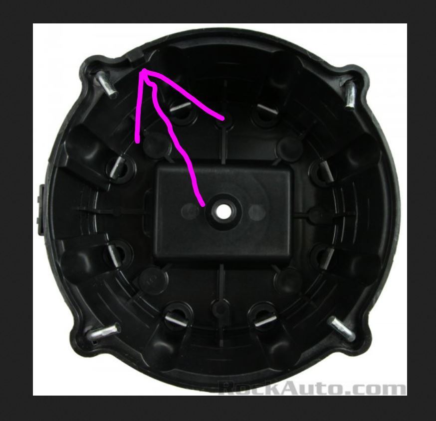

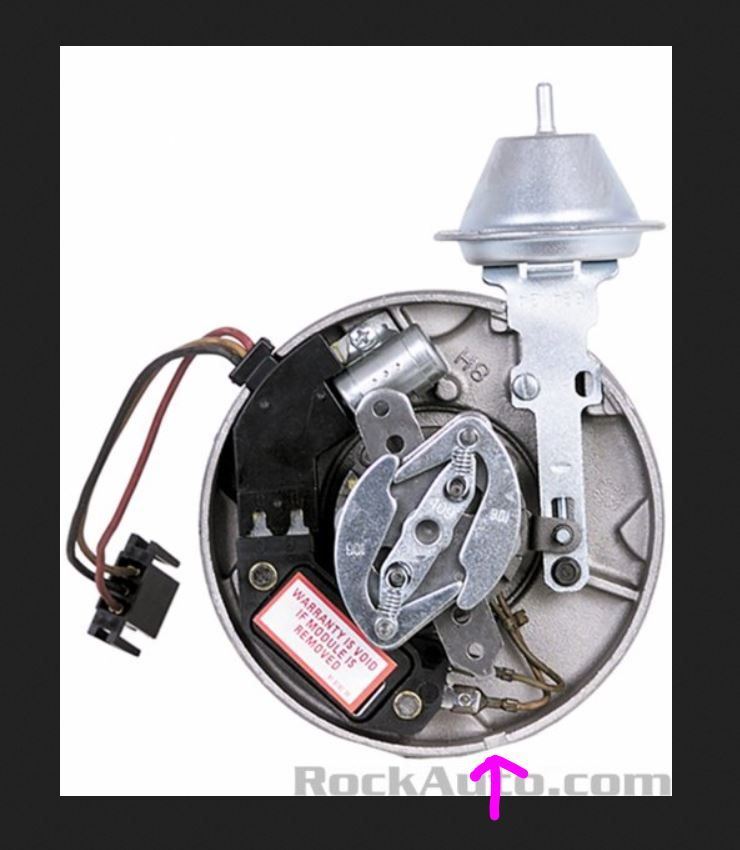

Are there GM HEIs out there that don't have the alignment peg so that the cap can only go on one way?
If the hookups on the cap don't point toward the driver's fender, you need to drop the distributor in right. If you get it too far off the vac advance will hit the intake before the timing is right, or other goofyness.
The stock aircleaner should have a sizeable dent in the back to clear the distributor. If it doesn't clear it's assembled wrong.
Pull the #1 plug. Put a finger in the hole. Roll the engine over until you feel air rushing out. Watch the timing indicator, run it up until the balancer and timing tab read 0*, you should be at TDC. Drop the distributor with the rotor pointing at #1 (approx driver's headlight). If it won't drop in, use a large screwdriver to turn the oil drive and try again. It doesnt matter as much with a carb, but it still fits better in the car when it's all right.

Thanks Drew - guess I got confused. I forgot about the notch.
In any case, this is what his should look like with the proper orientation..

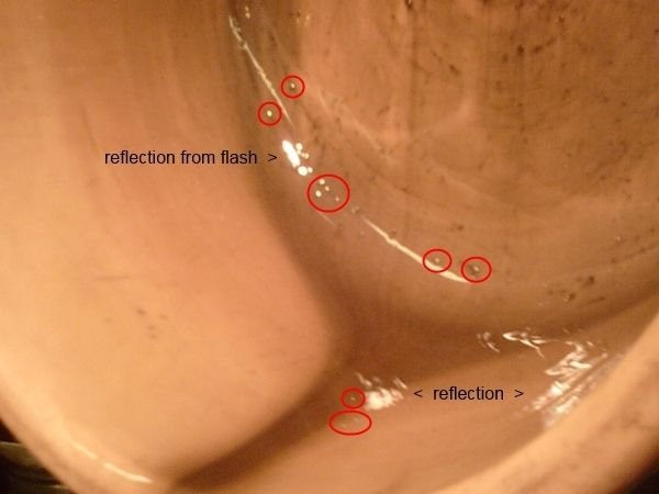

Put in a new cap and rotor today along with new wires. Repositioned the oil pump drive shaft then and got everything lined up the right way. Popped off easier and right away, but I still have the backfire in the exhaust. Still feels down on power since you feel it popping. Need to get a video- it's at steady state and just as rpms come down that it happens.
I did find a piece of metal under the valve cover- thought it could be trash that fell in and I didn't catch when I did the intake. It looked to have fornicated and lost with a spring at some point.

Here's the piece I found. Looks almost like a pull tab from a can of BG Oil additive I used when not using Rotella.

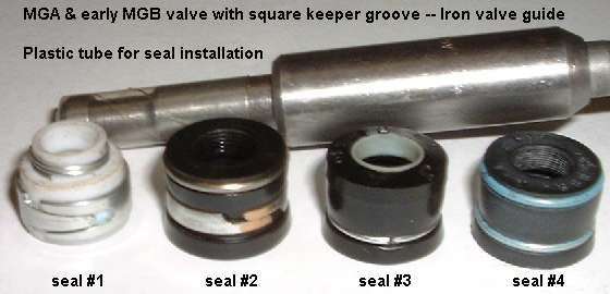

Looks like it might be a retainer from a valve seal. Like these:

Didn't even think about that. Probably correct. I put Felpro Blues on about 10 years ago. Should be fine you think?

If the tension ring came off a valve seal, the seal probably isn't staying on the valve guide. If the seal is free, you'll probably get oil in the cylinder.

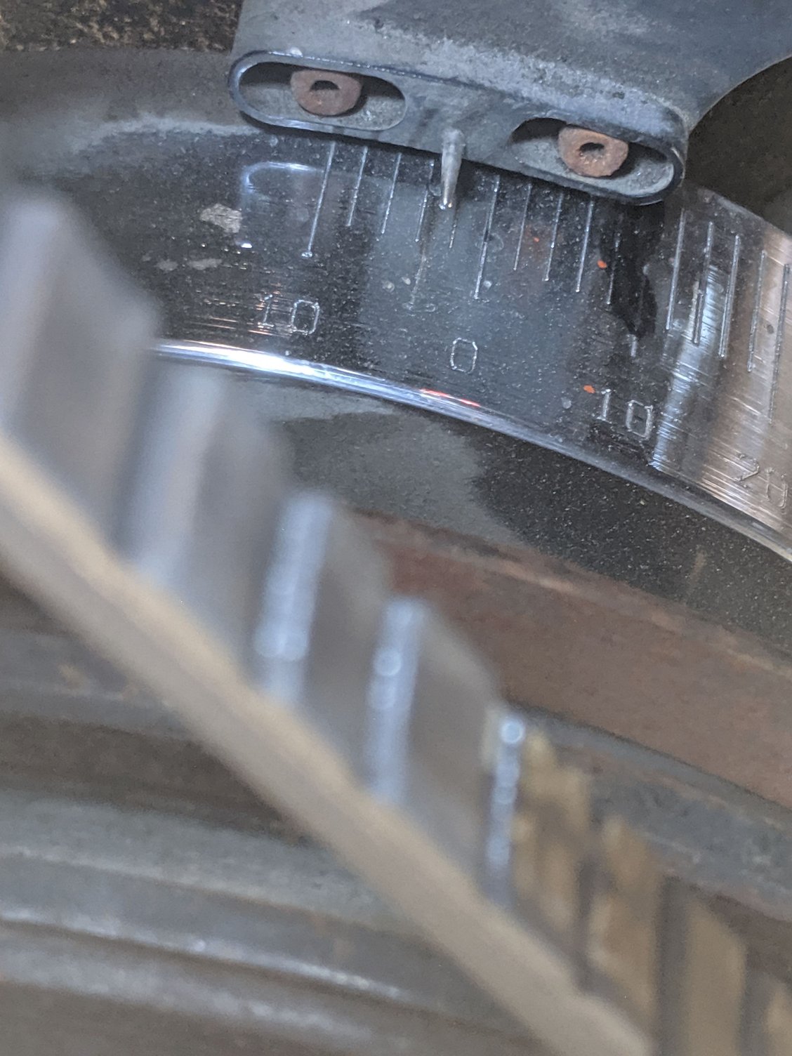

Replaced the coil with a new Accel Supercoil. Made no difference. Then replaced the ICU in the distributor with a known good unit from my spare dizzy, and double checked the internal ground. No change.
Discovered my timing light is junk. According to it I had 80* at idle, and the more I advanced it (cw?) It got closer to the actual numbers on the balancer.

Turn the distributor Counter-clockwise to advance it. You were retarding it, that's why the line came back towards the numbers.

Ok, that makes sense. In that case, the more I advanced it the more it backfired and tried to die.
Never had any issues before the carb and intake. Intake is the same as what it replaced besides carb mounting bolts holes.

IIRC, when I was setting idle I was pulling about 14inches, but was anything but stable. It was dipping down to 11. I'll try and get a video of that as well.
I checked the order again. I was off by 1 all the way around. I had 1 starting right next to the wiring for the coil. Moved them all with the same result. I did each wire individually and labeled them at the distributor boot. I'll double check termination points when I get some time this weekend and will probe them as well.
When I moved them, it ran about the same to worse, but I ran out of advance adjustment as the vac can on the dizzy was hitting the intake. I'll probably have to reset since I set it up with TDC and the rotor pointing to what is now #2.

Easy to do. You don't have to pull the distributor completely out. Since the rotation is clockwise, you just need to pull the distributor base up enough to disengage the drive gears. With the cap off, move the rotor what amounts to one tooth clockwise from where it was when it disengaged, and then try to put the distributor back down. It may take a few tries, but each time the oil pump driveshaft will move slightly. About the fourth try, it should drop into place. DONE. Hopefully, you only moved it 1 tooth.
Going to give it a shot soon- home schooling, home officing, and the honey do/done list keep getting in the way.
1 tooth is all? I've purposely left my STB disco'd for how many times I've had the distributor out- there's enough clearance to account for the engine rocking with the supercoil installed, if that. Hoping this will be the last.
13 teeth
The distributor gear has 13 teeth, so each tooth change moves the whole distributor about 28 degrees.
Because it's only 1 tooth you need to move it (in the direction of rotation), you are going to use that rotation that happens as you try to put the housing back down to turn the oil pump drive shaft for you. Each time you try to set it down, it will rotate the shaft slightly. About the 4th try, it will drop all the way in.

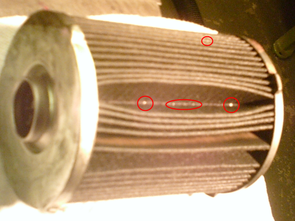

Post #22 mentions a flat cam from after seeing your video.
With 3 cylinders not operating correctly, I'm leaning that way also.
Here is what can happen to a camshaft in only 20 minutes if EVERYTHING is not correct.
Drain your oil and strain it through a paper towel or fine rag. Look for specs. They really show up with the flash from a camera. Inspect the oil filter also. Cut it open and spread the pleats out.
