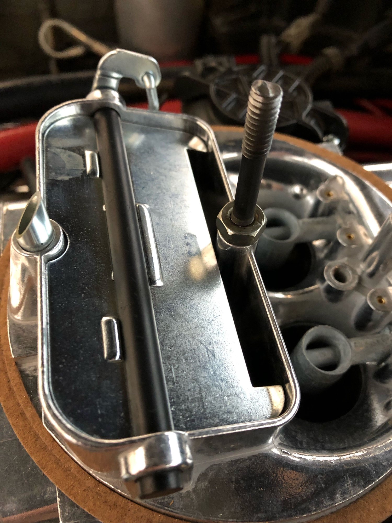

I'm still mucking about with the new Holley Street Warrior (0-80457S), especially where the choke is concerned. Since this carb doesn't have a pull off, is there any particular tuning tips to keep under advisement?

In that case, the only "pulloff" you have, is the asymmetry of the blade. It has more on the side that "vacuum" would be tending to pull down into the throttle bore. You have to balance the adjustment of the stat between the temp that it operates at and the strength that it holds the blade closed. You could drill holes in the other half of the blade near the leading edge to help it out but there's only just so much you can get out of it that way before it loses effectiveness as a choke.
It does look like it has some sort of passage though; right below the screw that's at 11:00 looking at the stat from the pass side. An electric choke needs that, to draw some fresh air in through, to keep the element from burning up.
Is the choke operation unsatisfactory in any particular way?
In the pic below note the rear portion of the blade, which is certainly unlike the blade on my previous 4160.
I think the choke duration is getting close. The fast idle, however, has issues with rising RPMs. At 1700, for example, the RPM's will rise to 2500. I reset that this a.m. to 1300 and the rise peaks at 1750. If I try to bump the throttle to bring the RPM's down, the fast idle falls off altogether and I have to feather it a bit until full warmed. Maddening.
