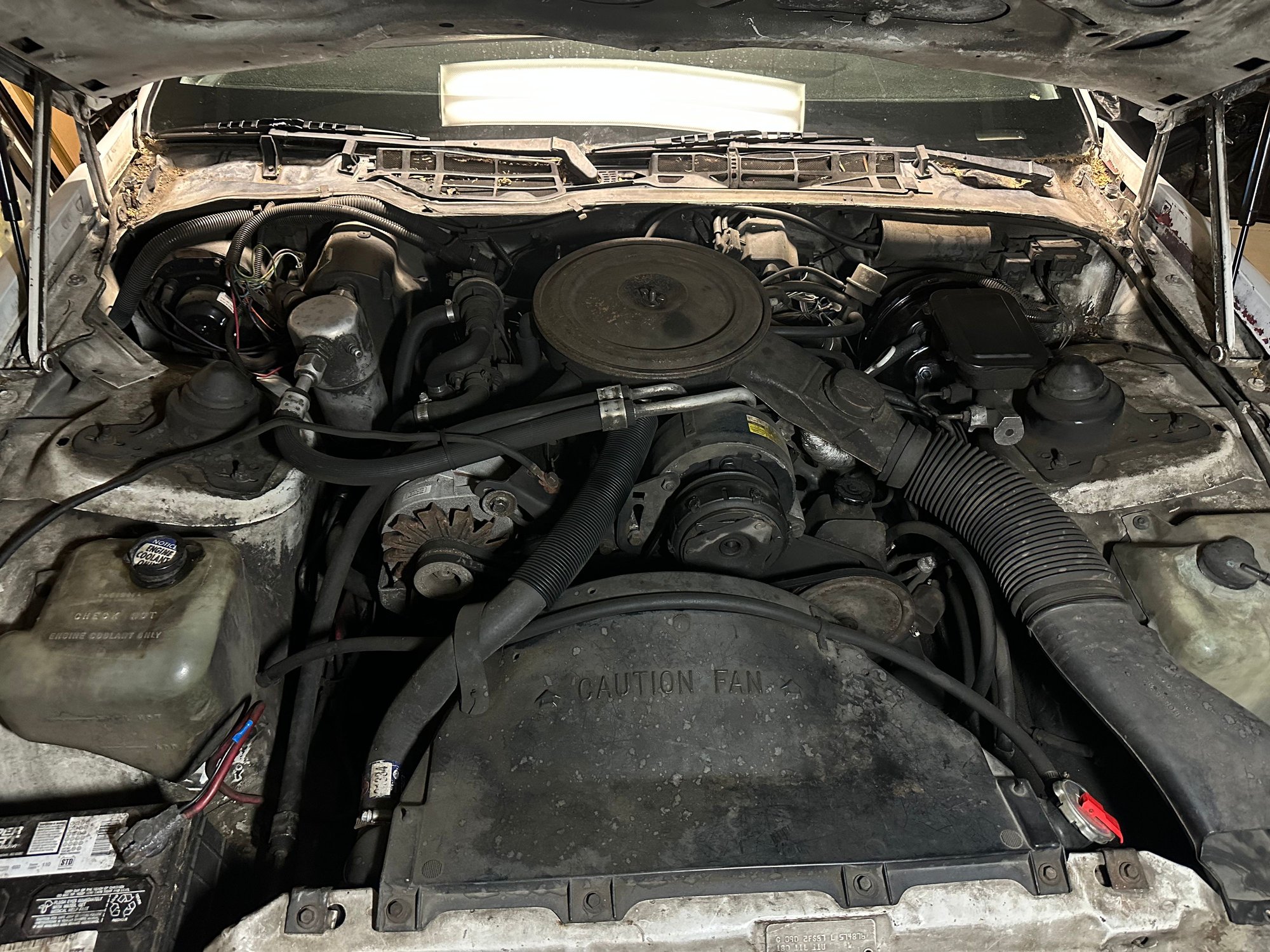

Hi everyone, new here this is my first post. Does anyone know we’re the fuel filter location is for a 1982 firebird? It’s a carbureted engine, my first time owning a car with a carb. Would like to seek some guidance on where the fuel filter location is so I can swap it out. Thanks everyone I super appreciate it!

In the carb inlet

Quote: In the carb inlet
thanks for responding! Do I need to take off the carb air filter housing? Sorry if I’m asking silly questions I’m super new working with carburetors, I see lines/hoses attached to the carb air filter and I don’t want to damage anything taking it off, but I’m gonna take a peek at it right now and try to be careful.

Re: Help with 1982 firebird fuel filter location
Yes

Quote: Yes
thank you! When I take the carb air filter off would you mind please telling me where the carb inlet location is please? Thank you so much

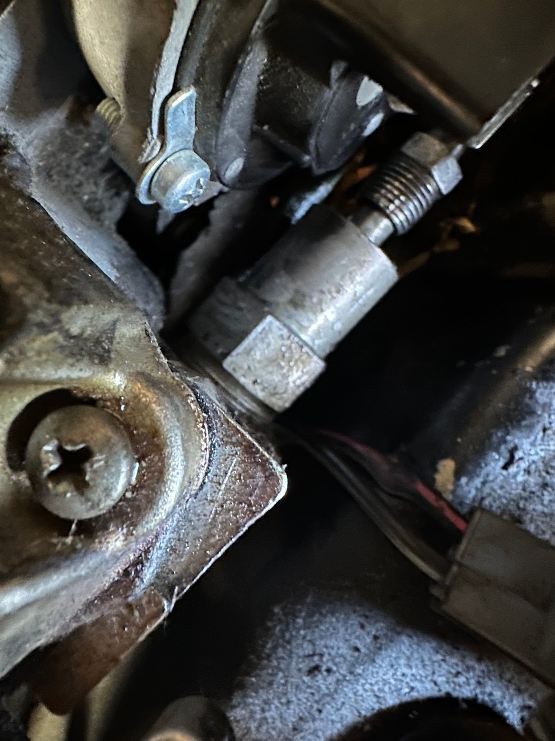

Sorry for the dumb questions, is this the inlet I’m assuming? Appreciate it so much

Apr 24, 2023 | 01:54 PM

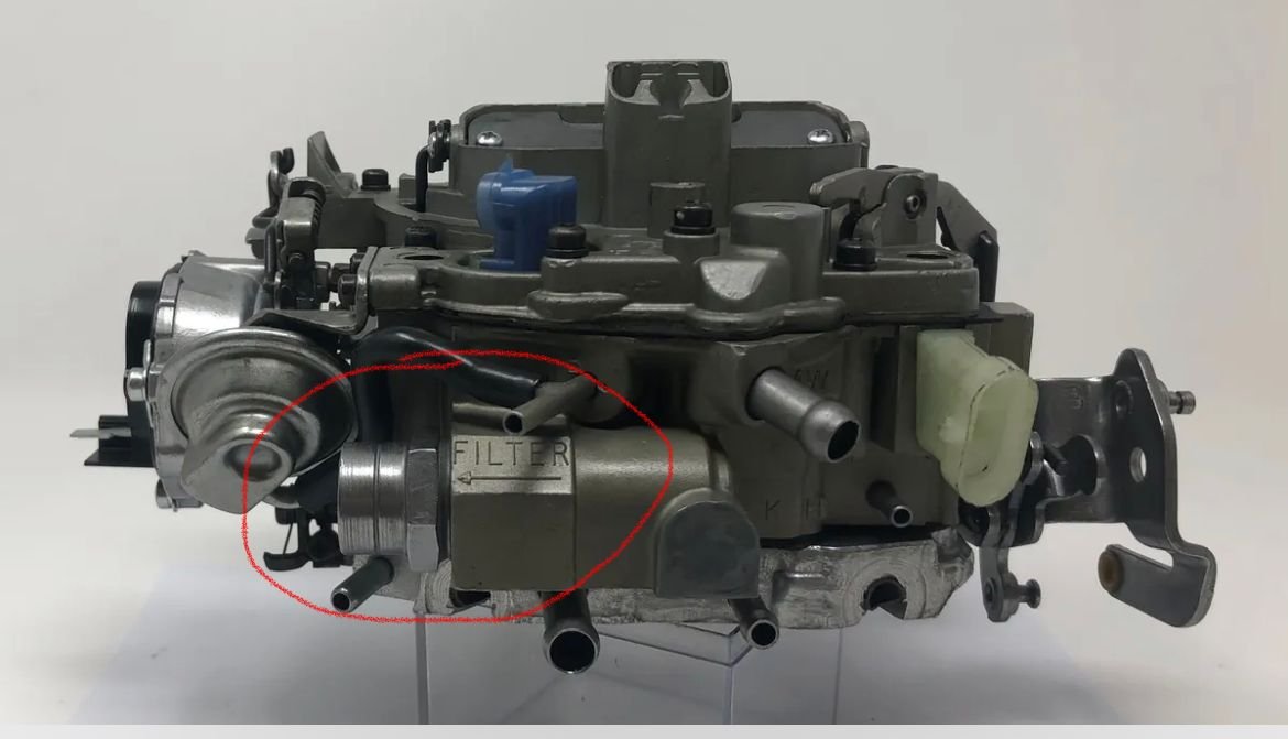

Reply 1
Apr 24, 2023 | 02:02 PM
Quote:
thank you so much for that picture, I’m trying to reference that pic with my carb but I can’t find it, I will keep searching I’m sure I will find it eventually. I really appreciate your response!
Reply 0
Apr 24, 2023 | 02:05 PM
Reply 1

Quote:
many many many thanks!!!! On it right now!! Thank you so much I’ll post an update after!

Use a line wrench and a second open end wrench to hold the nut that goes into the carburetor. Loosen the fuel line first then the iirc 7/8 nut. Change the nylon gasket as well to prevent leaks .

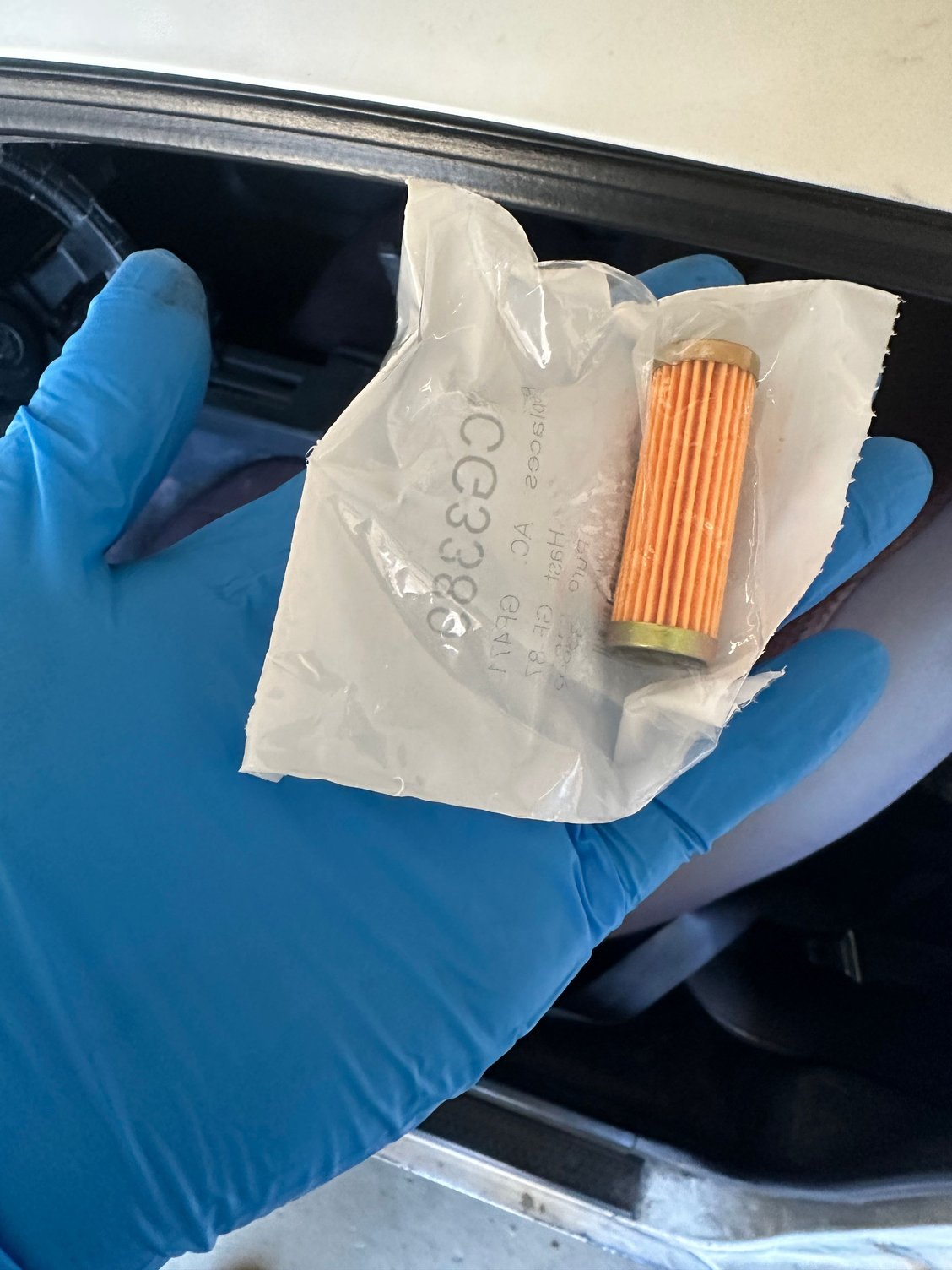

thank you so much for your help, how do I take out the fuel line nut/bolt? I got it loos but I can’t get it out now it’s stuck?
**edit/update** I got the fuel line nut/socket loose but I don’t want to force it out I don’t want to damage anything. Now I just gotta do the filter housing bolt

Good progress so far. Getting that nut out of the filter housing is about 90% of the war.
There's not a filter housing "bolt", just the housing. The large hex on the thing the nut screwed out of.
Tuned's photo is a 4-bbl, which you have the 2-bbl so it's not the same. Similar in principle but not exact.
Your new filter is different on the 2 ends. The end with a metal cap goes against the spring, which goes back into the carb first. The end of the filter with a rubber gasket looking part faces outward.
When you put the inlet piece back in, be VERY CAREFUL not to cross-thread it. Start it into the housing at least 2 full turns with FINGERS ONLY, no tools. Same for the nut on the line. Tighten the inlet only to about 5-6 ft-lbs. Then when tightening the line nut, hold the inlet still with your open-end wrench.

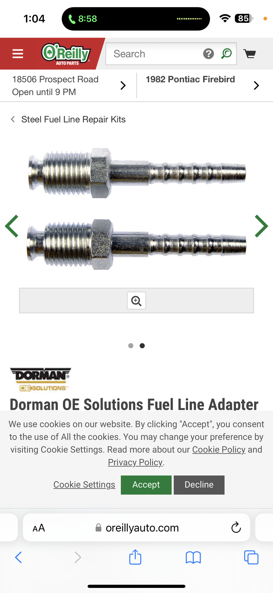

Thank you for your help. I ordered this, should be here tomorrow early morning. I don’t need that much line but I feel safer having more than less line. Now that you said it I should have just got an adapter and used a rubber fuel hose. I got a rubber fuel hose as well from oreily the brand is master pro and got some clamps when I ordered the repair kit in the photo earlier today. I should have just gotten the adapter and called it a day and put it back on. I’ll post updates and progress and see how this all pans out.

Sheesh! For a few bucks more, you could have gotten a whole new fuel line from pump to carb at Classic Tube...

Hi everyone, the adapters that I got from Oreillys the fuel line bolt is a tad bit to big to fit the filter housing thread. Can anyone provide me with a link with the correct proper fittings adapter that will fit the filter housing thread? Thanks! The one in the photo below is the one that is to big.
Reply 0
Apr 26, 2023 | 12:41 PM
Take your original fitting (you have to cut it off anyway) to your local auto parts store and match it up with a new fitting. Or; if that fitting is not stripped, use that on a new piece of tubing...
Reply 1

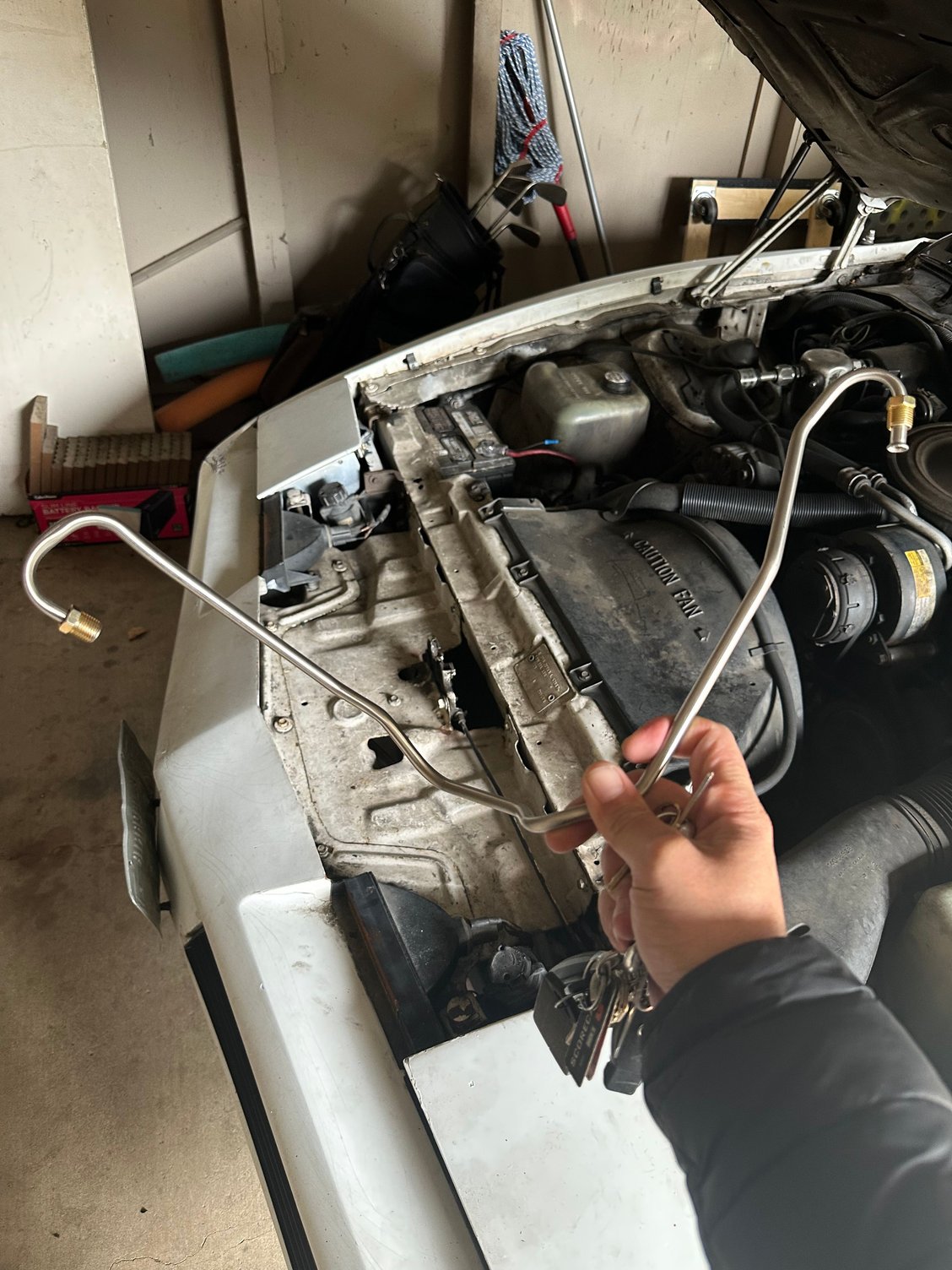

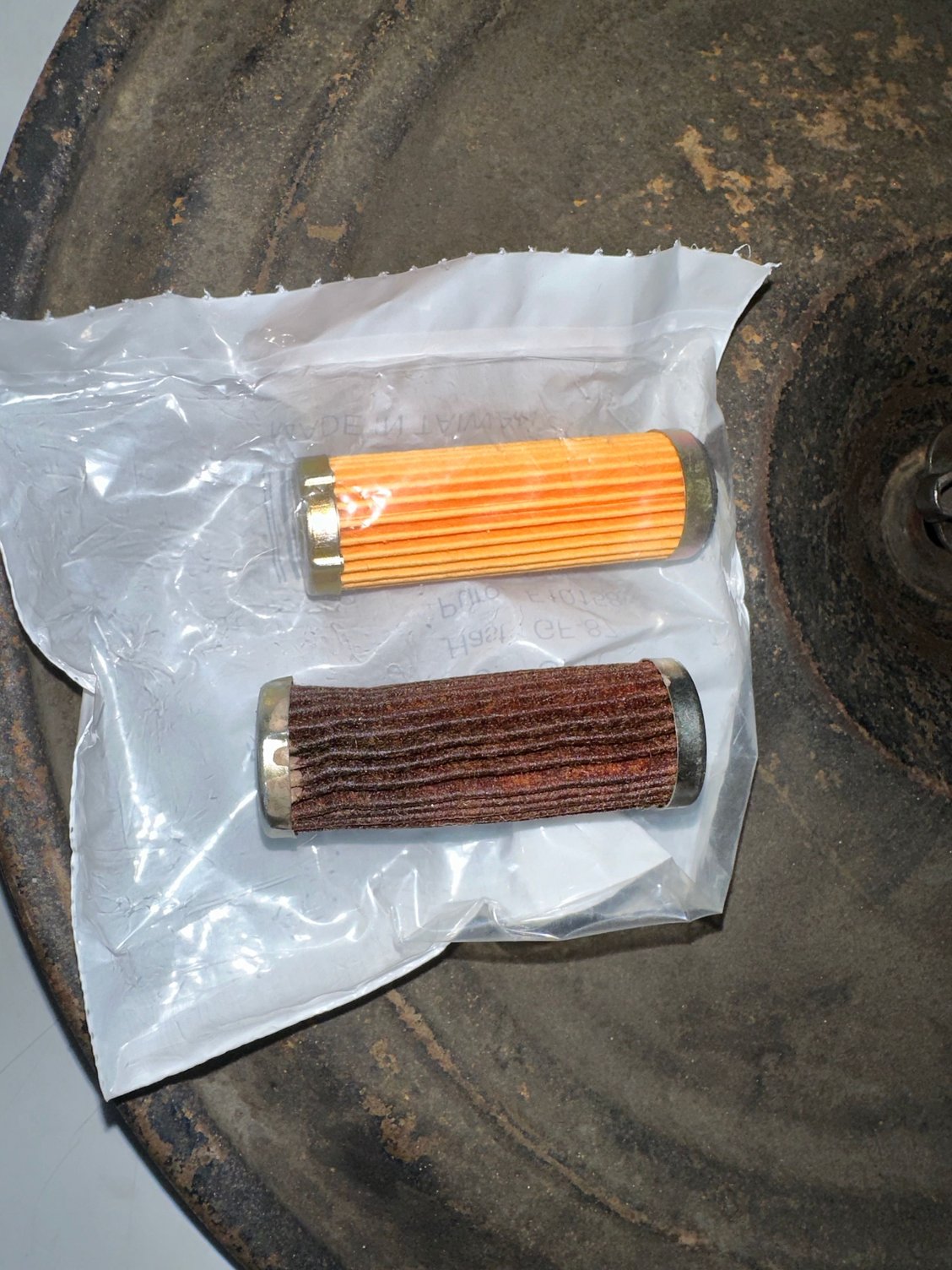

Hey everyone, the fuel line came today from classic tube
This weekend I’m gonna plan my point of attack to get this done myself 🧰

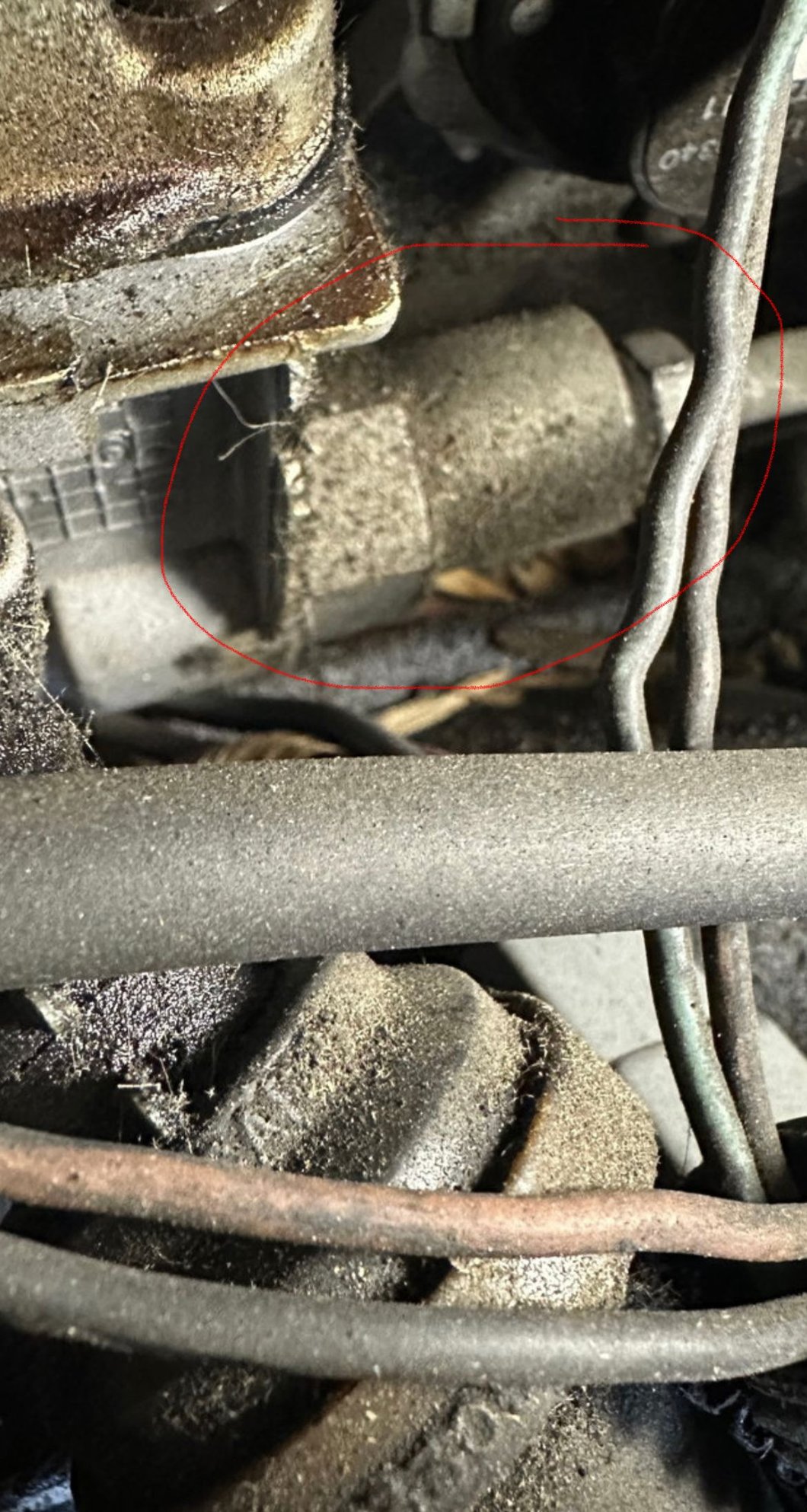

Here’s the picture of the old fuel filter that I installed previously and I put a new o-ring on the filter housing as well
ill keep everyone posted and updated on how this goes, thanks again

When you install it, use anti-seize liberally on the nut threads, and on the inside of the nut where it grips the line. No need to use Teflon tape on threads; they aren't what seals; the flares on the end of the lines, and the matching shape in the fittings, are what provides that service.
That old filter DEFINITELY needed some love, that's for sure.
Reply 1
May 5, 2023 | 07:35 PM
With that new fuel line, NOW you will be able to do the job correctly.
Don't be afraid, it's not that hard. Get it right and you will build the confidence to tackle the next job.
You will most certainly have to remove some other components and bracketry to R&I the new fuel line.
Use your cell phone to take many pictures along the way.
Good evening everyone! Great news! I finally was able to install the fuel line! I took my time, I went super slow and steady so I knew how to put everything back correctly, properly, and made sure I didn’t cross thread the fittings or twist any lines again. I want to thank everyone here for giving me the confidence and guidance for directing me to the right path! Now I can feel safe and secure when driving the car and don’t have to worry about any fires! Thank you everyone so much again! I greatly appreciate you all!
Reply 2
