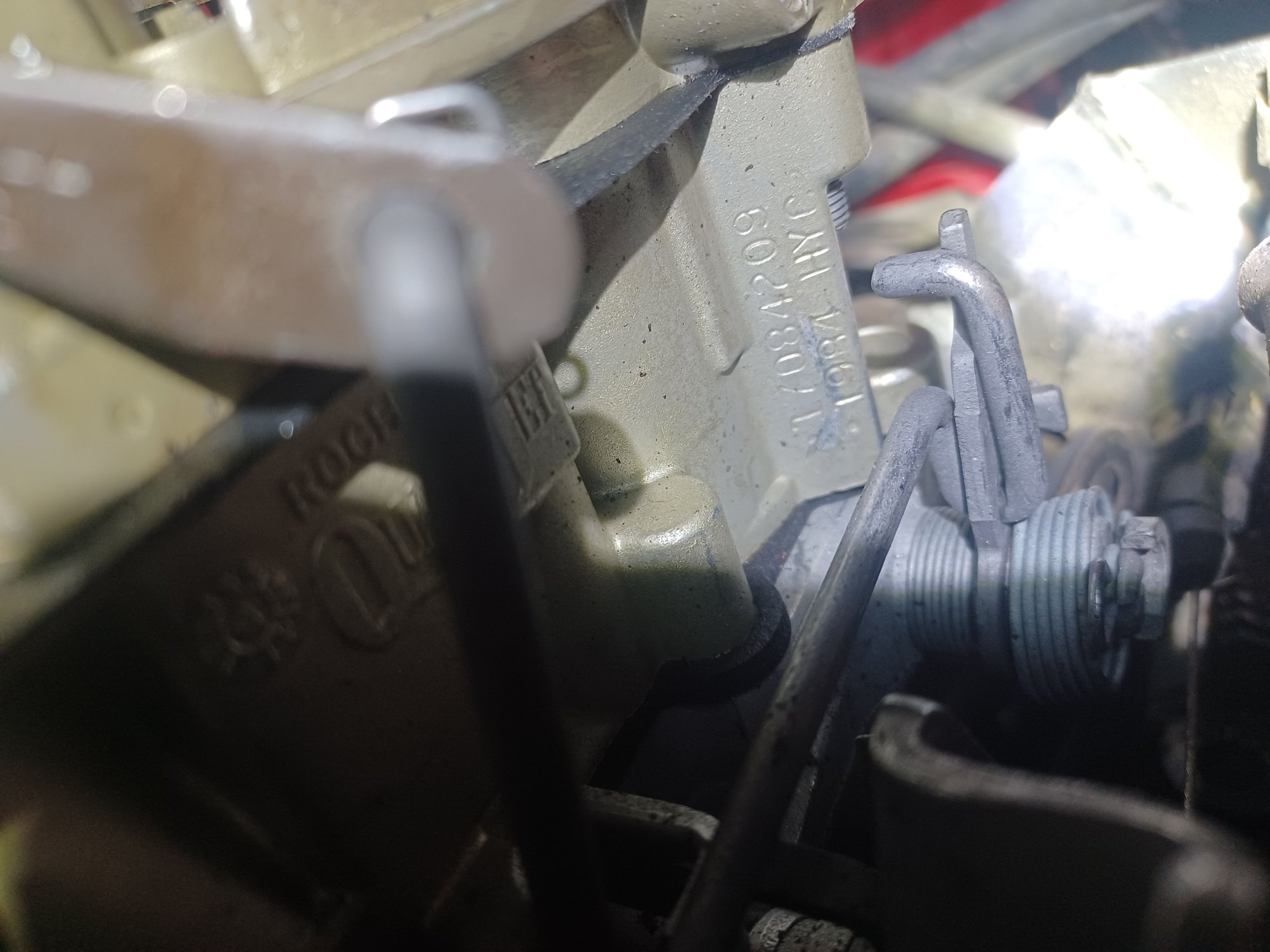

As of recently ive been restoring an '84 Trans Am and have recently replaced the quadra-jet with a reman'd quadra-jet 'UREMCO Remanufactured Carburetors 3-3699', but after looking through the forums about the differences between the stock LG4's and L69's which my car comes equipped with, I was wondering if the original carb in theory could be a better performer then the reman'd carb I bought if properly rebuilt.

What's the Rochester number cast on the carb. They could've slapped anything in the box. Post a picture maybe?

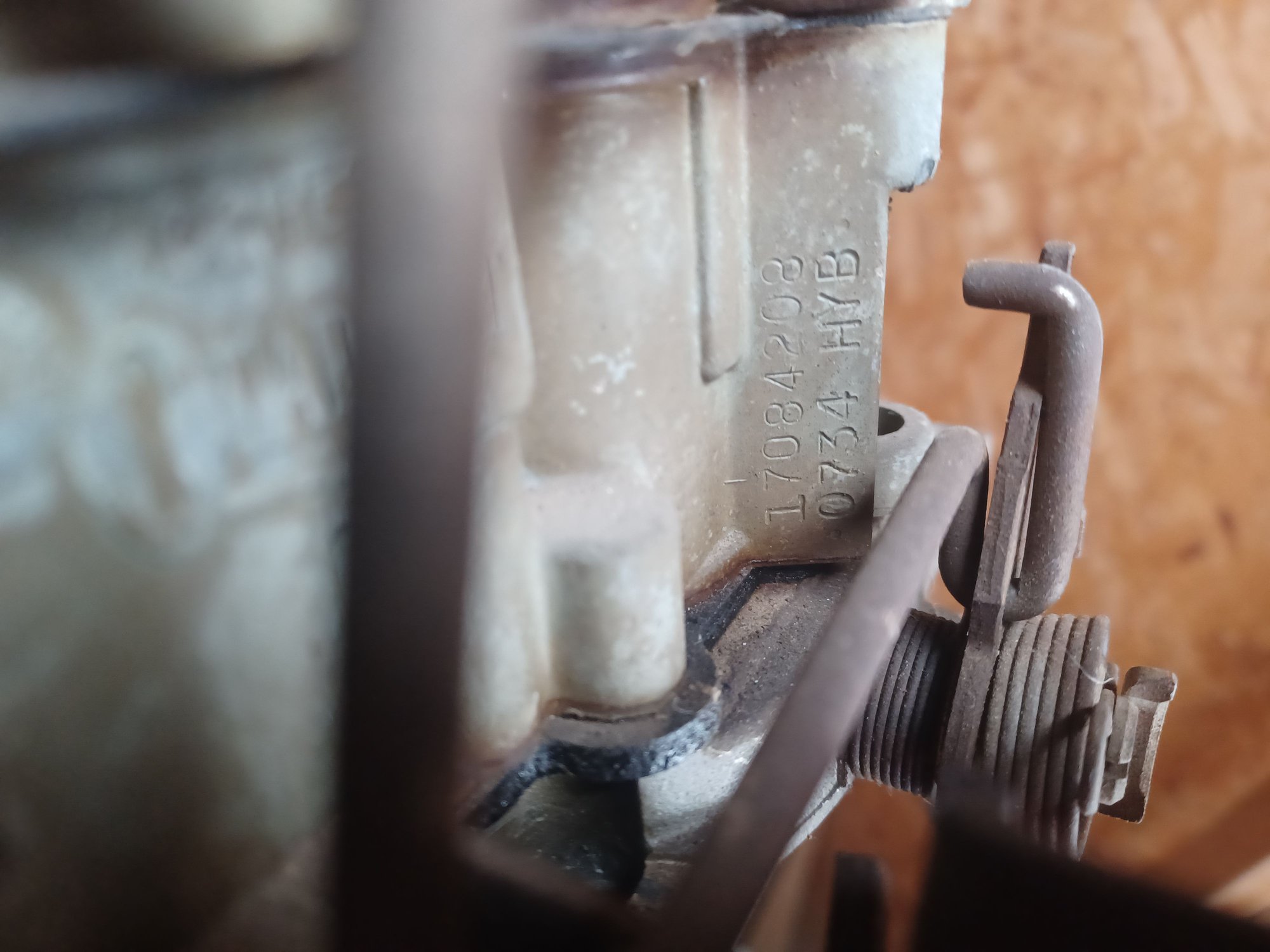

Sorry about that, current reman. is the first image, stock is the second.
​Reman.
17084209
​​​​​1984 HYC
Factory
17084208
0734 HYB

I'm betting the only difference is that one was originally on a manual trans car and the other an automatic. Are the vacuum ports the same? Other than that, the jets are probably the same and it probably is functional indifferent.
^^^ This ^^^
Odd #s are for one, even for the other. My CRS syndrome keeps me from recalling which is which.
That said, if you'd ever stepped into an auto parts remanufacturing plant, you'd know how meaningless those #s are on a "rebuilt" ANYTHING. They tear em down, all the [one thing]s go into one [bin barrel box basket bucket whatever] to then be sent through their [stripping cleaning sanding polishing straightening screw-hole-tapping whatever] process(es), all of another [thing]s go into their whatever to get whatevered, and so on; then at the end they grab one from bin A, 2 from basket B, 1 off of pallet C, and so on, and slap em together. To some limited extent, they sometimes have records of identifiable parts (jets & rods for example, which have their numbers stamped on them, and can thus be more readily matched back up to the finished assembly) butt if they can't find a pair of whatever size or the right whatever, they'll just use whatever CAN find that's the closest. Keeping in mind of course, that the condition that THE CORES come to them in, kinda limits the condition they can GO BACK OUT in. Like, if some core came in with an ear broken off of the throttle plate, they can't rebuild that one; the fuel bowl (the thing with that # stamped on it) is now orphaned. Or, if that part # calls for 72 jets, butt they tore down a core with that # that they had for it and it had 1 76 and 1 71 in it and that's all that's in the basket, there's not alot they can do, if there aren't any 72s there. You might end up with 2 73s or some such, if you're lucky. If you're REALLY lucky, they'd adjust the rods they put in it, to roughly match the jets. Butt who knows.
This by the way, is why it's SO MUCH CHEEEEEEEPER to buy a "crate" motor for example, than to have "your" [short block, or heads, or yadda yadda yadda) "rebuilt" and returned to you intact. Costs come WWWWAAAAAAAAAYYY down by using mass production techniques. You can't mass-produce qty 1.
At this point, if you're happy with how it runs, best to just leave it alone. There's NO TELLING what you'd end up with if you took it back and asked for "the right" one. Don't poke the bear.
