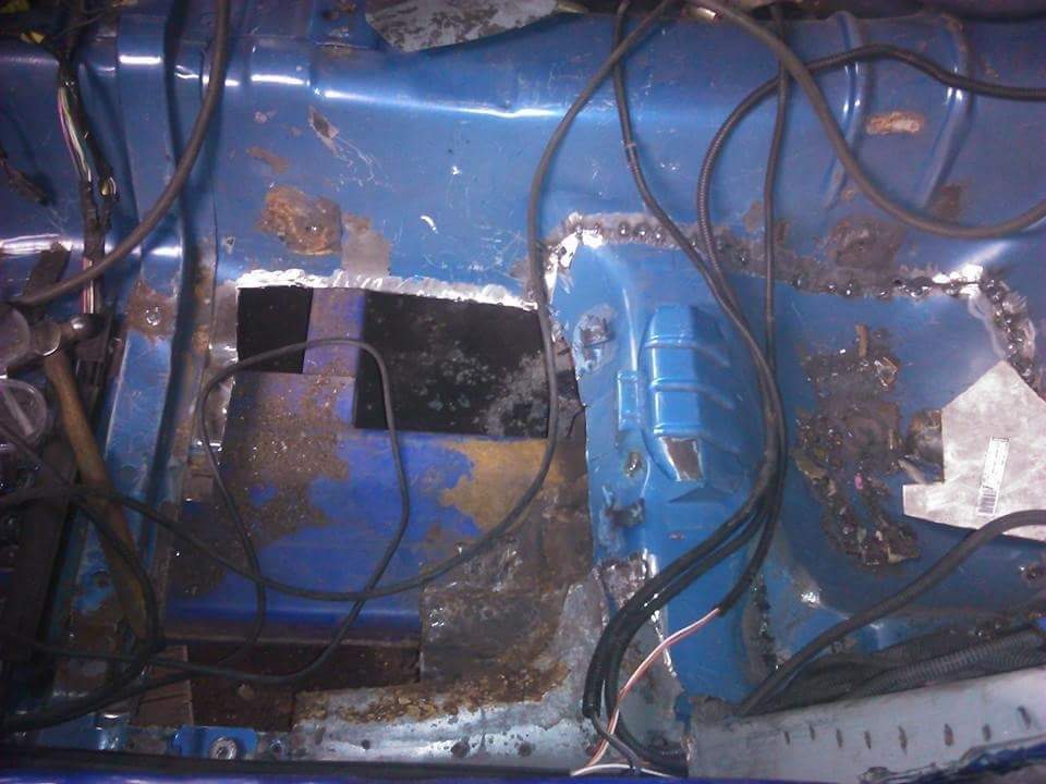

Ok, to go back a little bit, Here are some more pictures of the rust repairs. I don't have a good picture of the rear seats cut out, but once I finish sealing the joints I'll get a picture of the seals with the sealant.
passenger side rear wheel well rust patch almost complete
one of the patches in the rear wheel wells
Drivers side rear wheel well rust repair continues
Rear seat pan welded in place. Still needs foot area installed
Most of the rust is cut out.
Driver side rear wheel well after body sealant but before under coating.
Front of passenger side rear wheel well after body sealant but before under coating.
Back of passenger side rear wheel well after body sealant but before under coating.

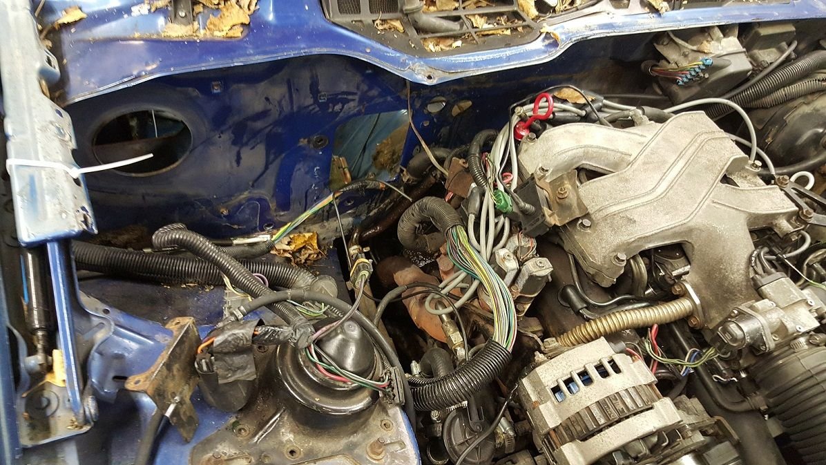

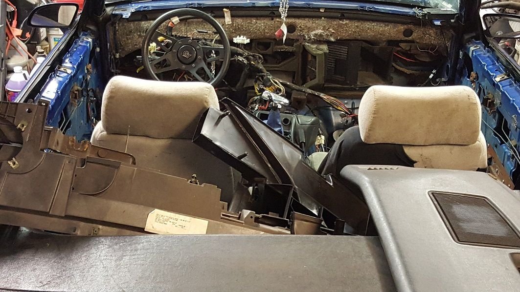

And then this is the latest. I fully removed the dash to swap out the heater box, controls and blower box with the working one in the hard top. I am also going to do some wiring upgrades while I'm back here.
128 days left till the deadline to finish all major projects.
