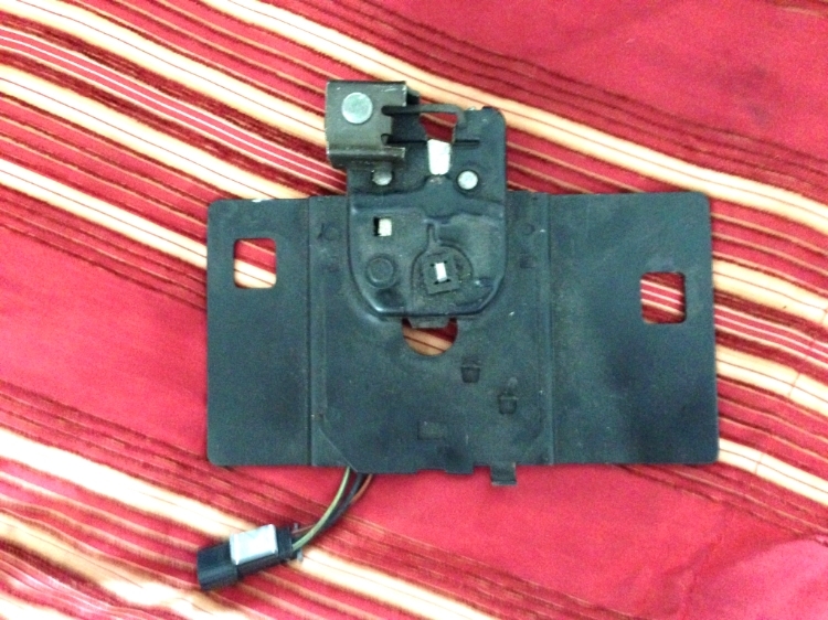

I sold a slam style off of a '92 vert on this board not too long ago...;
