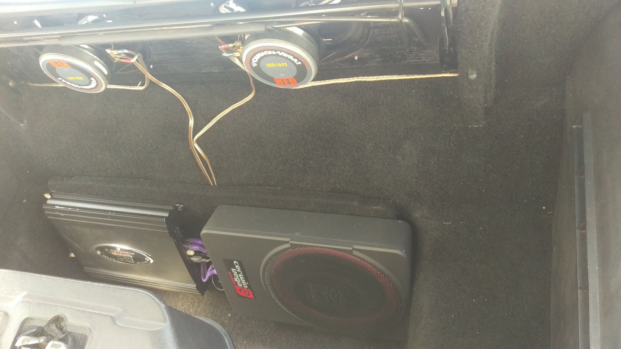

Not much room back there.I tried to fit a single 12" sub, but decided it would take up too much space.Went this route instead.

What is that thing called? And how does it compare to a normal sub box?

Cerwin Vega VPAS12, there's also a VPAS12st.Doesnt thump like my old 12" CW subs, but combined with the 6x9s above it.The trunk works like a box of sorts.I dont crank it up like i used to, but the bass is more than enough

Yeah, half size.Try getting a full sub box with two 12" in there.Even the cargo lid with 2 subs is a pain.Let alone trying to use it.

Partly why i chose that vega thing.It does the job fine and i wasnt willing to loose what little trunk space a vert has.
