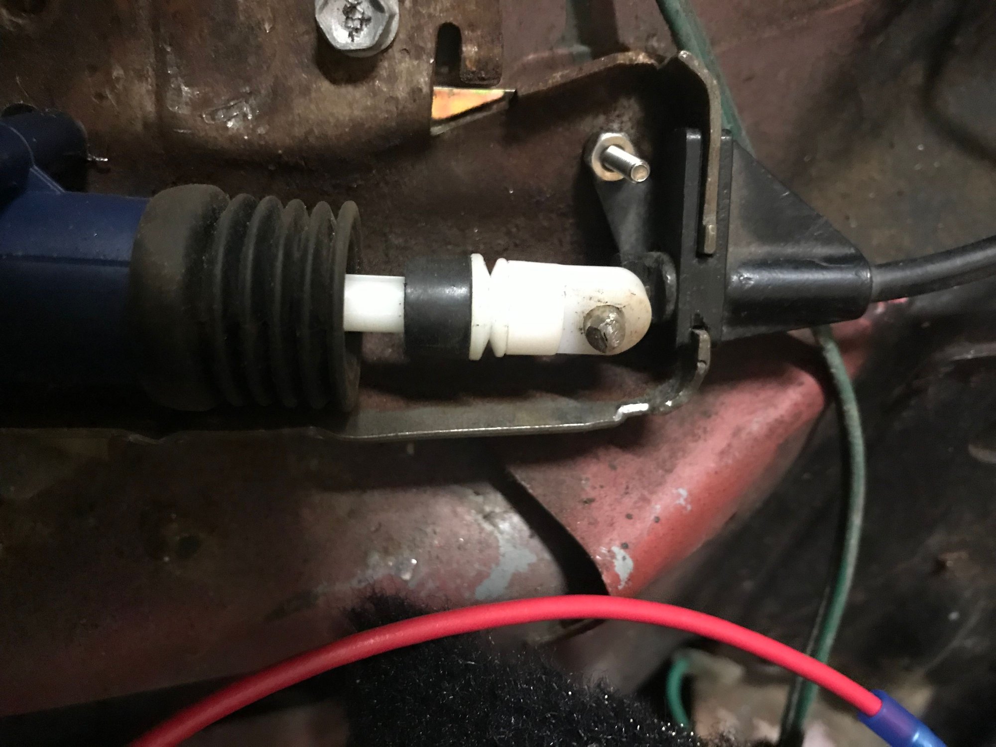

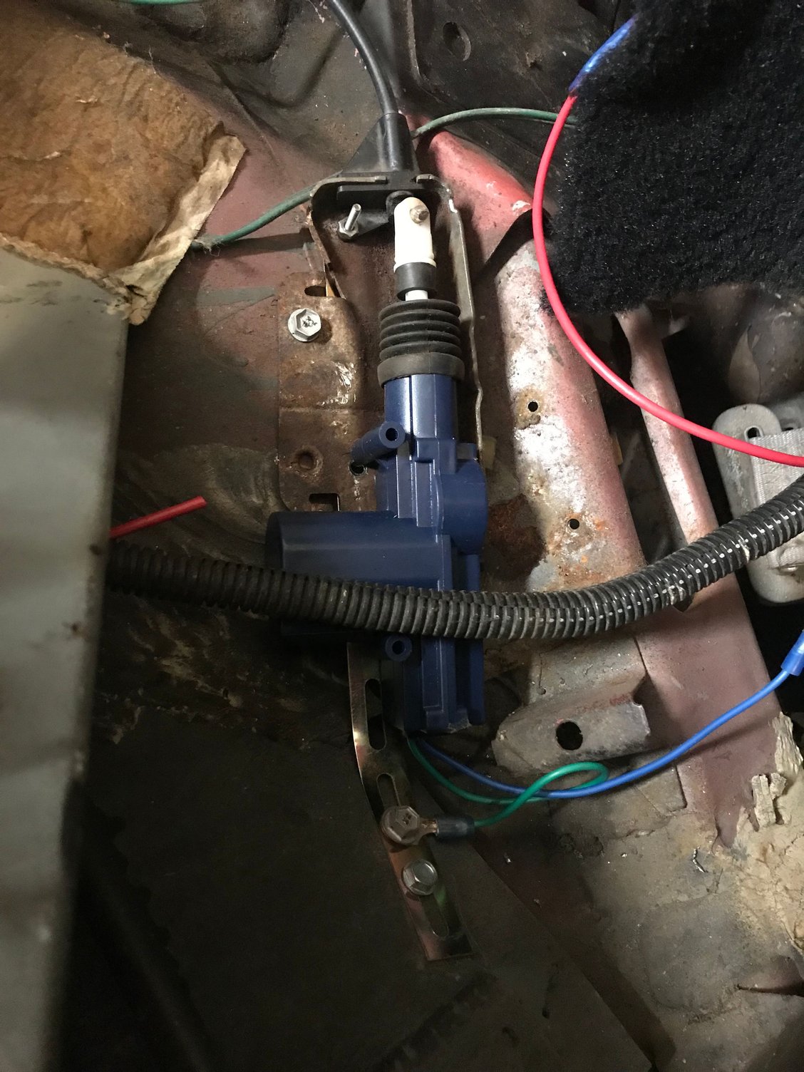

With nothing to lose, I decided to try a universal door lock actuator and it seems to work fine. Not the prettiest mounting but it’s hidden behind a panel and cost $5 for a replacement if it fails so it’s worth a shot.

the actuator was an extra I had around from a power lock install. I’ve used them on non power cars and as a replacement for expensive actuators on other car. I’ll get a pic later of the one I put in
but they are around $5 on eBay/ amazon

Not really much bigger a, just a different shape. It is 2 way, push and pull depending on polarity. Not sure on strength but I have used them to add power locks to non power doors and it will move all the linkage enough to work.
I did not mount in the original location due to size but with the cable it is easy to move it out of the way to mount. I used the original cable and cut the end off the actuator.
I had it laying in a drawer and the old actuator was toast so I have nothing to lose.
I saw a few used ones online for $75-100 each, so as long as this works for a while, I will be happy with it. My car is no show piece so it doesn’t have to be 100% correct
