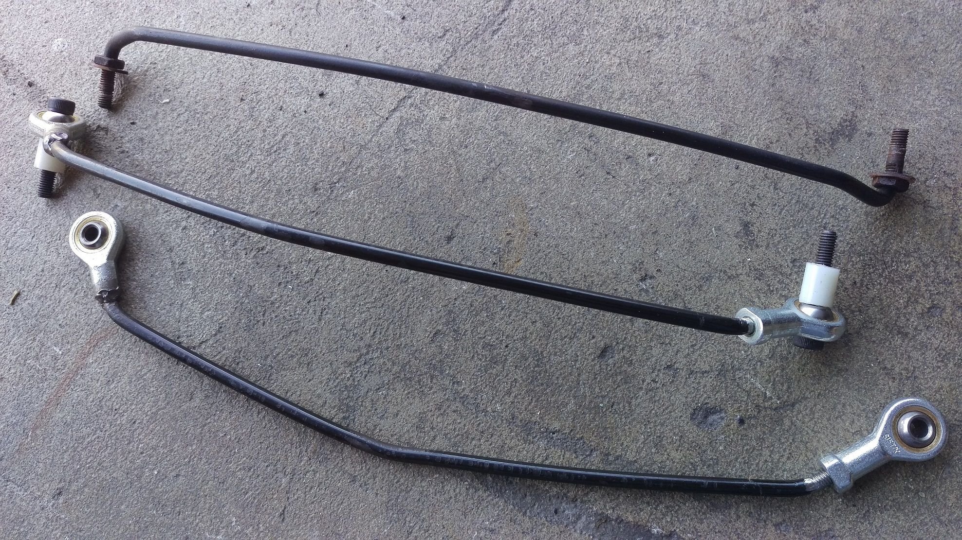

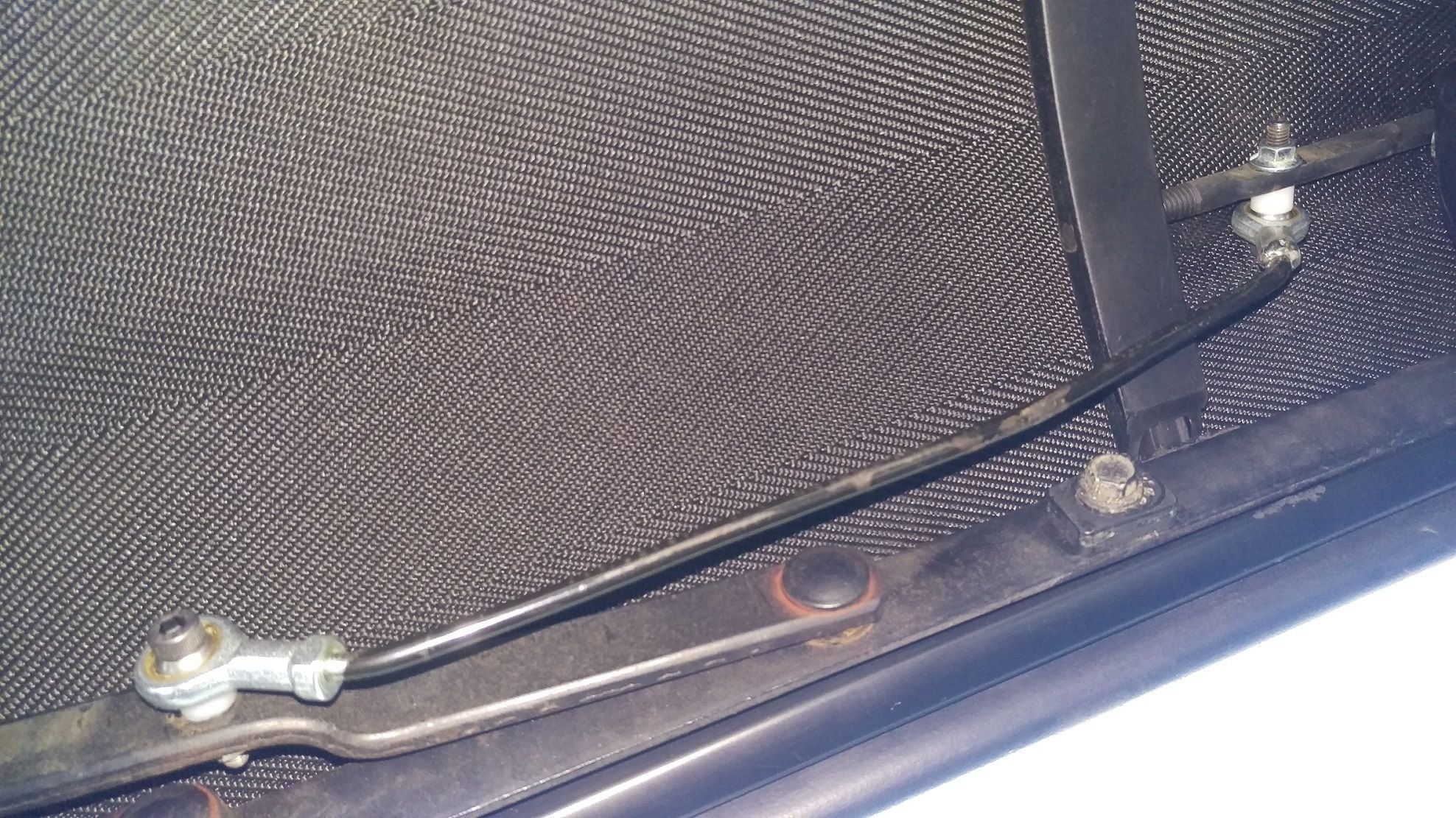

84 1LE's Avatar
Joined: Nov 2002
Posts: 6,667
Likes: 414
From: Oyth
Car: 89RS vert
Engine: Erod
Transmission: 4L65e
Axle/Gears: BW, 3.27
Re: Flip rod problem
I did this (pic) after i bent mine too. About half way up after unlatching the front while trying to lower it into the storage. The top stuck, i forced it a bit and that bent the fliprods. Now i just make sure not to force it too much. I think the way the rods are stock causes that sticking point...maybe, idk, but ive been good since.
Stock rods w/ the ends cut off. One side is threaded for adjustment, the other is welded on.

Garfilds's Avatar
Joined: Nov 2020
Posts: 5
From: Riga, Latvia
Car: 1991 Camaro convertble
Engine: 305 TBI
Could someone take a picture and insert an image with the placement of these mounts. My car roof is without them and I don't know how to mount them properly.
