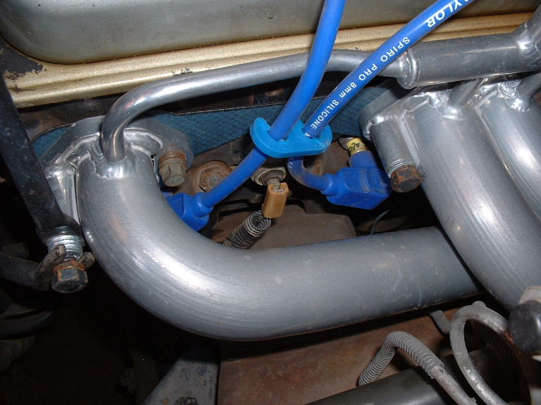

temp sender

Nice I got it. Thanks for the help. That wire that is there goes to the temp sensor.
