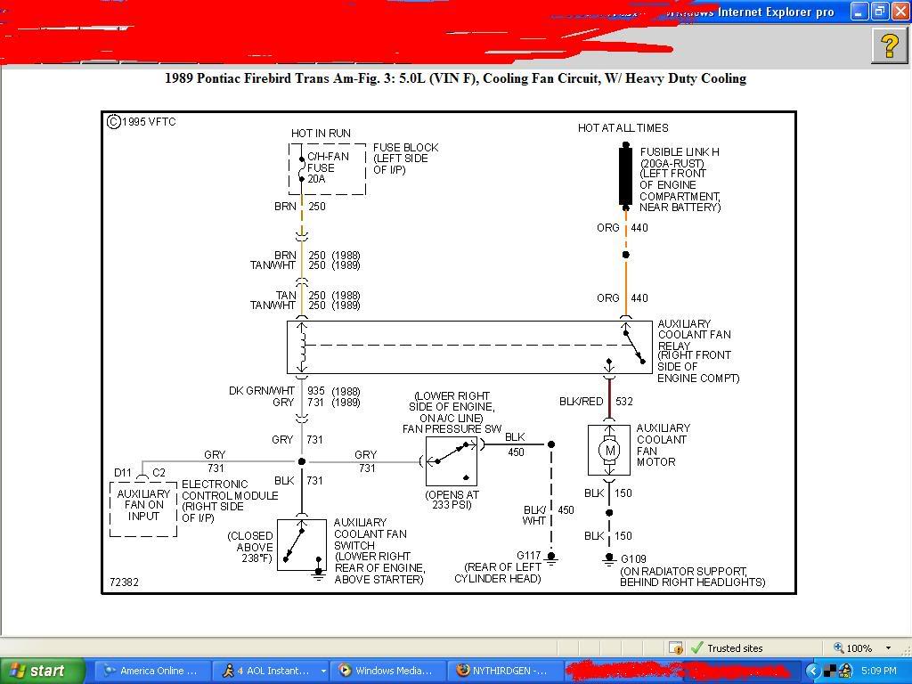

Hi All
I have a 91 FB and the fan is not coming on.
After idling the car for about 5 minutes, I hear a click up front and the check engine light comes on and stays on. I figure this must have something to do with the fan coming on.
The fan fuse is ok. Tried a new fan and same result.
The temperature gauge rises accordingly whilst idling. When I drive the car around the temp is at about halfway.
Is there a relay that may be the problem?
Cheers Tom

Can anyone tell me whereabouts the fan relay might be located? Is there something else I'm missing?

It is on the firewall on the drivers side..
This is a diagram from an 89 sure it is probably the same

Check on the driver side firewall. The oval type fuse should be the fan control relay. I recently replaced mine. My fan wouldn't shut off.

Figured it out, there was an orange wire off by the battery. Fan seems to work fine. Thanks everyone, cheers Tom
