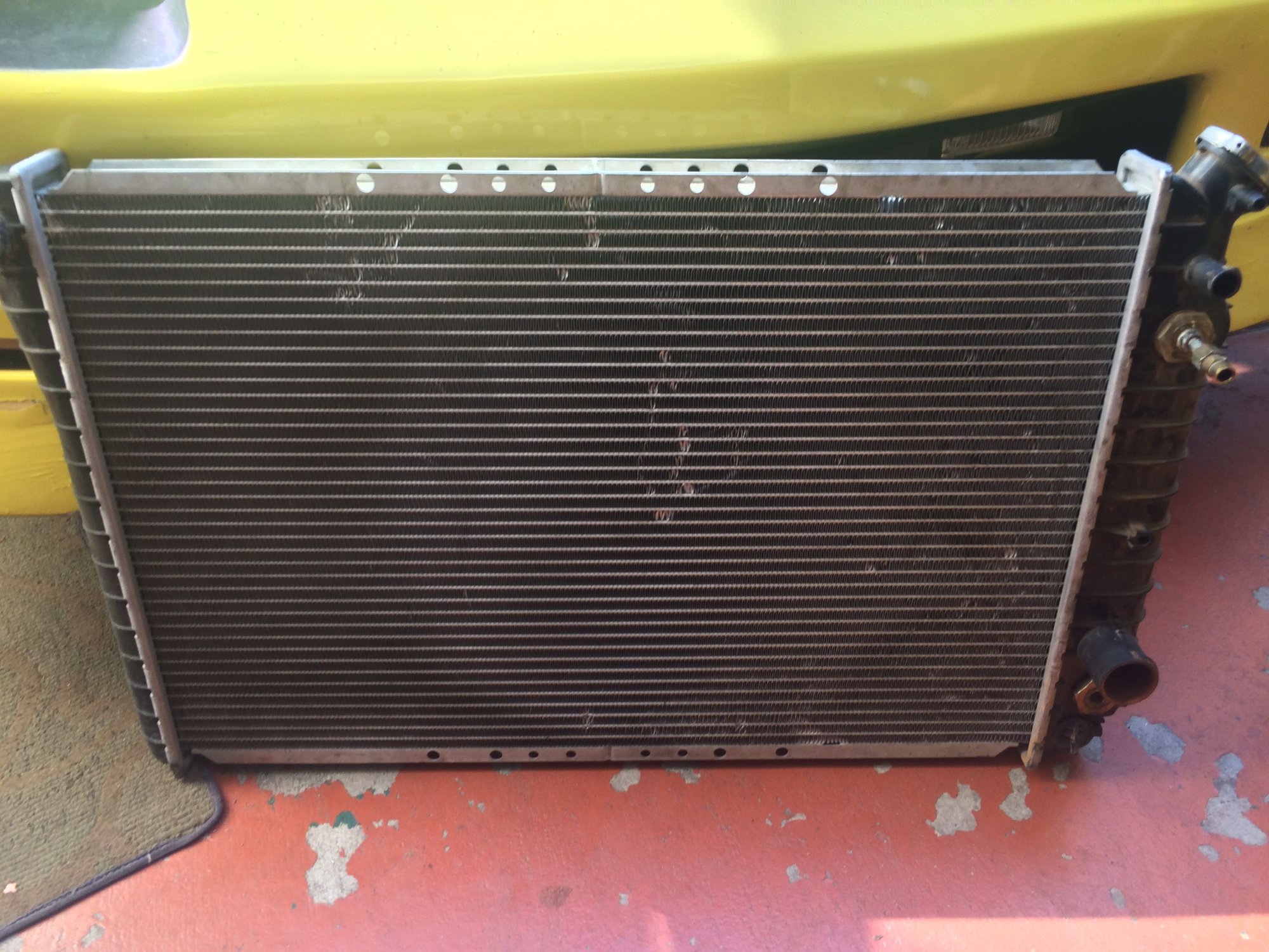

Mine just sprung a leak from the very top. A misty leak, and maybe in a few spots.
Closest to the Radiator cap, front end side of the radiator, just under and in the radiator, near the very very top right under the first weld from the passenger side. Maybe a busted fin? Either way, I can't repair it without removing and having the top removed. It being my daily, I think I'll just run the radiator low for a while.
Any quick way to have this fixed?

IDK if there is an epoxy that would work on aluminum. Possibly give a rad repair shop
a call & ask, then when things work out, take it to them for the correct fix?

I would have to drench the epoxy in there, since it's such a tight area. We'll see how the ride home is with it drained a little.

You need to have it tig repaired properly to cure the leak-no epoxy will last. Why would a company NOT pressure test their own custom radiators when they are obviously pretty nice quality?!? Northern radiators is based out of Wilmar, MN and has manufacturing facilities in Canada, US and Mexico so its a toss up where they end up getting your radiator from. I'm a dealer for Northern and for the money, I haven't ever had an issue with them.

Ride home was fine. Drained it a little and had the fans turn on sooner. For now, as my daily driver, this will have to work.

Unfortunately the repair shop (only one recommended to me) Erie Shore Radiators, says they can't fix the leak due to a crack in the header. They offered a new one of the same size/core etc...for $365, and will take a couple of days to get. I'm unsure considering I don't have a part number for this new radiator, who makes it, true sizes or even the look of it. They just said one like it for $365. IDK guys let me know. After all this time this radiator ends up being a $400 PITA POS lol ;P smiles. Used it for a couple months and it's done, that tells me, cheap. Others holding up just means quality assurance is just high enough to be positive in the market. Grr.
So can someone tell me how a leak in the header of a radiator can occur? Maybe real cold to real hot too quick or vice-versa? Trying to figure out what I can do now. Just bought new hoses and fluids for the whole car.
