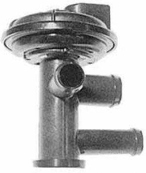

is the vacuum line to the heater bypass plugged in
in the pic there a heater bypass value and a line goes into the top of it

Re: hot air
yes it is plugged in . it does have vacuum . and i did replace it earlier thinking that might be the problem

Re: hot air
well it maybe stuck open or the value inside is bad
and also so see if the ac switch in the dash needs to be replaced maybe its not closing the bypass value
