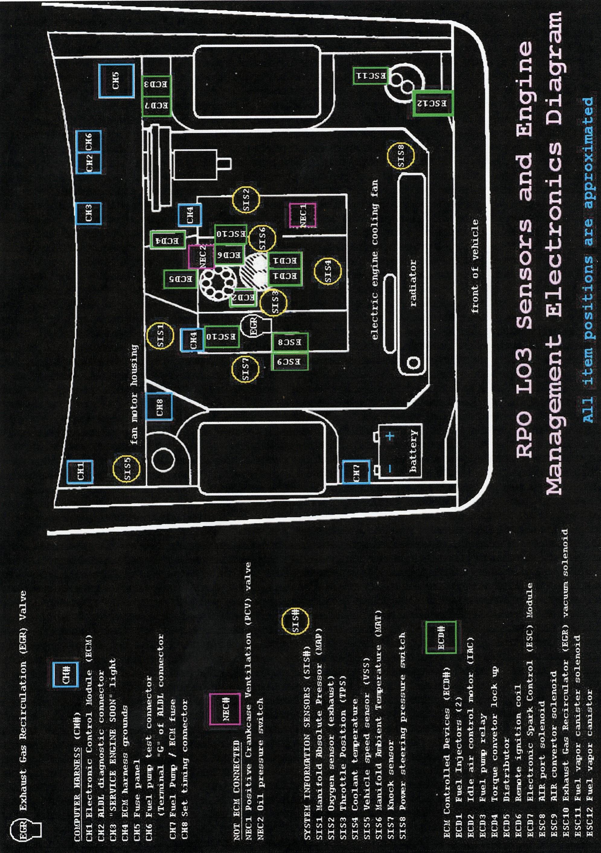

PS. Sending you an Attachment of the Engine Electronic Diagram for the 305 TBI (L03). May help you in the future. Good Luck.
