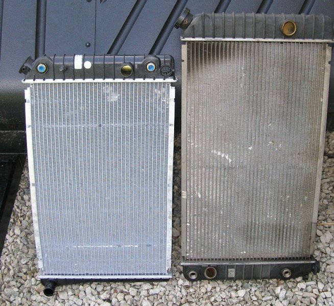

Well it work as good as the stock radiator?
i mean its smaller and was designed for a corvette which has way higher performance then my camaro RS
i added a picture the vette rad is on the left

Old Jan 19, 2011 | 04:42 PM
Mad_IROC-Z's Avatar
Joined: Mar 2010
Posts: 474
From: In my garage next to my car
Car: 89 Red IROC
Engine: 5.7
Axle/Gears: 2.77
Re: Wrong Fan?
I would also imagine that some of the ducting and baffels in the Vette design also help with that car.
You want better cooling, install the heavy duty dual fan set up.
I have the dual fans, 195 t-stat and the low-Low temp fan switch (176 degree I think). It takes being stopped in traffic in the heat of the summer and the AC on to reach 220. And 220 is not over heatting
