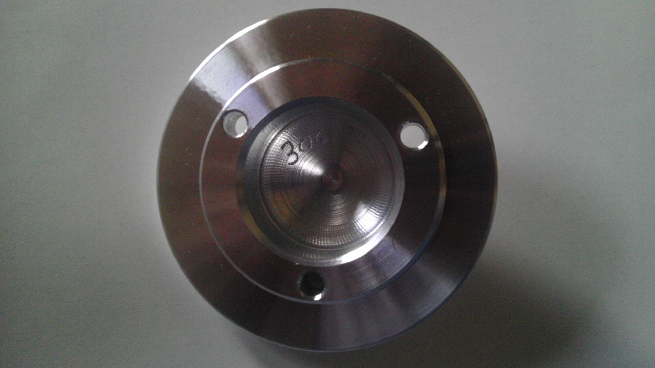

WOW, the quality of March Performance is Amazing...
Attached Thumbnails Mounting of a CSR Electric Water Pump-march-performance-306-front   Mounting of a CSR Electric Water Pump-march-performance-306-back

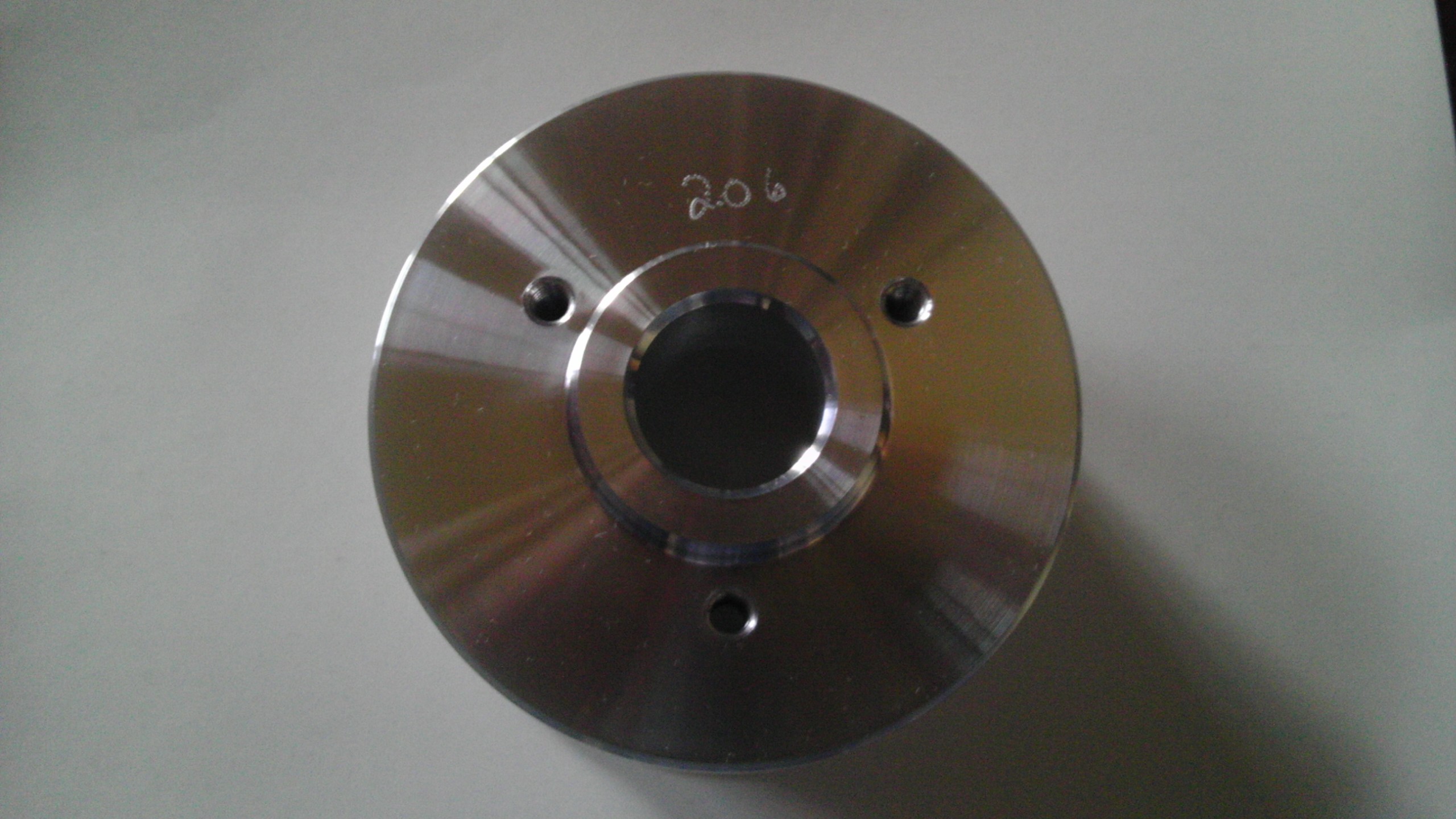

Re: Mounting of a CSR Electric Water Pump
Attached Thumbnails Mounting of a CSR Electric Water Pump-march-performance-221-front   Mounting of a CSR Electric Water Pump-march-performance-206-front   Mounting of a CSR Electric Water Pump-march-performance-206-back
