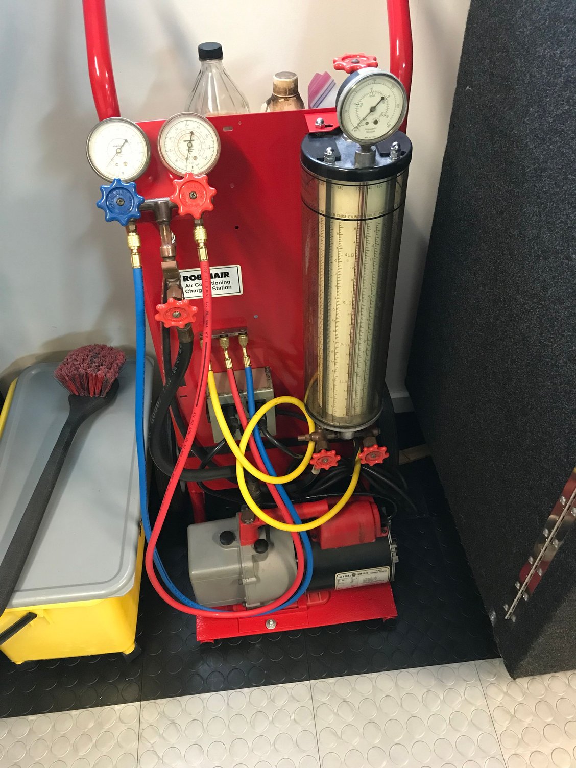

I bought this and a 25 lb tank, took it all apart , had it blasted and powder coated. All new hoses too. Found a Qt of GM R12 oil , I have my own personal hole in the ozone layer lol
hunt a tank down in Europe. It’s everywhere.
if yiu buy in in another country, do yiu have to get Z papers for it Ya?
