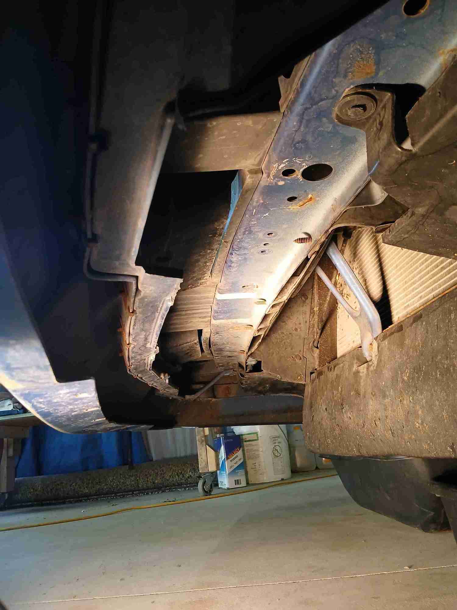

Does the plastic piece that red arrow points to help in cooling the radiator? It is not on my car. What happens if it's not there?

It's damn near critical. Think of it as a ram air for the radiator.

i realized after paint, i never put my piece back on mine, 91 camaro, and i had overheating issues, i got it back on now, but waiting for new fan motors to be delivered, between the fan motors, and having that piece back on now, i hope my issues are resolved

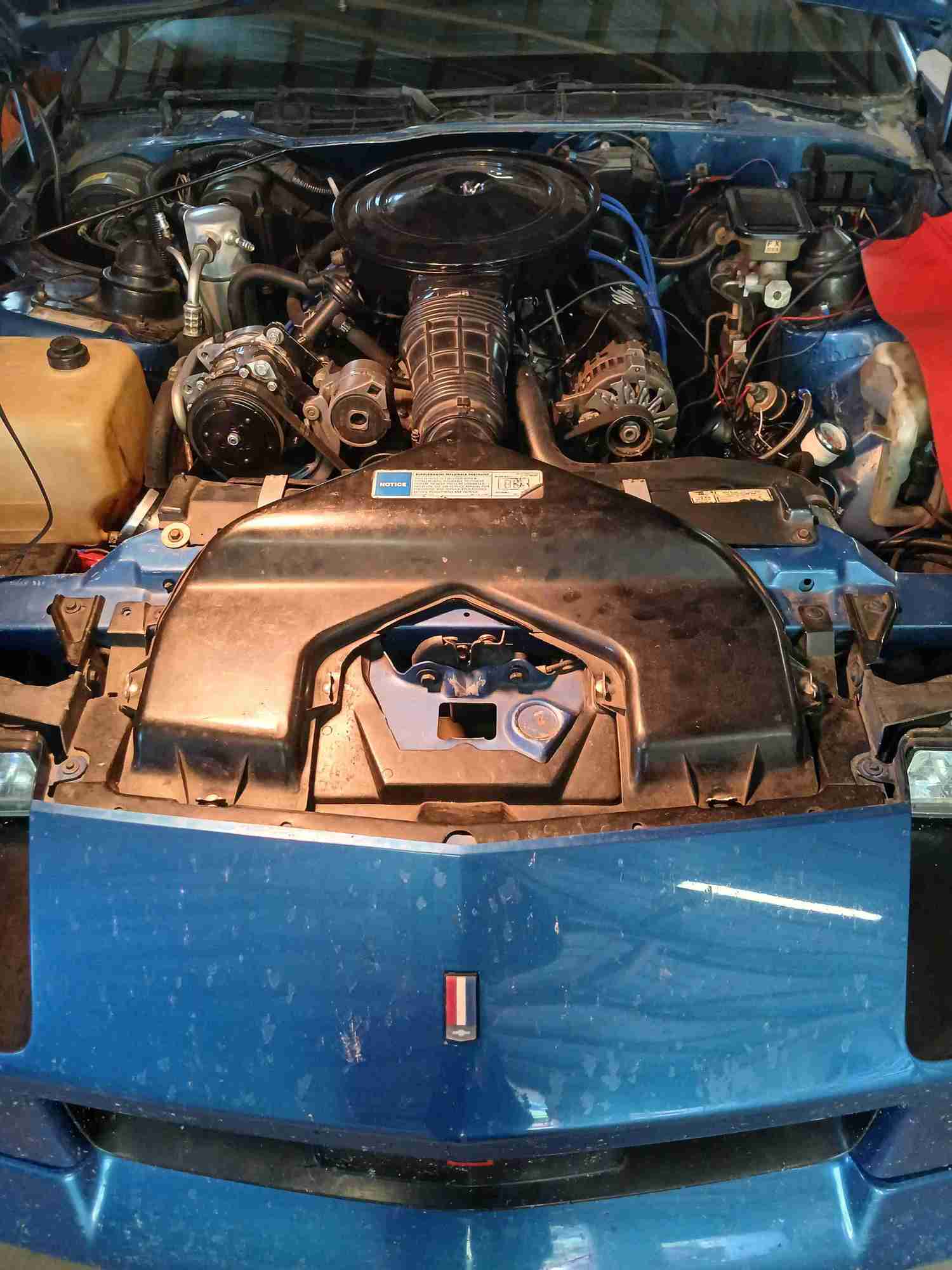

Yes it was TPI. Here is what I have.

new fan motors, and reinstalling the plastic nose piece, kept her around 180, while out test driving, it did the trick

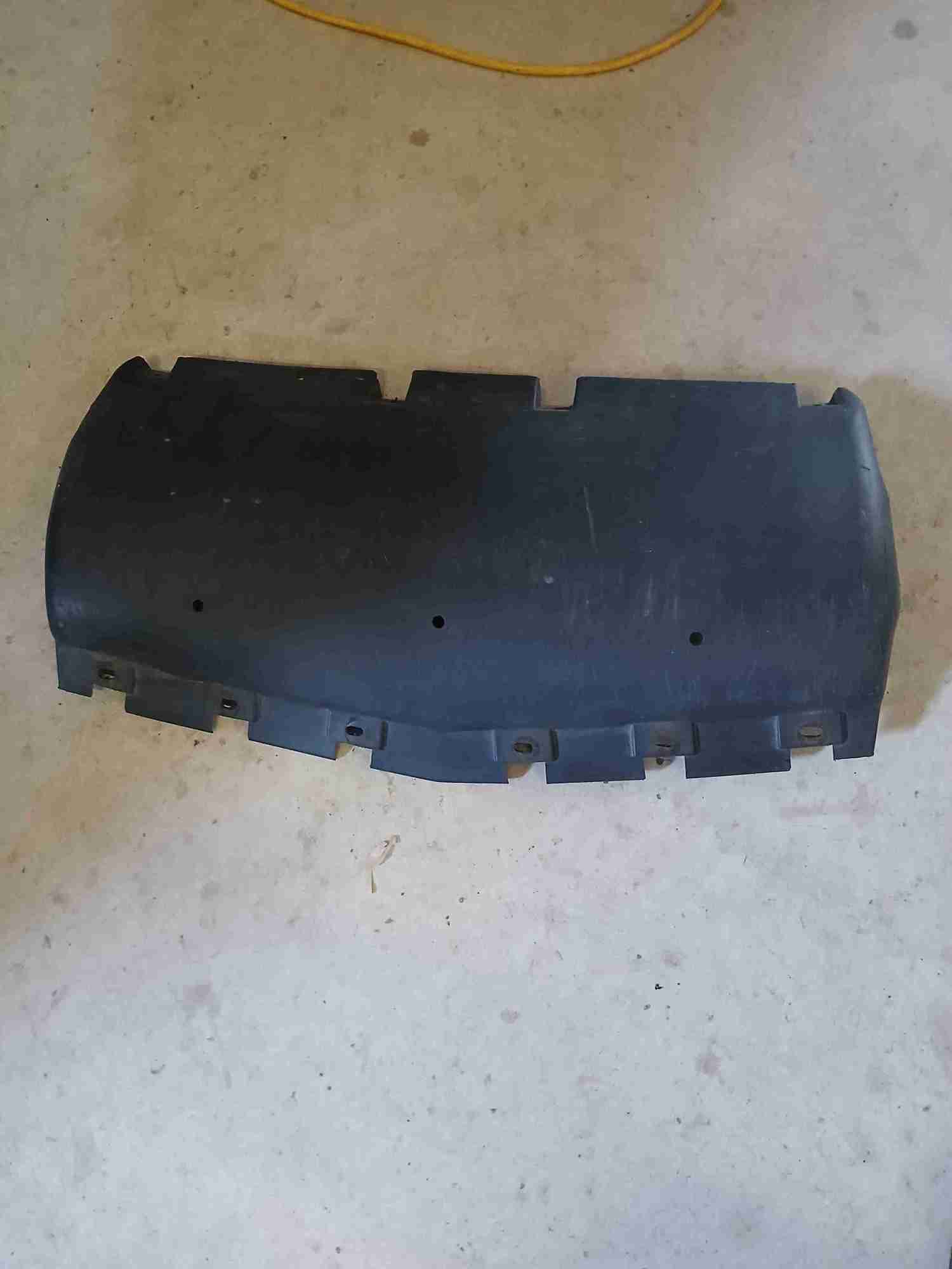

I know this is an old thread but I believe BBCSwap was talking about the curved piece that shows up in the 2nd picture of the first post in this thread.
https://www.thirdgen.org/forums/body...-plastics.html
It's part number 63 when you look at the 89-90 front end/sheet metal parts diagram. I've not been able to find a reproduction piece for this anywhere. Very occasionally they show up on eBay for stupid prices and almost never sold individually.

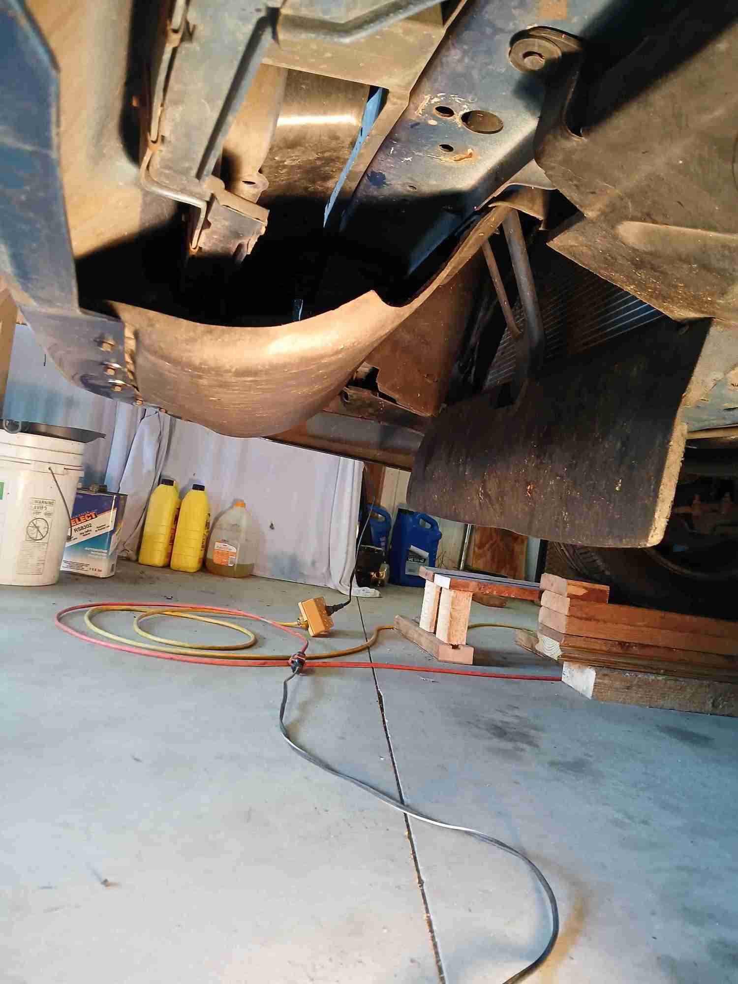

In case it helps ...
Air deflector attached to chin spoiler
View from bottom side

Re: Plastic piece behind front bumper missing
I found the part on Marketplace. Very good condition. He has other parts. https://www.facebook.com/marketplace...rral_code=null
Before & after pic. I will have to wait until it's 80+ degrees outside (probably Aug.) to see if it makes any difference. I will report back.
