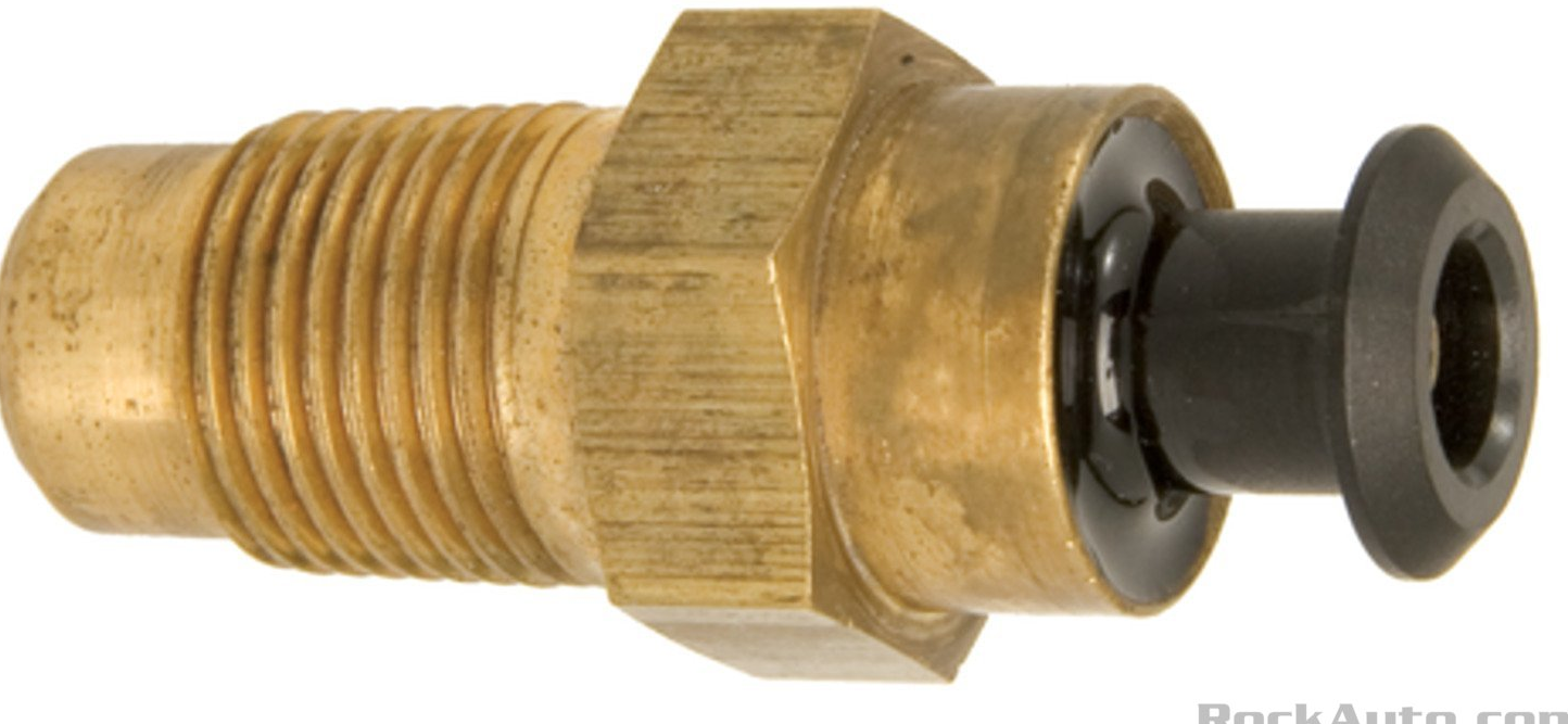

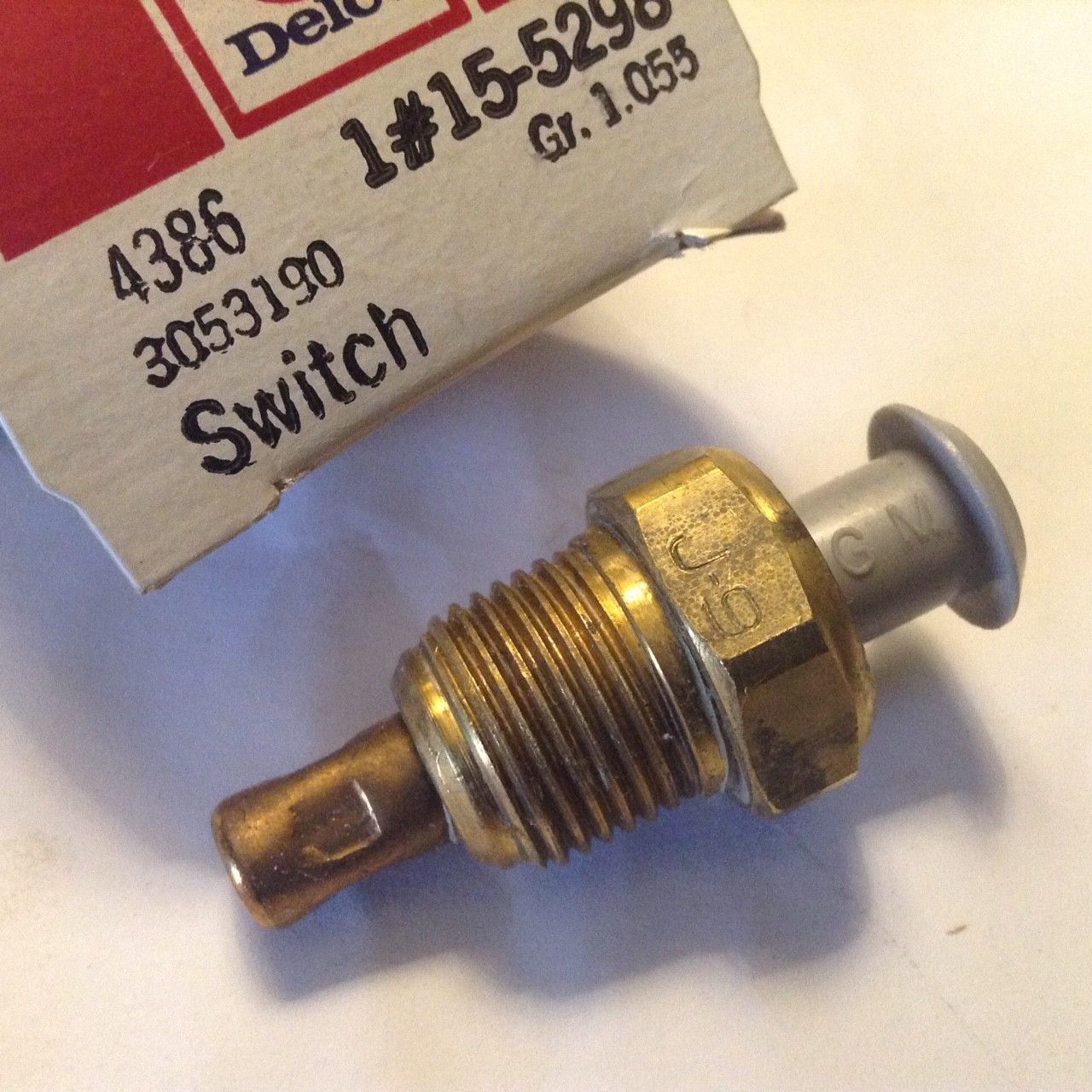

BTW related super finicky question (as a switch is a switch in most cases and there's plenty other brands) but at the moment I'm down in 'zona near three dozen autozones that can order the SW555 in a day. $39.99 - way cheaper than up in Canada after all the BS via online. On the other hand there's a NOS AC Delco 3053190 on fleabay that could be at my door for $75. Already got the GM 170 thermo (ACDelco 131-84) coming for a great price back home, now wondering whether to pop over to save the beer$ or just order that thermo's Delco "sibling". More importantly than that moderate cost difference though I'm mainly wondering Wells/Duramax AZ qual vs the ol' Delco.
SW555
AC Delco 3053190
Are the minor differences a "w/e" thing or improvements given the time difference ie Wells ~years later.

Just going to venture an educated guess that GM doesn't manufacture these parts in house anymore, if they ever did. Most of the ACDelco parts for 30 year old cars are just reboxed parts from the same factories that make the parts at the local parts store.

Well a little more reading and my question on appearance differences is answered: the SW555 requires pigtail PT770 whereas the 3053190 (apparently a Buick GN fan switch) is a direct bolt-on. 210 on/205 off is good for fan life and quicker highway offs, but 210/200 takes it a liiiil more into the fully open range of the 170 thermo for a black city car. No pigtail bonus and about the same cost = AC Delco it is.

I believe the SW555 is the buick GN switch and 89 turbo trans am and uses the same connector
