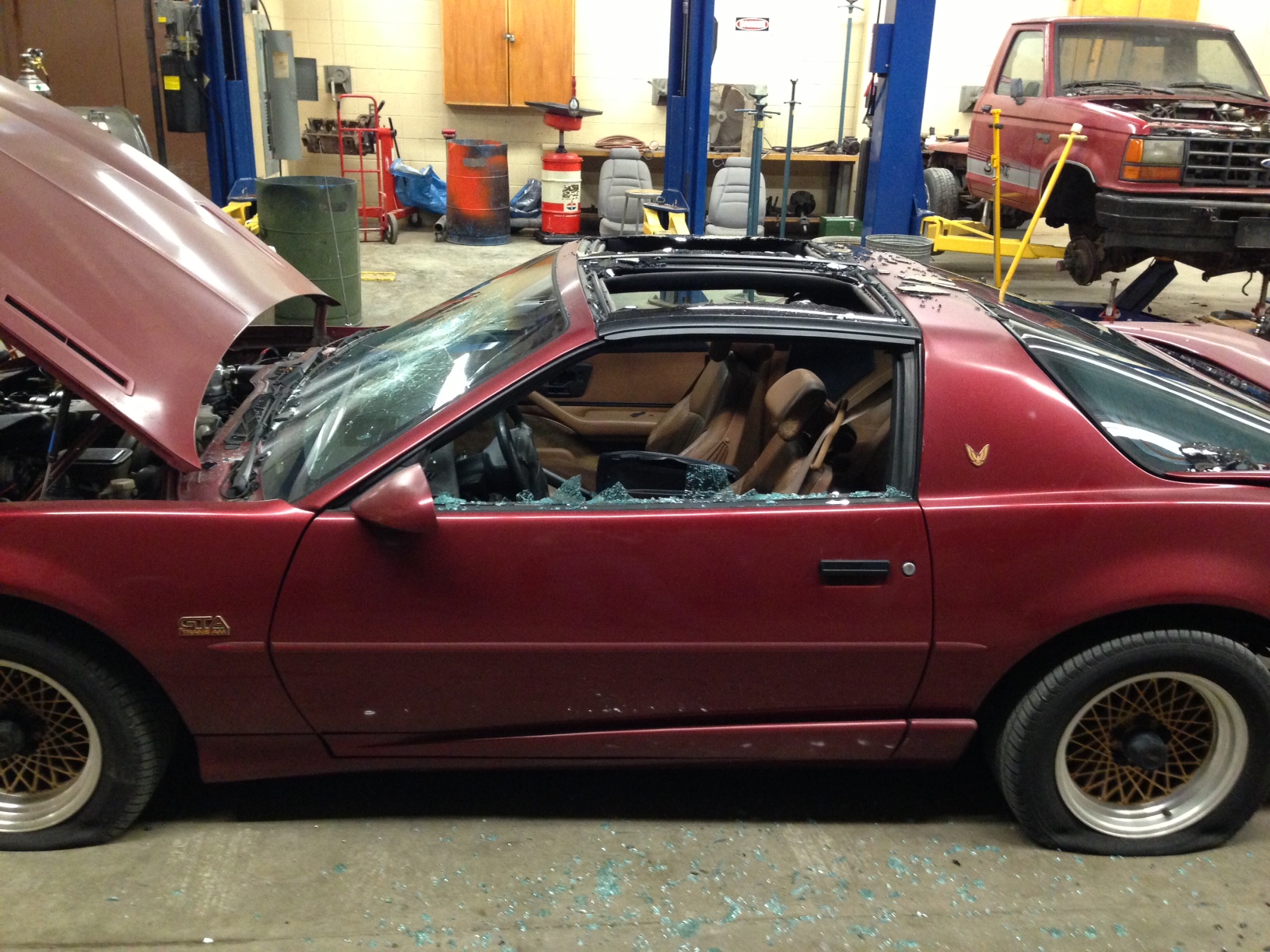

Well it's been delayed indefinitely the shop I was working in was broken into and my car vandalized got most of the damage repaired between insurance and savings but lost my job as a teacher which lost me the shop haven't had time or money since then to work on it

heres a pic of what it looked like
