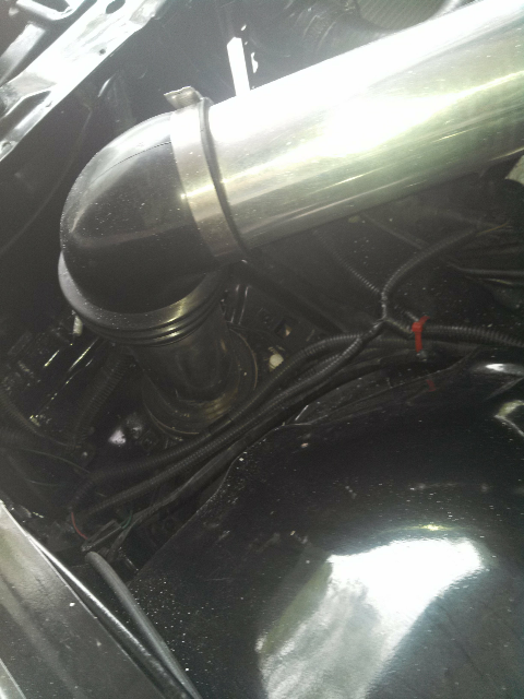

I'll b 26 end of next month .. July 28th to b exact ... For a CAI on TBI u can check out my setup I custom made .. It wasn't exactly cheap but no body makes a good CAI for our TBI cars and mine works better than any pre-made aftermarket setup IMO .... I made a thread awhile back detailing exactly how to build it and where to get parts/prices etc.... I think its titled custom TBI CAI or something like that
Attachment 279651
