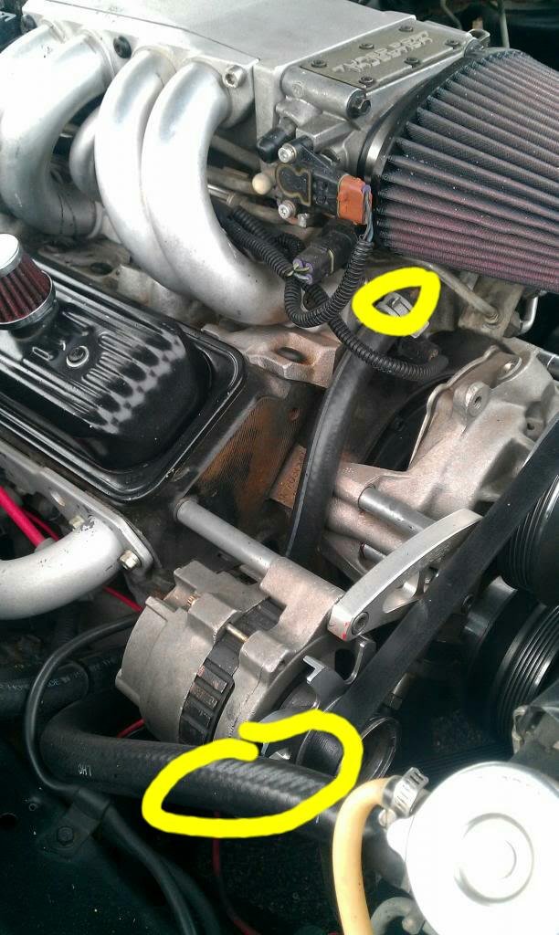

Okay the water pump and thermostat is fine I know my coolant temp fan isn't working. My ac fan does work though. So half the radiator has a fan working just fine but still overheats sitting in the drive way any ideas ?
Also is it okay to simply bypass the heater control valve by running straight to the radiator. Pic below

Turns out that the oil cooler lines were clogged and slowing the flow of coolant to a crawl. Once I bypassed the oil cooler and got the fans running it no longer over heats.
