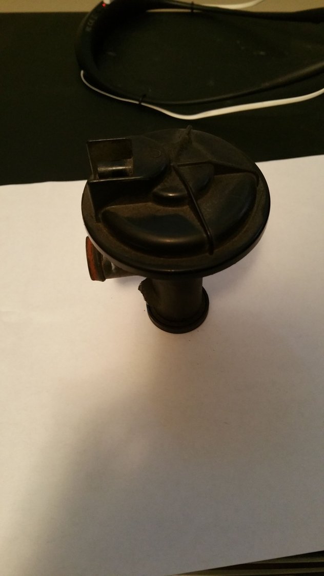

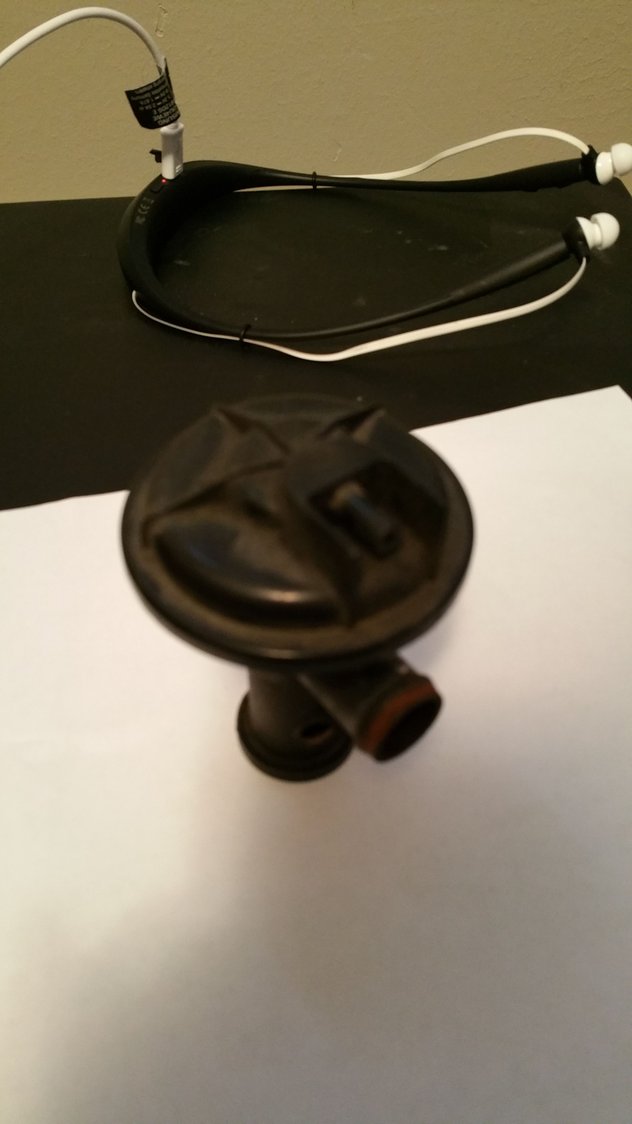

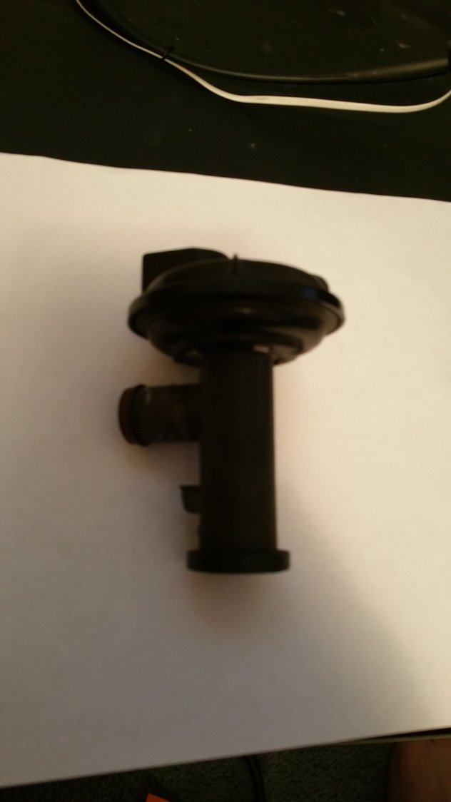

I was removing what looked like radiator hoses from a plastic peace (I say looked like because the hoses ran into the dash) that I've pictured below. While doing this, the hoses did not exactly separate from the plastic peace very well and the hoses decided that they just could not part with the nipple. so now I have this plastic peace that I'm pretty sure I probably need it in one peace.
I'm asking here before I go to any parts store because I don't have a lot of confidence in their ability to identify it. If you need more/better pictures, please let me know and I'll attempt to comply.

Heater control valve......vacuum controled to allow coolant flow to the heater core
about 20 bucks

Originally Posted by Bob88GTA
Heater control valve......vacuum controlled to bypass coolant flow to the heater core and direct to the radiator.

I see that you've altered his syntax a bit. I'm assuming the bypass is to prevent any coolant making it's way to the heater core so that it can heat up more quickly? similar to the way the thermostat works?

When you slide the temperature all the way cold, it opens a small valve on the hvac controls. This applies vacuum to the divert valve, bypassing the heater core. Anything but full cold, there is no vacuum applied.
Presumably, this to assist the cooling efficiency (effect?) of the a/c.
