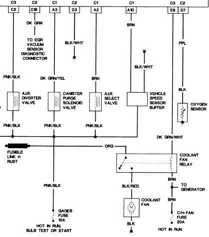

According to the wiring diagram and my experience that's what I'm saying. The full wiring diagram can be found here:
http://austinthirdgen.org/mkportal/m...ine_wiring.gif
What you may be feeling is a sending unit a PO added for a gauge or temp switch or something. I don't really remember what's between cyl 6 & 8 and I don't own the car anymore to go look.
