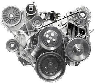

The stock A/C and smog bracket is the mount for the belt tensioner. Does your bracket look like this? Or are you saying you no longer have or never had the the bracket?

ya thats the bracket i have on my car. but i was looking for somthing differant.do they make or did they make a differant bracket?
I'm not sure such a thing exists..unless you want to go to a completely new/custom style serpentine belt system for the whole engine. That setup above with the stock brackets and delete pulleys is typical of what you'd see on a lot stock-ish thirdgen cars though.

No real good solution. Most likely you'll need to convert to v-belts or go to an aftermarket serpentine setup to get rid of that bracket.

iam wondering how sturdy the bracket would be if i cut the bottom off about where the smog pump was?
Not sturdy at all since it's all one unit.
