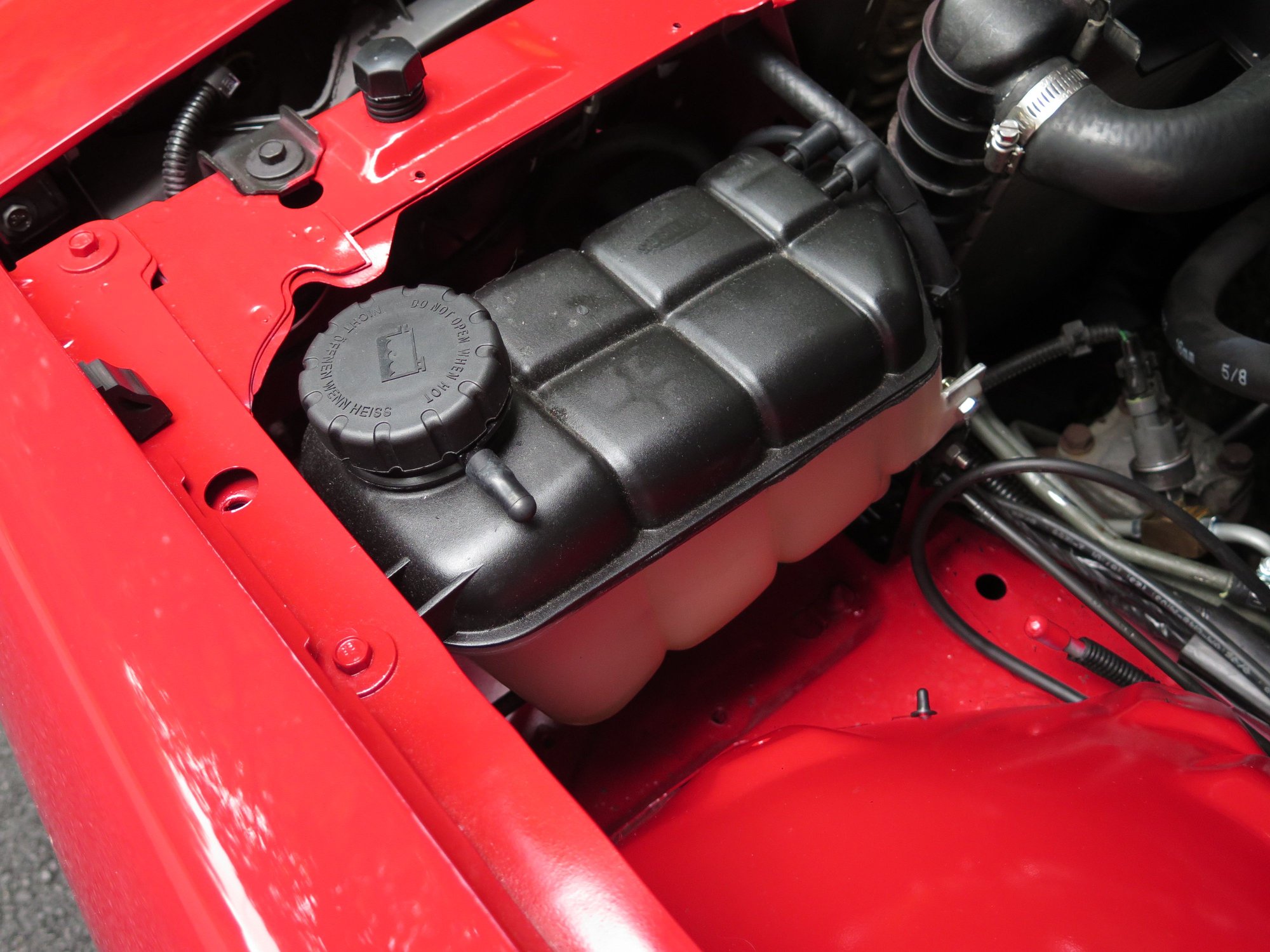

Old Sep 1, 2016 | 06:57 PM
siuol's Avatar
Joined: Mar 2016
Posts: 141
From: Connecticut
Car: 1987 Firebird Formula
Engine: Carbureted - 305
Re: Options for coolant resevior.
Hi, This what I use. Its from a 2007 Mercedes. Got it new from Ebay for 20 dollars.
I removed the charcoal canister and window washer container and re-located the radiator overflow to the drivers side. Hope this helps. Work great.
Louis
