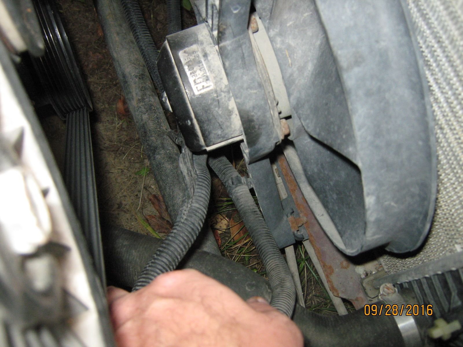

All the electrical still there? When you put the controls in any position that would normally engage the compressor, it should also turn on the cooling fans.
Old Sep 29, 2016 | 05:24 PM
factory89tpi's Avatar
Joined: Aug 2016
Posts: 7
Re: 1989 firebird 305 tpi overheating issue
the relay for the passsenger side fan
Had to do some temporary wiring repairs
there is the wire going down to my auxillary fan I do know it work cause if I hook a wire to it and touch it to the battery it does come on
This is on the side of the air box
these 3 wires I believe go to the compressor that is no longer there
And I do know that when I turn it to ac the blower motor kicks on no problem but the fan does not
