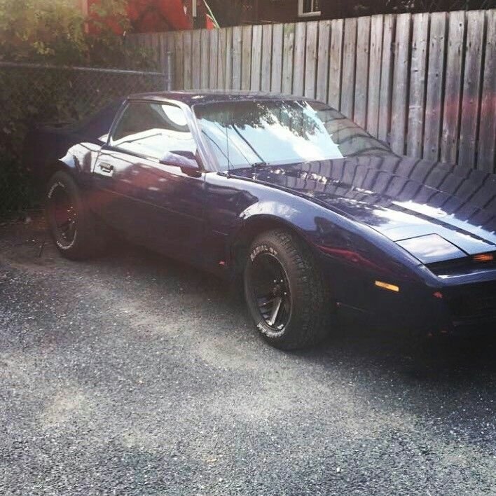

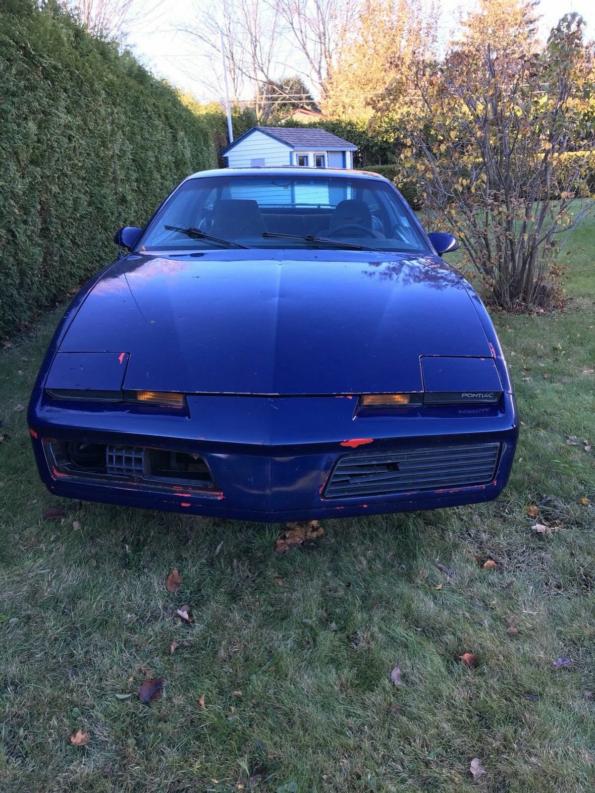

Hi! So I just bought a 1982 trans am originally a 305 swapped to a 350. I bought it as is and the seller didn't know anything about the car.
The thing is my heater doesn't work. The fan works, I have air but temperature control doesn't work (so just ambient temperature)...
Any idea where it could come from? I'm pretty new at owning a 3rd gen...
Also the car doesn't overheat
Thanks!
