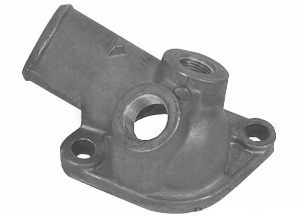

I drive an 85 z28 camaro 5.0L carburated and was going to change the thermostat housing unit but noticed there was a connection connected to it and the new thermostat housing i got at autozone didnt have one. The connection seems to be leading into the car but no where near the engine. Was wondering what that line was/does and do i need to have it or can i just remove it? Thank you in advance.

Is This The T Housing You Have,It Takes The Engine Coolant Temperature Sensor And A Ported Vacuum Switch.
the housing unit looks something like that. To be honest not entirely sure but will post pictures as soon as i can and thanks

Yours should look like GT's pics, and should have those same things in it.
The vacuum switch is the EFE TVS... controls the flap in the exhaust on the pass side at the junction of the manifold to the Y-pipe.
yes thats exactly what they are so being new to the engine and all these things i take it these are essentials and needed for thr car to run properly?

Yeah, sorta need them. You can get them both at car part stores, pretty cheap

Depends you can add headers and you don't need it or you can wire it open, as for the other one unless you have the electronic carb you don't need it either.

Plug all those holes on the therm housing. Remove all the TVS units & reconnect the hoses directly to the carb.
That is what I did on my '84 Trans AM. Easy to do. I also removed the butterfly from the heat riser as it had started to seize.
The purpose of the TVS is to stop all vacuum to the engine until the block warms.
