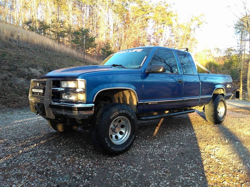

Re: help cooling fan
ok, thanks for the info....
id still like to keep it around 170-190 if possible, this truck has 300k miles, always runs 180-190 on guage, and its 305 vortec… ran like this for years
1997 Chevrolet Cheyenne k1500 f44 HD heavy duty half ton 305 vortec 5speed 4x4 373s 33x1150s

So, help us understand:
You know better than the engineers who built your vehicle, what temp it needs to be at? You're an engineer or something?
This is of course, a 82-92 Camaro/Firebird? I'm not sure the photo shows any of the options available on any of the vehicles exclusive to this site?
