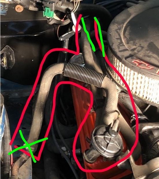

Hey guys looking to delete this hose. Was wondering if its possible and if so, how can I? Its a 89 305 tbi. Will also be installing an Edelbrock performer intake manifold and was wondering if that would have anything to do with it? Sorry there is probably already a thread or post on this i just find this website so hard to use. Thanks in advance guys!

Why would you want to remove the heater control valve?

Possible? sure. Desirable? not really.
If you don't know what it is, leave it alone.

Ok so thats what it is. I just wanna clean up the engine bay, get it from on top of my valve covers. Ive deleted a/c. Is there any way to re-route the hose to clean up the look?

You can re-locate anything.

I thought that was the diverter valve for the heater core. With the AC on the valve wouldn't let the hot coolant to go to the Heater core and potentially warming up the air. You can delete it, The larger diameter hose gets ran to the water pump and the smaller to the top of the intake manifold by the thermostat.

People still delete A/C? What is this the 1940's? A/C is easy to fix and it's ****ing awesome. But if you want to sweat like a caveman or something, cap the hose coming off the hardline, and connect a short hose from the port on the back of the intake to the heater core. Find a safe place to tuck the vacuum line from the valve so that when someday comes and someone wants A/C again, they don't have to fish a vacuum line back through the firewall.

Be extra careful when removing the hose(s) from the heater core. Tug a little too hard on the hose and you will be replacing it.
