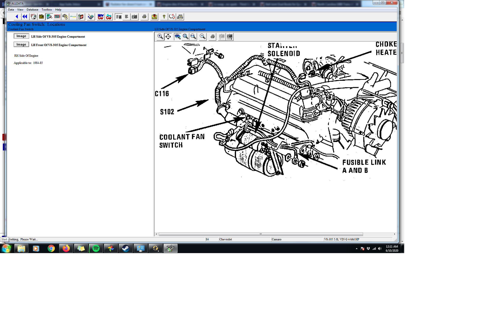

there is a fan switch in the passenger side head.

Re: Radiator fan doesn’t turn on by itself
from alldata
Is it easier to get too from under the car or above?

Usually easier from above. Just like spark plugs (it's in between 2 of them).
Unplug its wire; with the key on, ground the center pin of the pigtail, with a small piece of wire or something; the fan should turn on. If it does, the problem is the switch or the pigtail. If it doesn't it's probably the wiring. Some of the wiring, and the motor & relay, would have to be working properly for it to work with the AC, so those parts can be ruled out.
