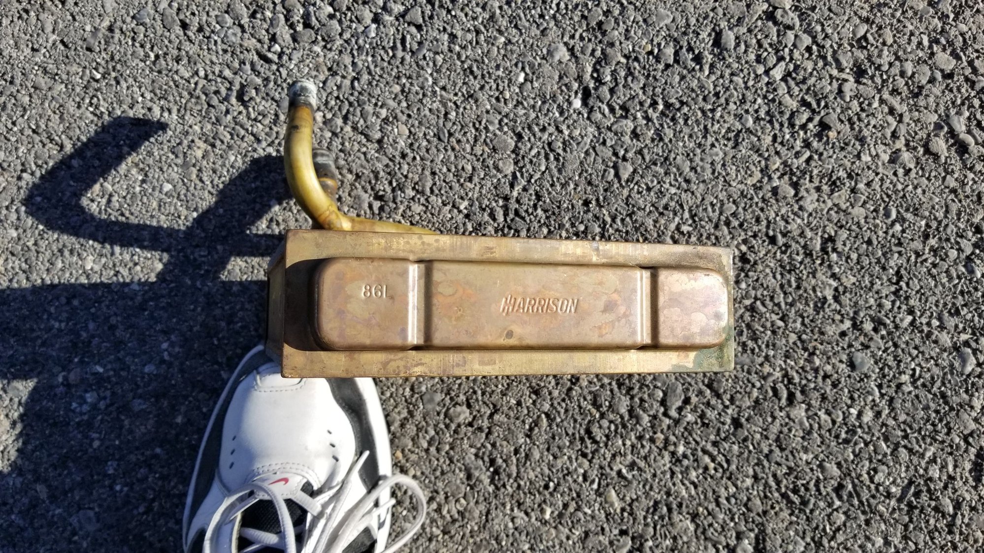

Restore the original was my initial plan. Have a family member whose dad ran a radiator shop for years but his dad has passed a few years back and I have no clue how to find a shop that does this. Or how much it would be. Once I figured out the trick to removing the core without removing the dash it wasn’t so bad but I would like to not have to deal with no time soon lol. Anyone know who can do this or what kind of shop to look for? If I have to ship it fix it and ship it back and costs me a small fortune, I’ll go the AZ route for $32.99. As others mentioned this car won’t really need it for me, but I like knowing it’s working correctly.
Here’s my old one. I soaked in overnight and it’s clean. Possible to find the leak point and solder it shut?
That’s original correct? Has some stickers on it that I assumed were original part and inspection info.

I just pulled mine and it has Harrison on the side of it. I guess its a replacement heater core? It doesn't have the inspection stickers on it.
You know I didn’t even think of that. I saw Modine and a couple cross reference numbers and assumed replacement. As soon as I read your reply with Harrison I would say you’re 100% spot on

Harrison is OE.
No stickers of any kind.
The stickers would indicate that CKone's is most-likely not OE, but an OE-style replacement, from when they were still available. And if the tank on the other side doesn't say, Harrison, then that would also indicate it's not OE. However, I have only my 87's to go by, so I can't speak for the entire generation.
Back when OE-style replacements were still available, the part number was 399083, like on CKone's. 399083 is still an active replacement part number, but now it represents one of the cheap aluminum products.

For the sake of full disclosure, I took my heater core to a radiator shop on Thursday. They pressure tested and said that it wasn't leaking. After reinstalling and making sure the clamps were snug, I don't have a leak.
Amazing what tightened clamps can do. lol
Might be a good idea to start thinking about a future leak though. My GTA is a high mileage car that will need one eventually
Wow now that might be enough to make a guy shake his head lol. Don’t know that I ever really thought to check that but I will now!

85 bucks to repair.

85 to repair or re-core?

Repair. The tank solder joints failed.

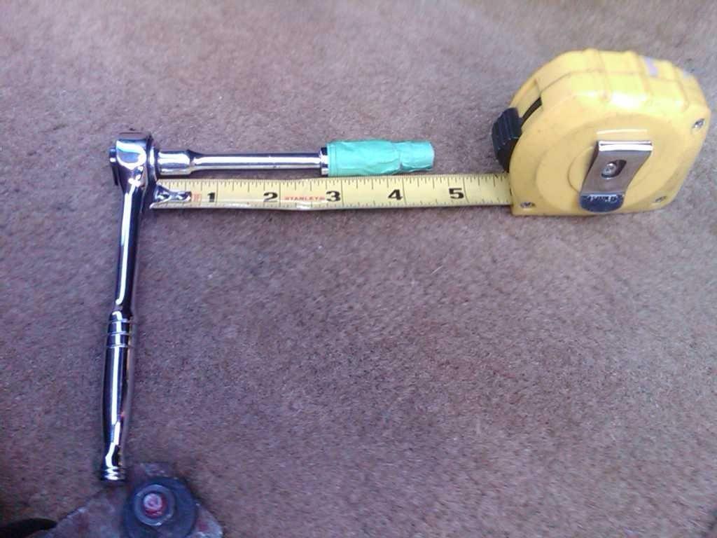

Resurrecting this thread, because me too!
As others have said, it can be done through the underside, but it's a pain. A few of the screws are difficult to reach, and especially (on my 92 RS) the top center one.
Some people can reach up above the duct with a long skinny extension and 7mm socket and access the last screw, but I ended up removing the dash pad, speaker, and all the screws holding the dashboard on, except the far left one. Then I pulled it out a few inches until I could reach down to the to screw with a long flexible extension, and when I removed it, the duct fell out on the floor. Still a lot less pain than removing the console and dash!
I also got the Spectra 94606 at O'Reilly, and it was a good fit. They had it sent from another store, they told me on the phone that the pic in their database showed theswivel joints, but this is what actually showed up at the store:

I have used Spectra on my last two cars. 1986 IROC no issues. 1991 Z28 no issues. But I don't drive in the winter so the air seal of the Spectra was not noticed. Works great. No leaks. If I go out on a cold day and non-salted road all I need is a little defrost heat. Works great.
I lost my patience doing the first one. Who can tell if if the Spectra fits the frame and seals when you are upside down with a flashlight in your teeth, bleeding fingers and thumbs!!!
Yes I agree with the use of a 7mm socket taped to a medium extension with a thin ratchet to get that top bolt. lol
