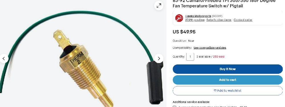

Would be nice if someone had a picture or partnumber of the the tempswitch on the passenger side of the block.
It looks like this
If you can, you should order this one from hawks
You don't need a lift, just a jack and stands will do and you will see it from underneath, coming out of the cylinder head just in front of the starter

IIRC these work on wax melting to somehow complete the ground circut of the fan. Not sure if there is a resistor test for that. You should be able to test it by turning the ignition on so that pass fan runs, of course do this with the car cold. While it's running pull the lead off the temp switch. If the fan stops your switch is grounding all the time and is bad.

Solved !!
Pulled the lead off the temp switch and the fan stopped. New temp switch ordered.

Originally Posted by vinny R
....you will see it from underneath, coming out of the cylinder head just in front of the starter
Pretty sure that's the knock sensor, not a temp sensor.

Re: Cooling fan
Nice! No jack stands needed, either, right?
The knock sensor is in the block and looks different than the temp sensor one I pictured.
