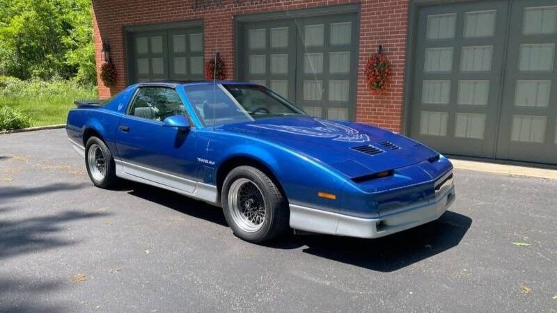

Here She is Lady driver Florida Hot with no A/C

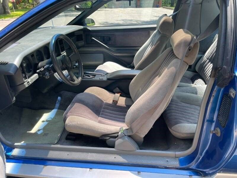

Inside Super Clean need new paint little bit of body dings fixing.
