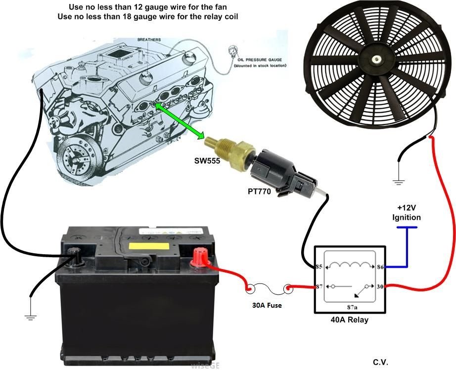

The knock sensor plug and the and the fan switch plug are very similar....... The plug for the fan switch to the relay should have a GREEN/White wire.
Here is the schematic for your electric fan:
You'll need to install a head-mounted sensor and then connect the proper circuit from the switch to the relay. If you still have a problem after the switch and plug are in place,... then start to try to diagnose further.

If you stock harness is fubared by a pervious owner you can always make your own fan harness. Here is an example.
