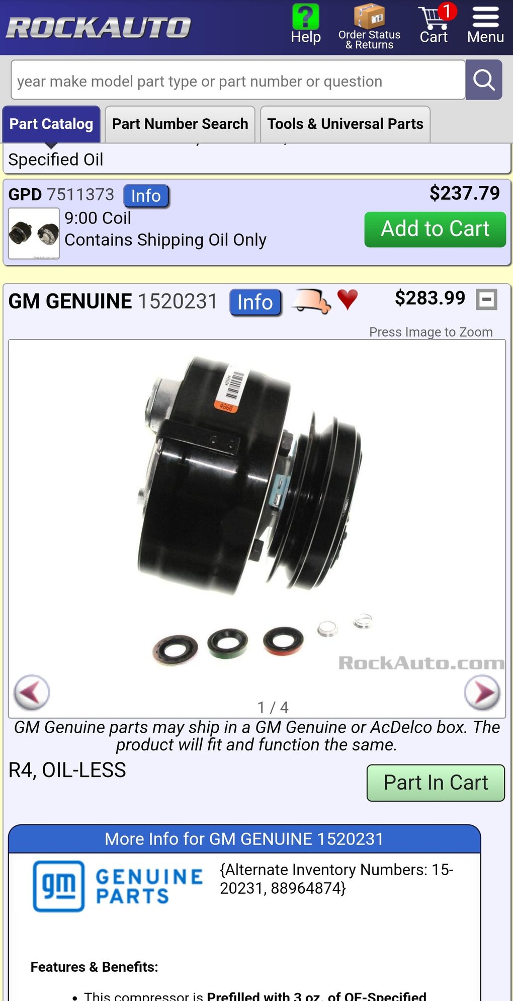

Re: finding a proper ac compressor!
is this it, not sure if 1987 has serpentine belt ? https://www.rockauto.com/en/moreinfo...t=6628&jsn=577
Im pretty sure its this one. It has a v belt. Thanks for the info!
Just found out. That one wont worke either. I need one with a threaded pressure switch port on the back. Seems all the new and remans dont have this? Not sure what I will do. Keep looking I guess.

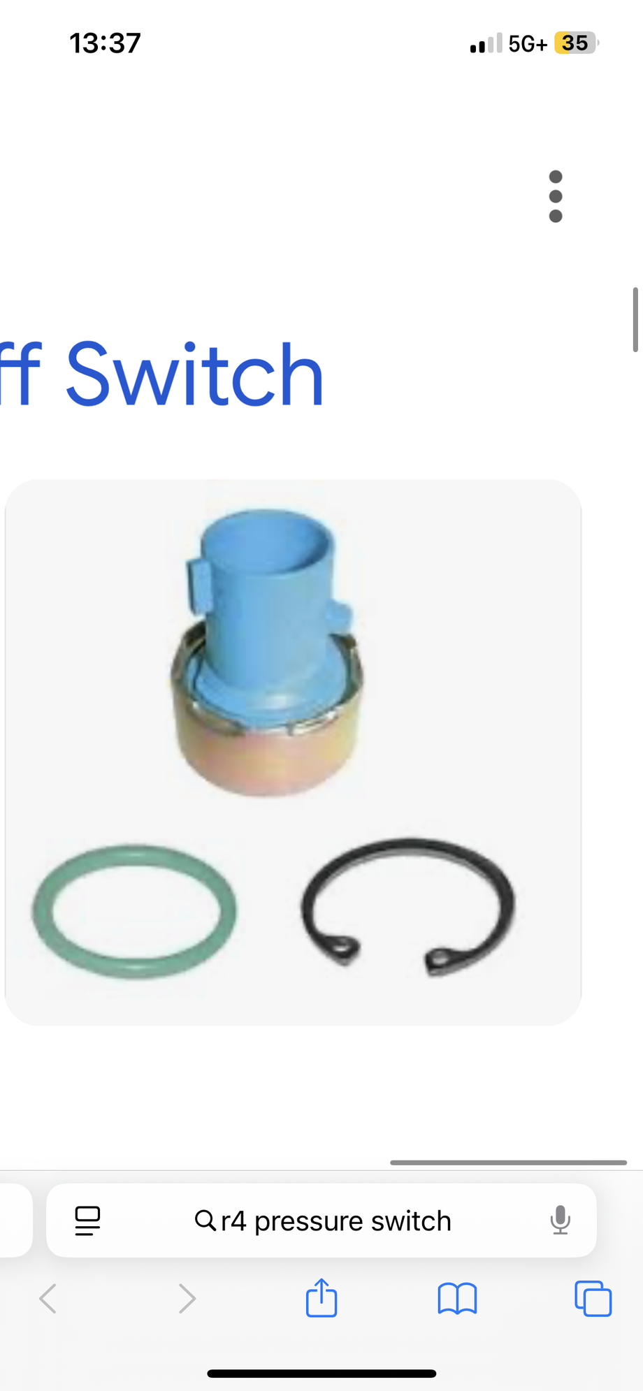

Why do you need a threaded pressure port? Cant you just get a non threaded pressure sensor and go that way?
because there are 2. One near the accumulator and one in the compressor. Without the one in the compressor it would throw the whole system off. Unless Im getting incorrect info? But thats the way Im understanding it.
I think midias is telling you to just get the sensor that fits the new compressor.

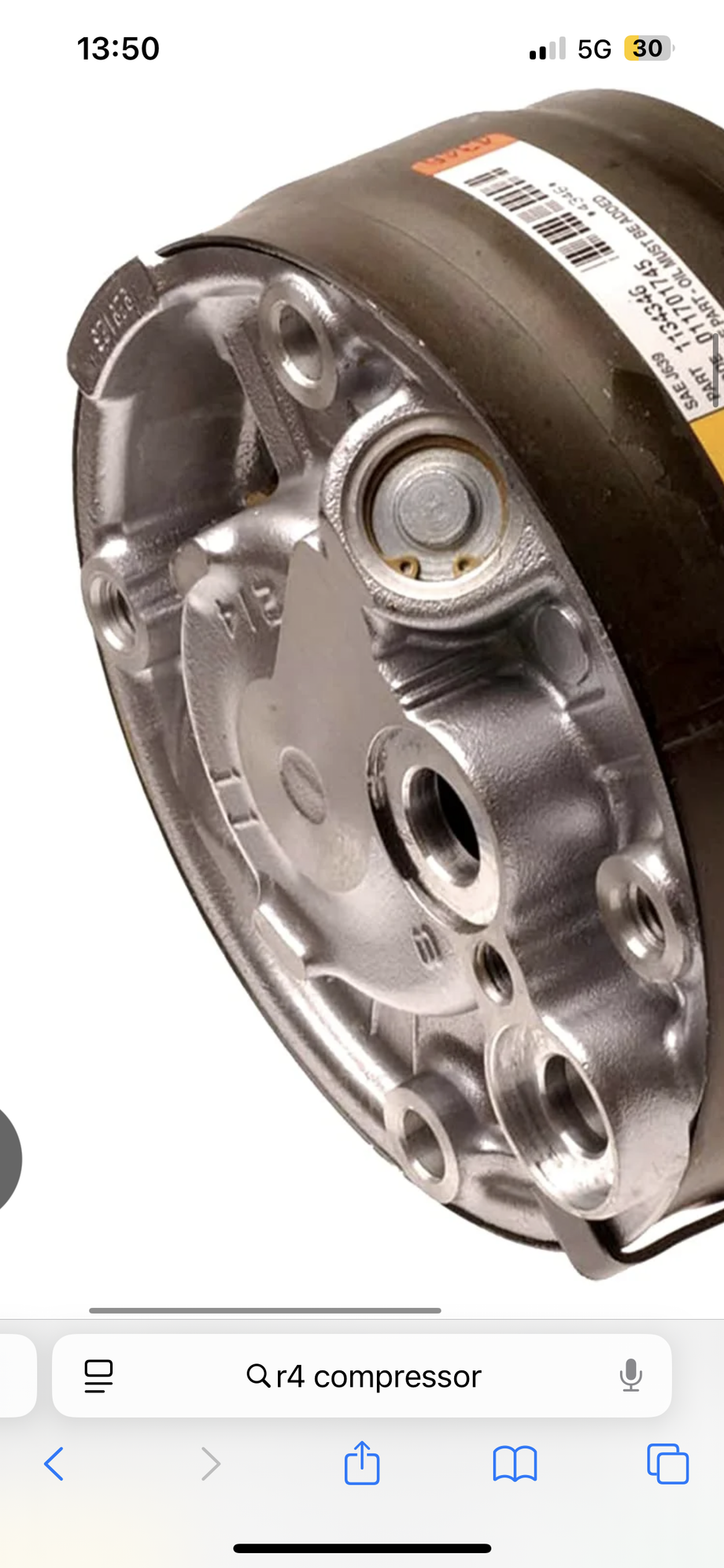

Old Apr 5, 2025 | 12:53 PM
gp90gta's Avatar
Joined: Jan 2009
Posts: 456
Likes: 12
From: New York
Car: 1990 GTA
mine is the original Harrison compressor that has a electrical connector that plugs into the compressors cut off switch. The new compressor I bought has no place to connect that part. All I see is a small area covered by a snap ring. Not sure whats behind that snap ring? But it doesnt seem to be for a pressure cut off switch? And of course no documentation came with the new compressor. I would be very happy if this would work!
Does it have this?
Old Apr 5, 2025 | 01:10 PM
myzticc66's Avatar
Joined: Jun 2010
Posts: 121
From: Minnesota
Car: 1987 Chevy Iroc Z
Transmission: 700 R4
Yes. So that is where the switch goes?
Yes that’s the correct place for the high pressure switch on the R4 compressor.
To be honest I’ve never see a screw in pressure sensor on an R4, not saying it doesn’t exist I’ve just never seen one, all the thirdgens I’ve ever worked on has the one I posted in the picture.
