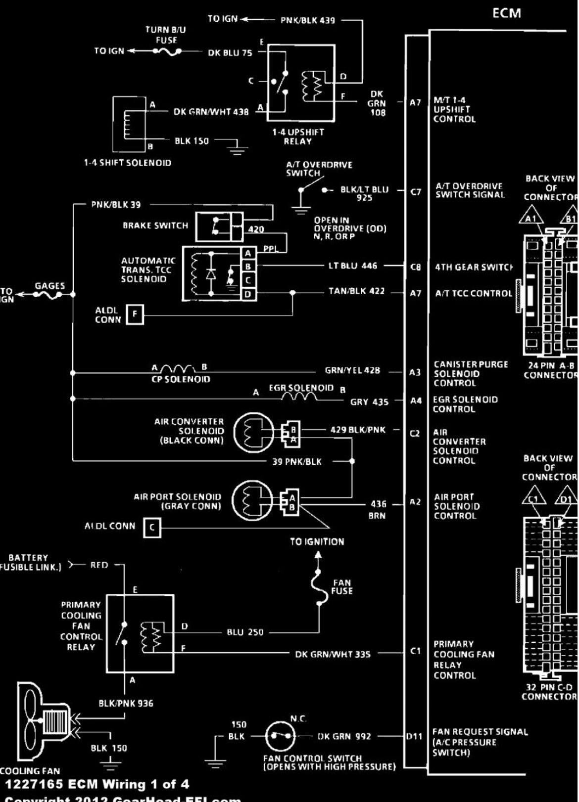

The primary fan is only triggered by the ECU.
The secondary fan have the high preassure sensor hocked up to the ac system, but the system is low on R134.
The temp switch for the secondary fan is broken and hooked up to a manual switch. It I jump the ac high preassure switch the secondary fan starts.
I dont think the primary fan will start with ac senders

So if c1 of the ecm is grounding the relay the ecm is faulty since it’s not commanded.

I’m pretty sure the fan switch in the tune would command the primary. But if all that’s fine and the ecm is grounded the relay not commanded then the ecm is bad. Or it has a cold solder joint.i had a customer recently firmly press down on the memcal flexing the pcb it stopped the fan request. He reflowed the ecm joints but no success.

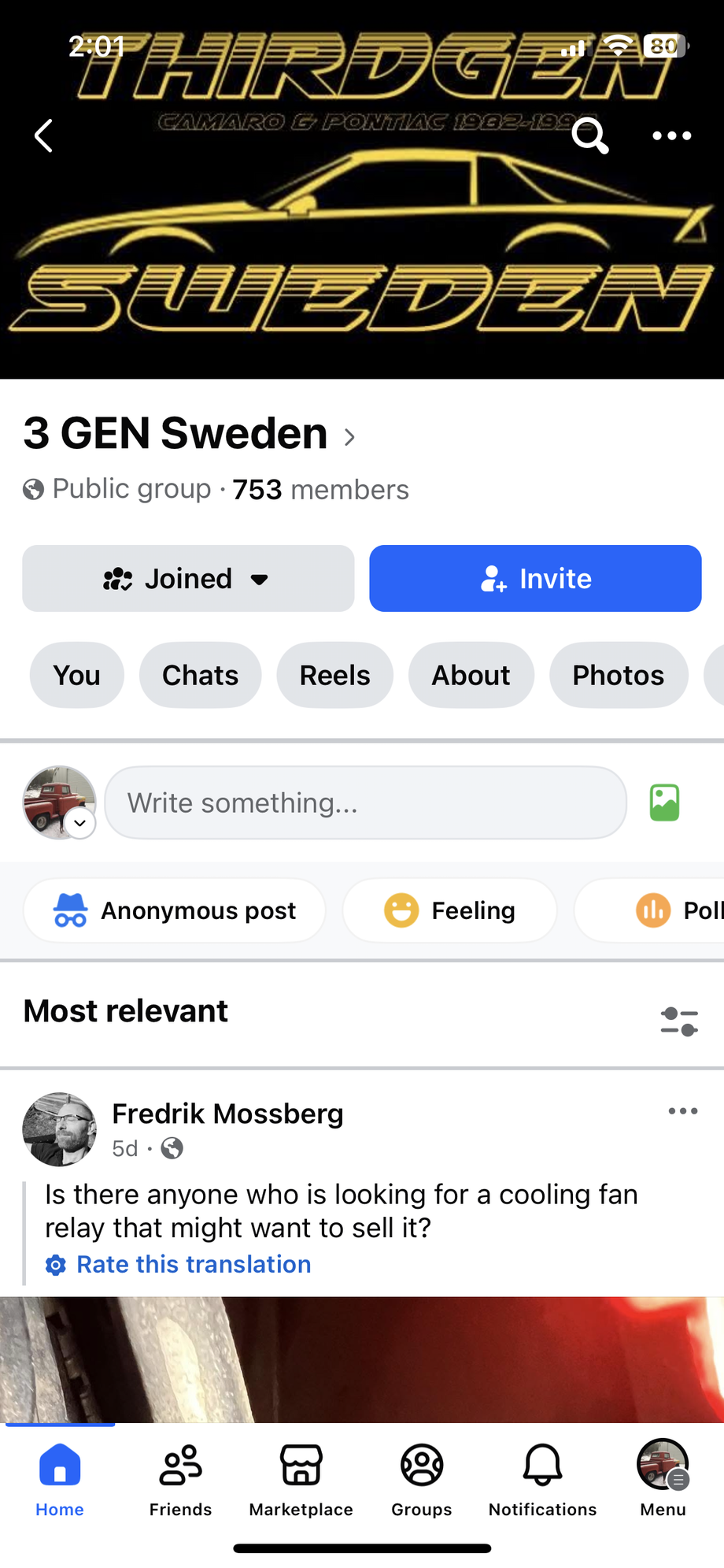

Could ask this Facebook group the 165 was used 86-89 tpi

thanks.
Cool that you found my post on that side

Does the fan continue to run if you disconnect the AC high pressure switch? If you remove the relay?
Old Jun 25, 2025 | 08:39 AM
FredrikM's Avatar
Joined: Jun 2025
Posts: 10
From: Sweden, Stockholm
Car: Camaro Iroc-Z
Transmission: TH700-R4
Re: Primary cooling fan runs all the time
The fan runs when i remove the highpreassure switch from the ac line.
When i remove the relay, the fan stops.

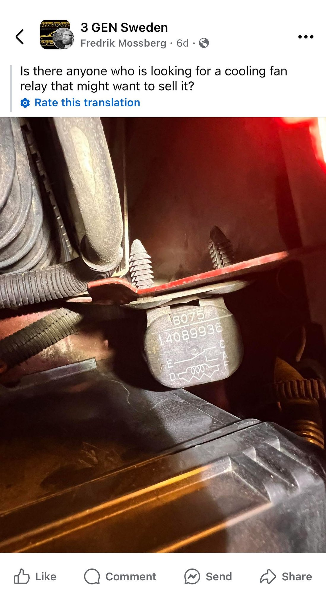

And also, the green/white cable at the relay socket that goes to the ecu are only grounded when the car runs. When stoped it is not grounded, so maby the ecu works

Have you swapped the relay for a known good one? I've had them stick closed
iirc it’s the same as the fp relay or blower relay.
yes, i have swaped them and it is still the same.
