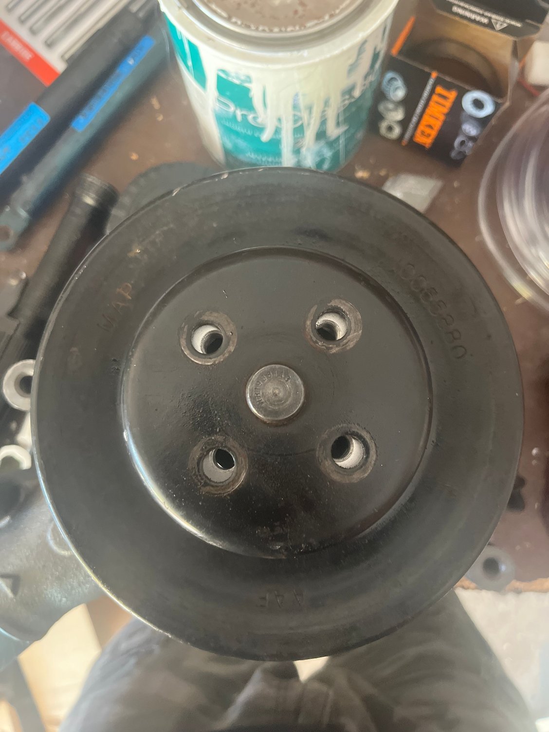

purchased new Gates 43099 water pump for my 87’ 305, upon getting old pump pulley off, new pump holes don’t align with old pulley.
New pulley needed? I thought this was the correct pump. Not sure what’s going on.

You need to get the correct waterpump...

87 doesn't have a "serpentine" (snake-like) belt.
It DOES have one flat ribbed belt, the same type of belt that's used in "serpentine" drive systems. However, it's not "serpentine"; only flat and ribbed.
AFAIK 87 uses the same WP as almost every SBC, except ones in the Vette, from about 69 up until the "serpentine" system was introduced.
That's simply the wrong WP. Might be the one for the "short" pump system from back in the 60s.

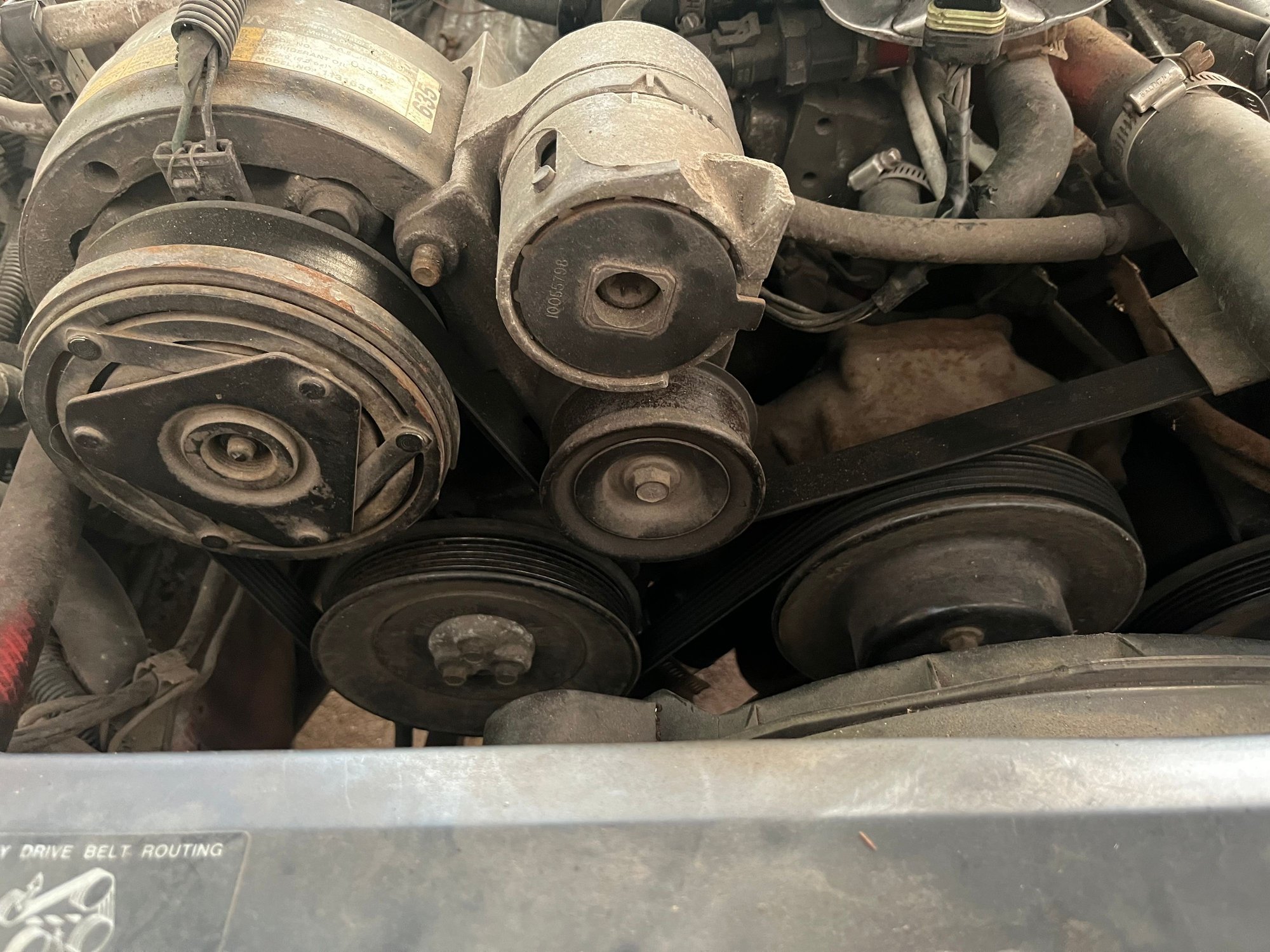

Originally Posted by cotto1122
Back to Rock Auto it goes I guess. That was the pump under the 87’ year so I guess I’m a bit confused.
88 and later had a single belt. 87 had one flat ribbed belt and several v belts. Which one do you have on the car? If someone converted your car to the newer belts, that would explain your issue.
Old Sep 26, 2025 | 05:37 PM
cotto1122's Avatar
Joined: Jul 2025
Posts: 38
Re: New water pump pulley holes don’t align?
Yup just one single belt.  So I need an 88’ up water pump.

That's not the correct WP pulley for an 87. The pulley for an 87 should be part #14088685. It should have a V-groove on the front for a V-belt; 5 micro-grooves in the middle for a flat 5-rib Micro-V belt (same type as the 6-rib flat Micro-V belt used for serpentine drive systems, which, just like the 5-rib belt, is round; serpentine is a routing style, not a belt style, design or name); and there's a V-groove behind the 5-rib for a V-belt.
If your car is an 87, then it's been converted to the 88+ serpentine drive, so yes, you'd need an 88-92 WP.
Looks like someone converted your 87 to an 88 up serp system. thise looke like the 87 fuel lines.
Late 87 V8s had serpentine belts. I have run across 2 of them. One was a TPI 350 and the other a late production LG4 with a factory installed serpentine belt setup. I know it was factory because the vapor purge valve had a factory built mounting bracket.
