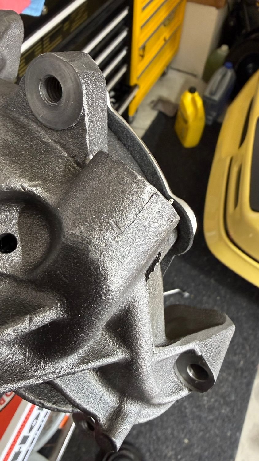

Bought an AC Delco Gold water pump to replace my failing original and the housing cracked when installing the new heater hose adapter. Maybe I was just overtightening but it sure didn't seem like it. I'm guessing this housing is grey iron and not cast iron. Anything better available?

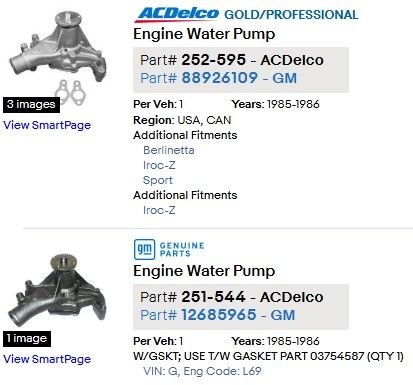

Originally Posted by gt4373
12685965 Is Cast Iron
I got the one above it. The cast iron pump is $128. Geez. I may just go grab an Autozone or Oreilly cast iron pump.
