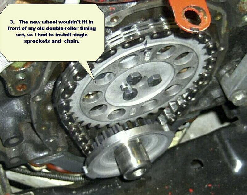

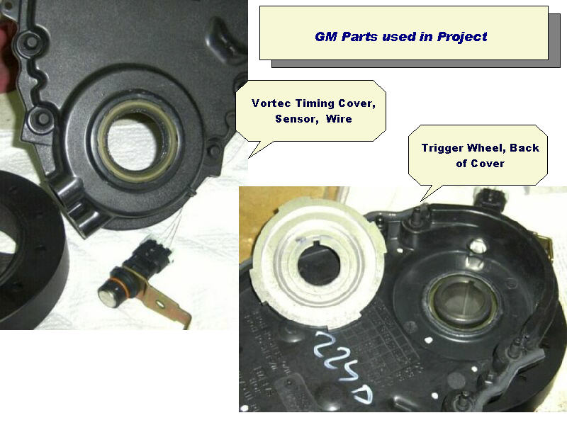

Originally Posted by drain89
Since I'm converting to Holley MPFI instead of TBI but wish to use a 730 ecm, could I use the newer style ignition from a gen 1 vortec truck? It has a crank sensor and cam sensor. External coil and external module.
How hard would it be to adapt to this style of ignition?
Or would I be better off to stick with the small cap 87-95 style distibutor?
305 TBI roller cam block
LT1 roller cam
Stock casting 081 heads
Flowtech 11500 Headers (1.5" primaries 3" collector)
2 1/2 Dual cats, into flowmaster 50 series, 3" single tailpipe.
New Vortec Timing cover and Crank Sensor
New Vortec style crank reluctor ring and timing set
Vortec style distributer and wireset
Vortec wiring harness from Painless off of Ebay ($150.00)
Vortec PCM from 1996 1500 Express with a 305 ($20.00 off Ebay 1997 down is without VATS/Passkey)
Lightly used MAF sensor from a 2004 Suburban 5.3 ($30.00 off Ebay)
Welded in 4 heated O2 sensors 1 before each cat and 1 after) $25.00 for the lot of 4 off of ebay from a 2004 Suburban 5.3
TPI setup from Speed Density 1992 Camaro 305 (Old style MAP sensor connector spliced into harness)
1996 LT1 Firebird Throttle Body (same IAC & TPS as Vortec
Intake Air Duct from 1995 LT1 caprice
The PCM has adapted very well to the engine combination and is fun to drive. It needs to have the EGR programed out as the linear EGR valve will not bolt to the TPI lower intake. Other than the EGR code, EVAP, and MISC others, it is running great and getting good fuel economy.
It is in a 1994 Chevrolet G10 Van, but it runs as well as a newer Express or Suburban with a 5.3.
It is sequential fuel injection now as well. The OBDII system is still in operation, my scantool hooks up perfectly, and the Hypertech programmer that I have laying around that I pulled off of my 1997 Chevy G1500 305 (swapped from destroyed 350 to used 305 and tuned it, then went back a year later to a 350) worked OK. Basically changed the shifts, raised the speed limiter, powertuned it, and recalibrated for the tires, gear ratio, set it up for a 170* thermostat, and firmed up the shifts.

Not hard. I already had a ZZ4, so I already had the single roller timing chain. Otherwise, it's just a front cover swap, and finding someone with a lathe to trim the balancer slightly.
What some Sy/Ty guys have done is to wire the crank sensor into a regular HEI module, where the pickup coil would normally be connected. This gets a module back in the loop, so the ECM doesn't need to learn any new tricks.
BTW, my real reason for the vortec cam & crank sensors is ultimately for a CNP setup, but I may end up running it for awhile in single coil configuration in the meantime.
